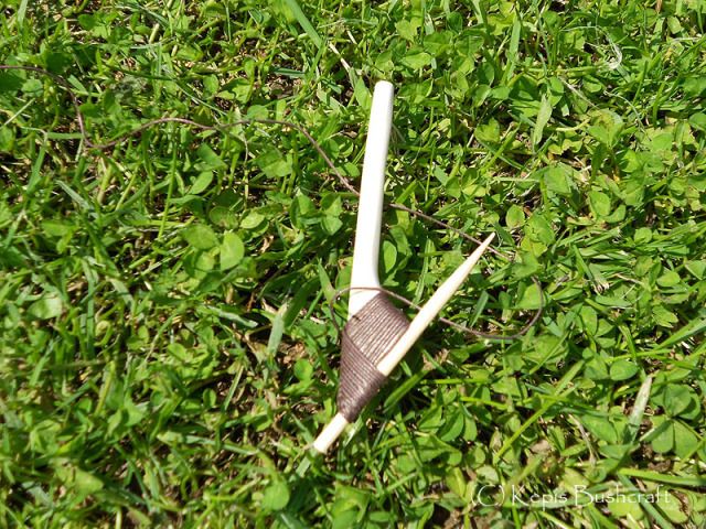

Per the request from Red, here's how to make a whipped fish hook

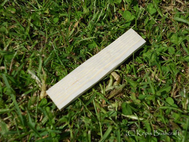

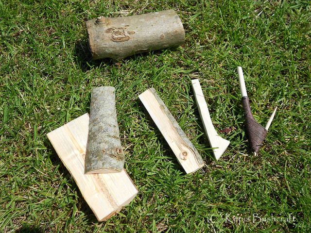

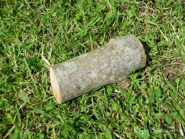

1 - Take a small log, approx 1" in diameter and 2" long, it helps if it's straight grained and splits easily, but not essential

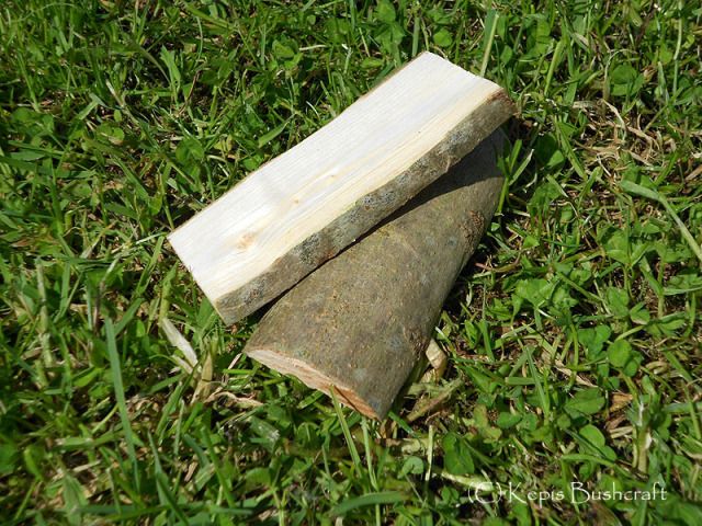

2 - Split the wood and make yourself a small plank approx 1/4" thick
3 - Split this in half

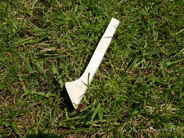

4 - and whittle it into this shape

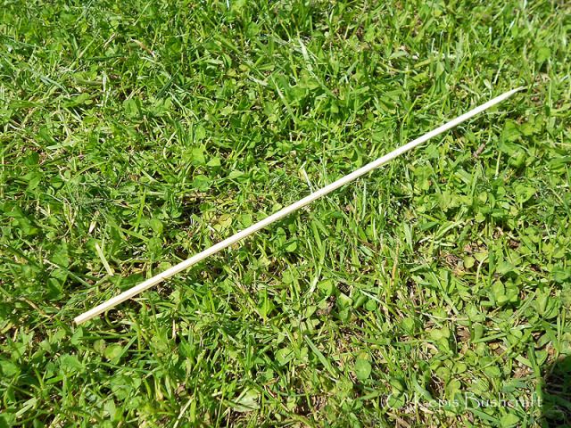

5 - select your barb, i used a bamboo skewer, but bone, thorns and a whole host of things also work
6 -figure out the length of barb you want and cut slightly over size, whittle the side that will face the shaft square for a better fit
7 - start to whip it over, i hope the photo shows the process, i tried to video it, but the hook was small and my hands are big, I'll try again if people want me to?, the whipping is a simple one and a study of the photo should show how it's done, as with whipping things in general, the beginning is the hardest part
8  - when you reach the top, whip up the shank and do a couple of tucks on the cord to secure
9 - a completed hook
and all the steps in one photo
hope this helps peeps?.

Kep, you lost me at the whipping part.   Are you doing a figure 8 type wrap or something?    Where is the starting point?   Are you weaving under a line at each come-around or something?
I'm sorry... I tried to study the pictures , but I'm lost... :(
Offline Kep
  • Posts: 472
    • Kepis Bushcraft
Re: Fish Hook
« Reply #6 on: May 22, 2012, 02:25:39 PM »
Here you go, found this on YT
