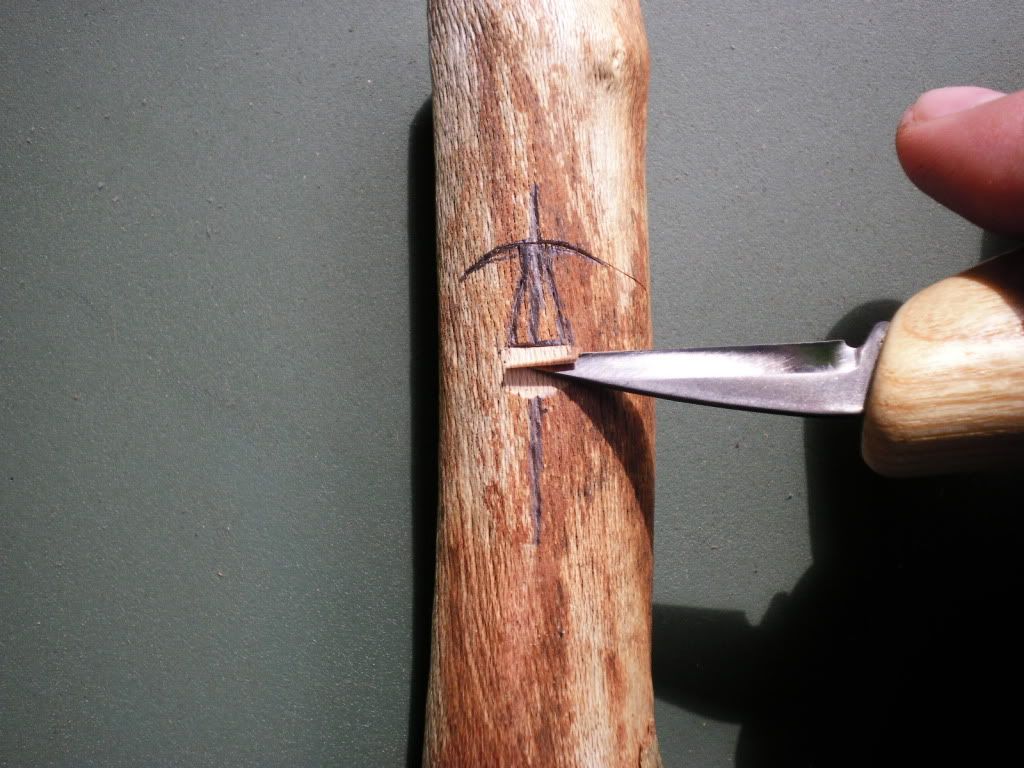

Get a good clean edge on your knife

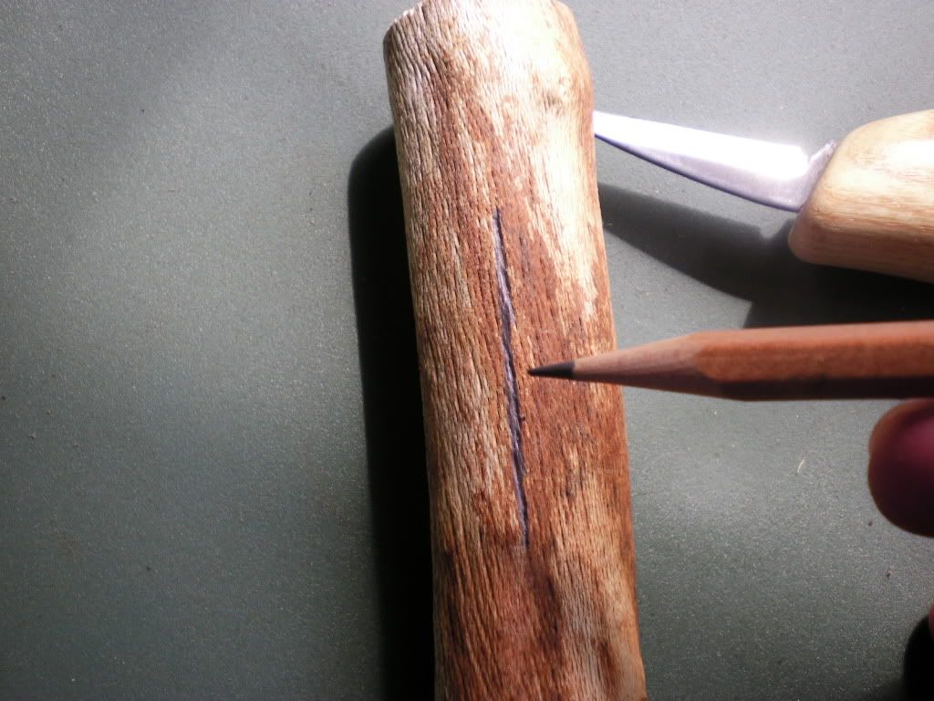

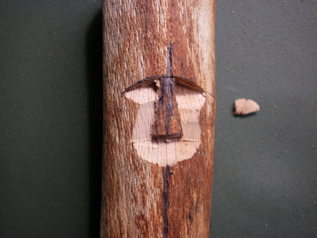

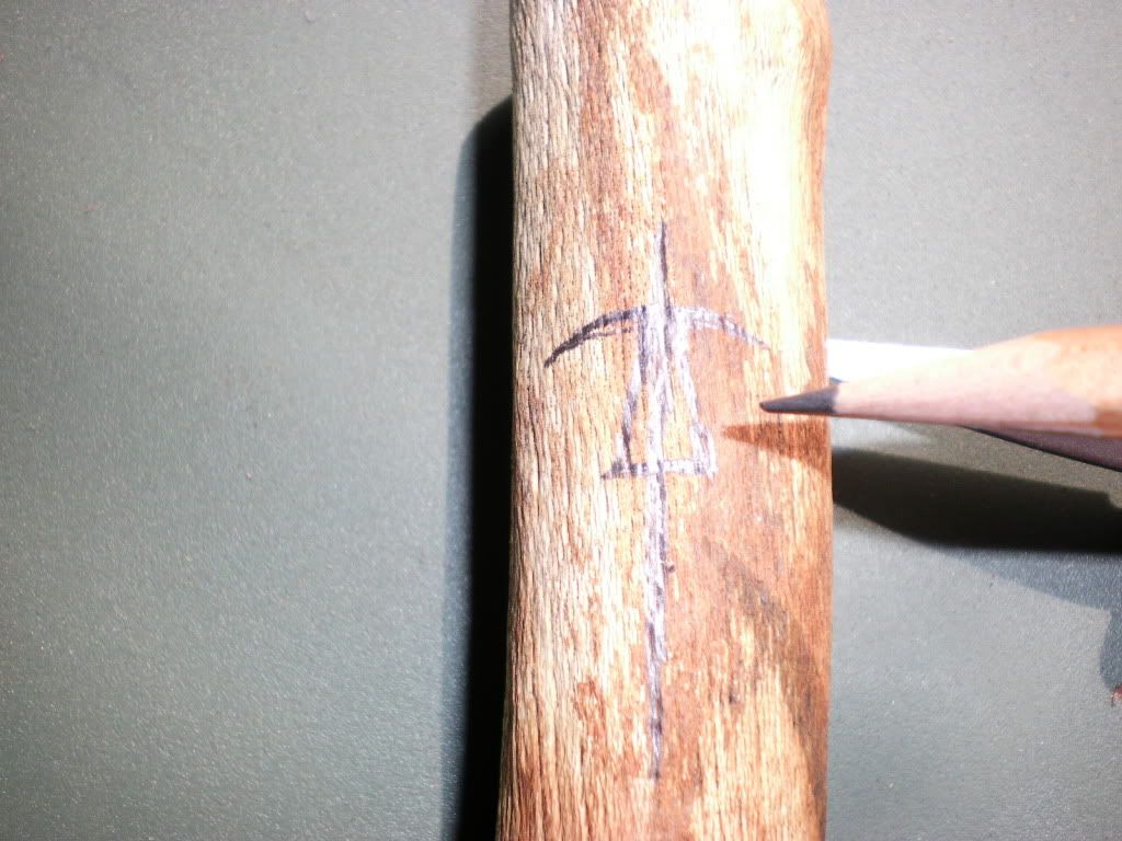

Mark a center line with your pencil

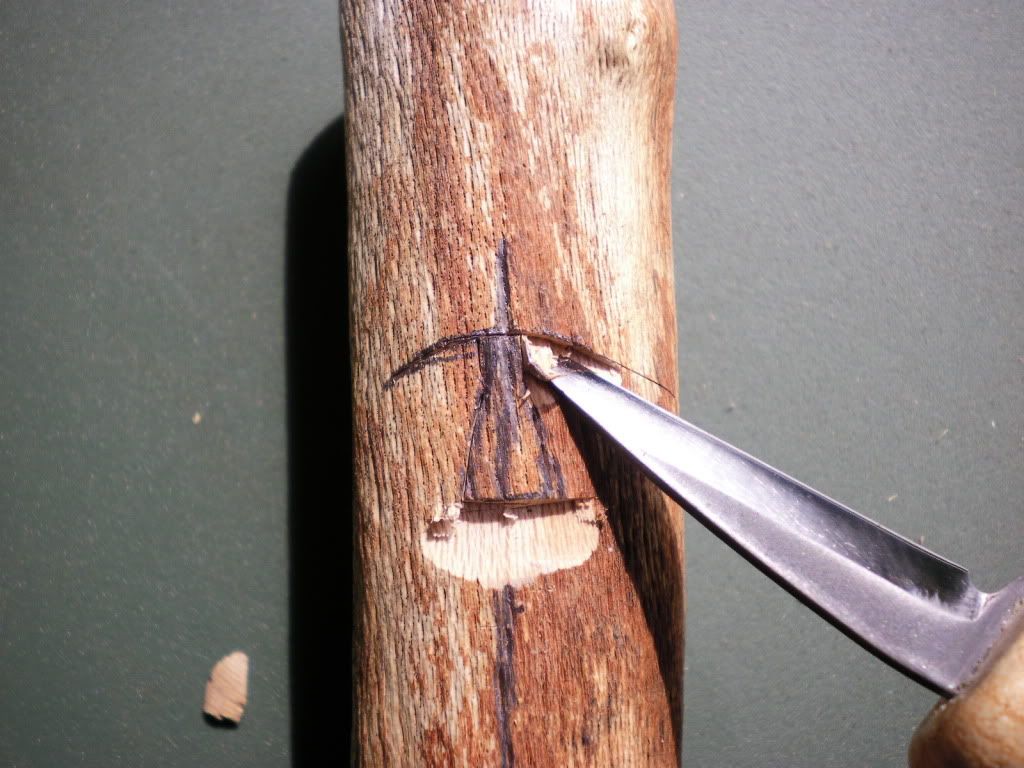

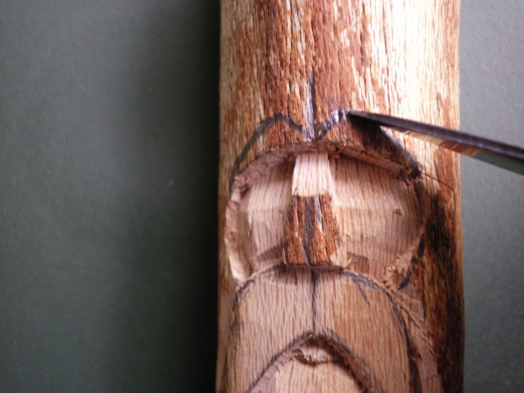

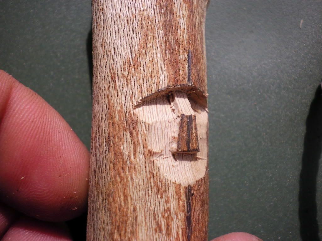

Draw the bottom of the eyebrow and rough shape of the nose.

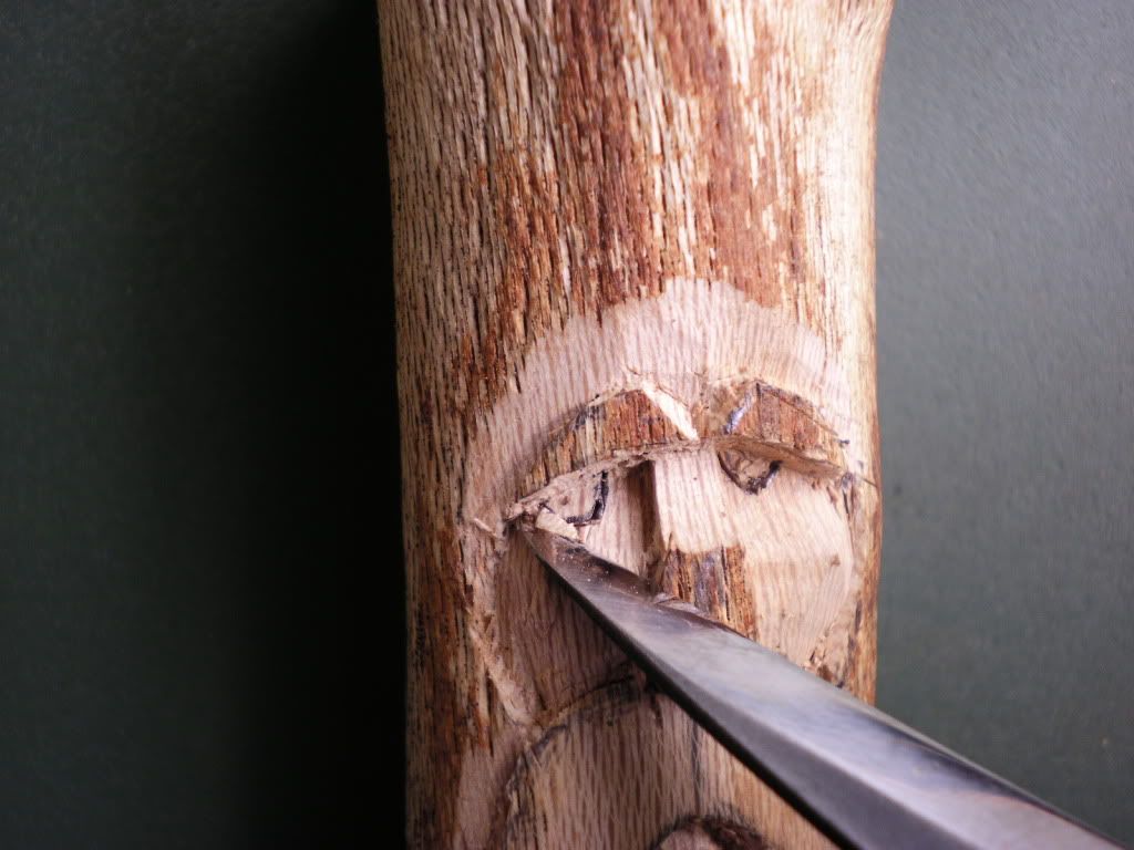

Make stop cuts along your lines.
Make slicing cuts back to your stop cuts.

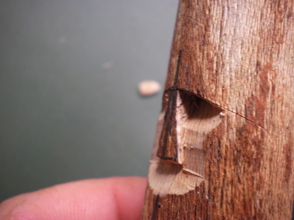

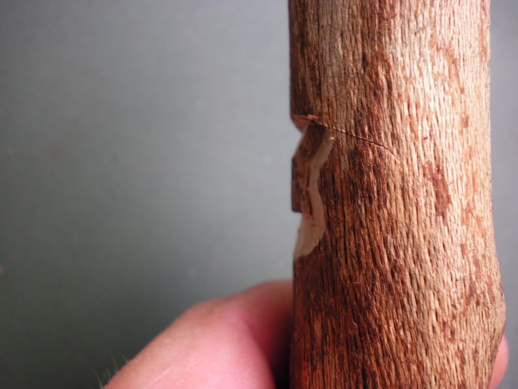

Start taking the eye sockets deeper. You may have to use a combination of stop cuts and slicing cuts to achieve this.
Set in the bridge of the nose with a slicing cut.

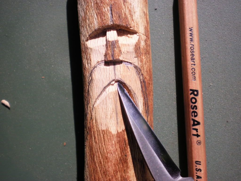

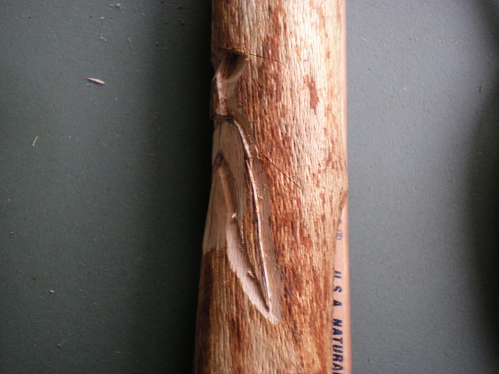

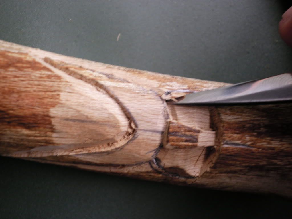

Now we will shave a bit of material off from under the nose.
Redraw your center line under the nose. You need this to help keep proportions straight.

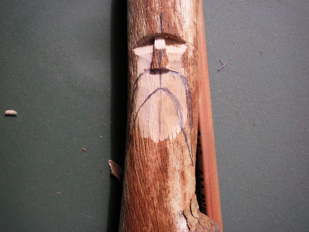

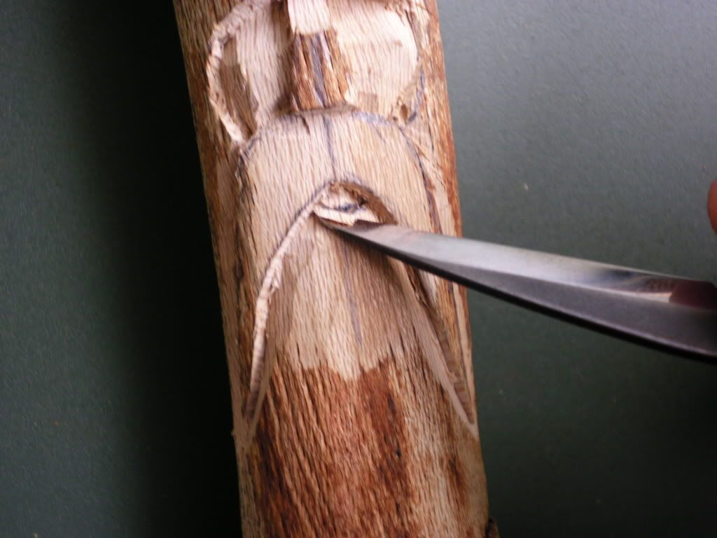

Draw the mustache.
Make stop cuts along your mustache lines.
Make slicing cuts back to you stop cuts in the mustache.

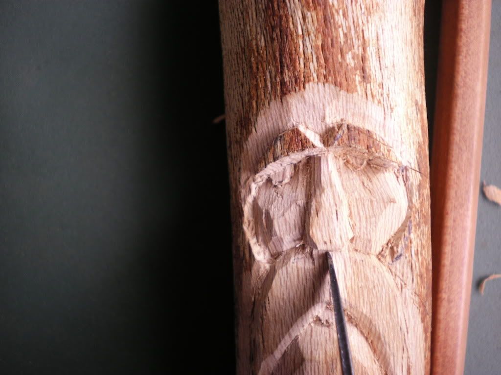

Part 2 of 6
Okay! Are you all ready for another round? Well strop that knife and let?s get busy.

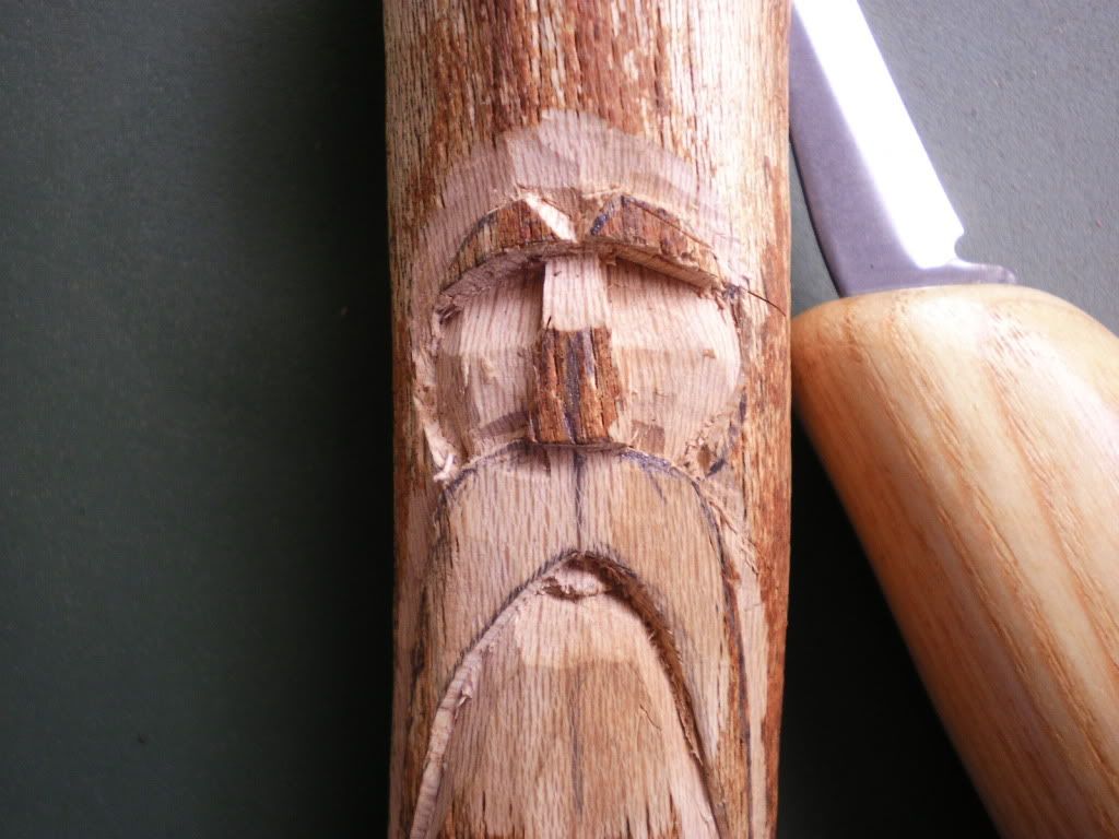

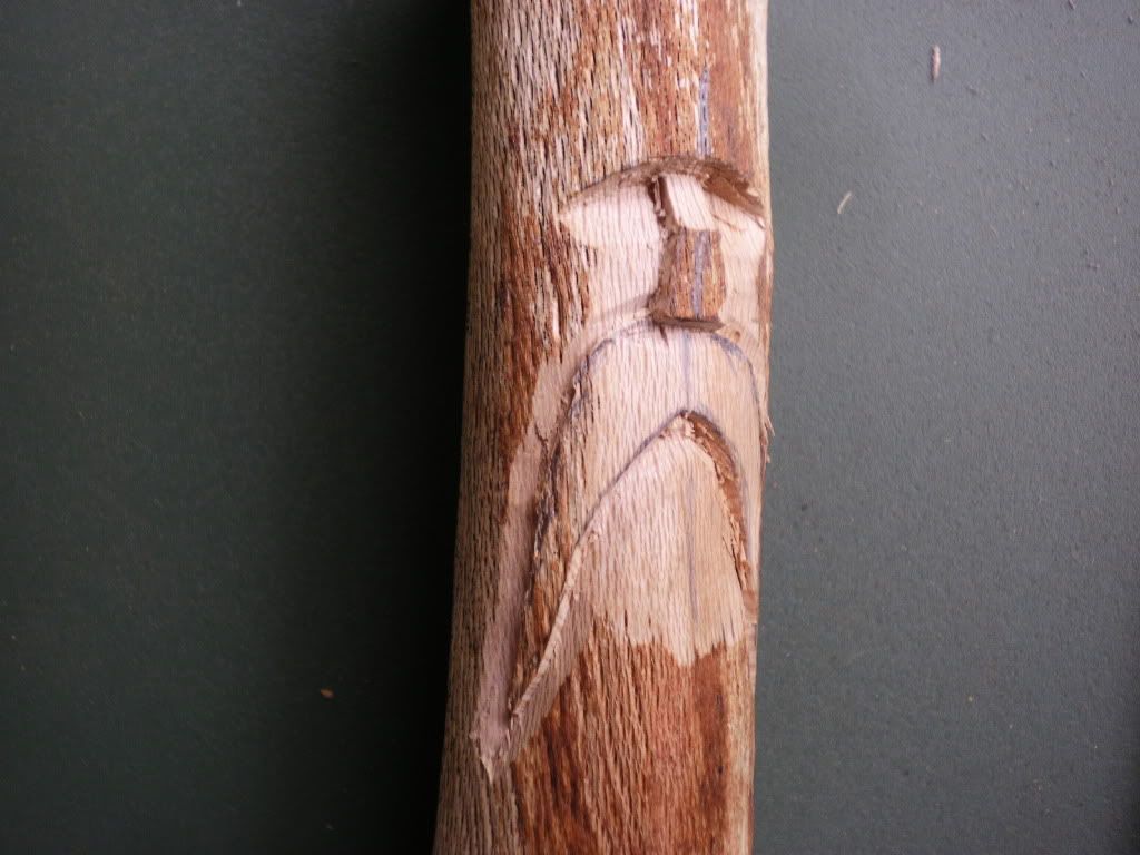

This is what our mustache should look like after finishing the slicing cuts in the last segment.

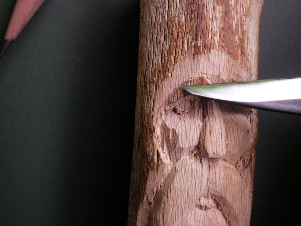

Draw the lines defining the cheek area.
Make stop cuts along the lines.
Make slicing cuts across the face to the stop cuts.
Our face should look something like this now.

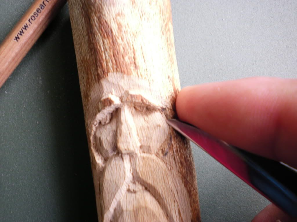

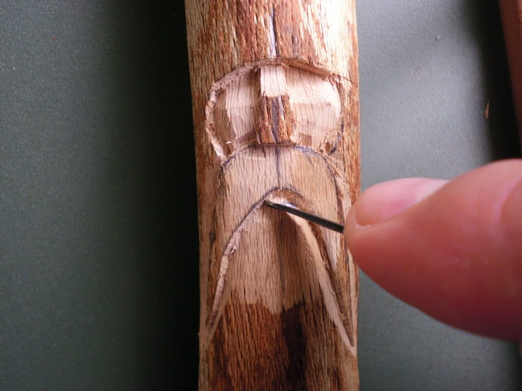

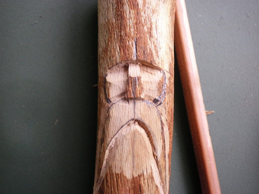

Draw in the bottom lip.
Make a stop cut along the lip line.
Make a slicing cut to the stop cut along the lip.
Our face should look like this now.

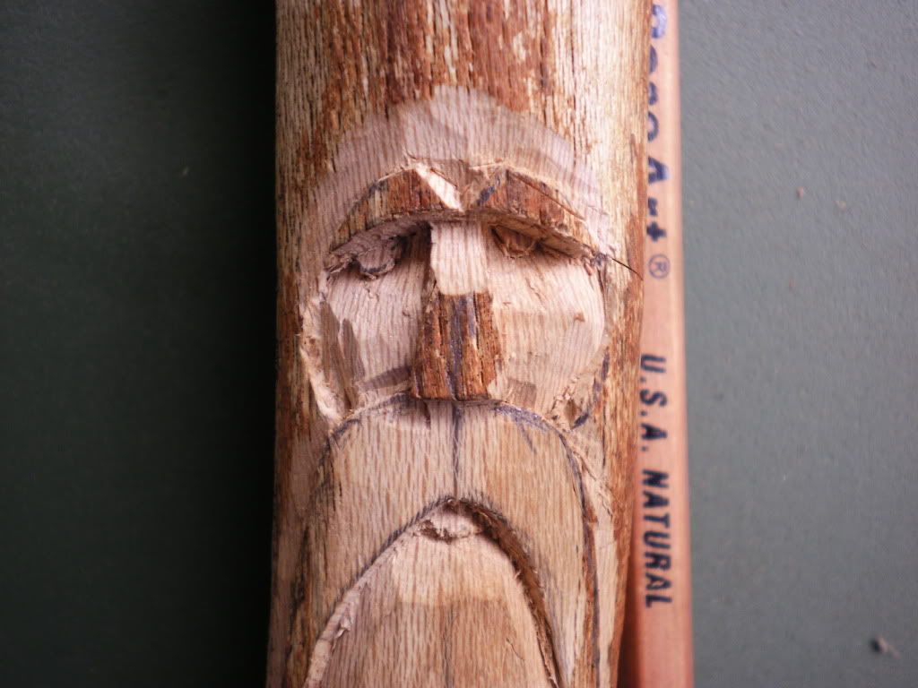

Next up we draw in the eyebrows.
Make stop cuts along the eyebrow lines.
Make slicing cuts to define the eyebrows.

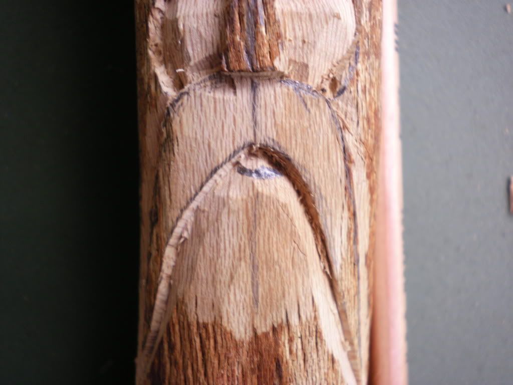

Our Spirit should look something like this now.

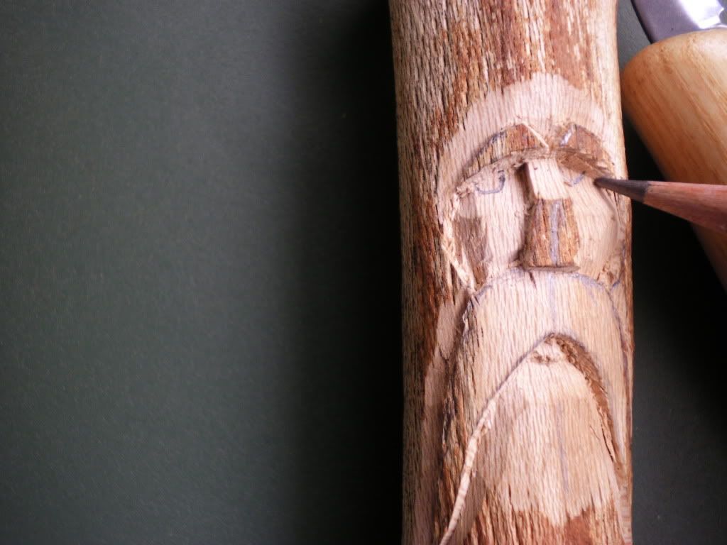

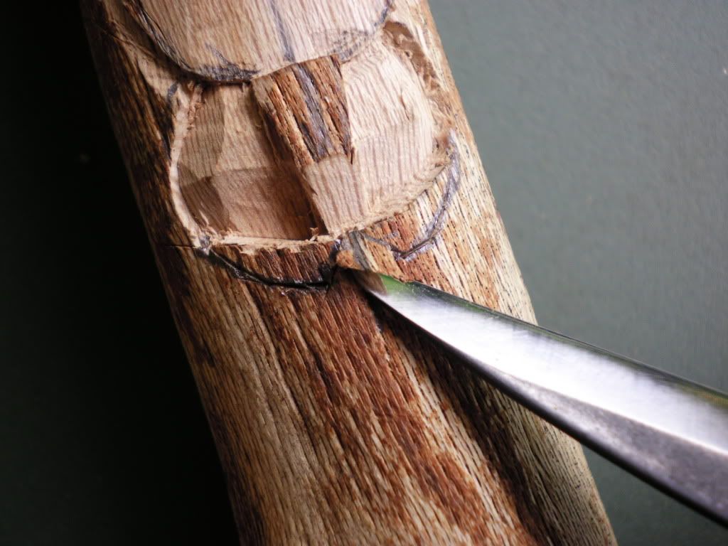

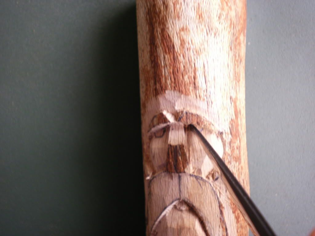

Draw in the eyes.
Make slicing cuts to bring out the eyes. This is where a real pointy knife comes in handy, but with manipulation you can do it!
Now we should look a bit like this.

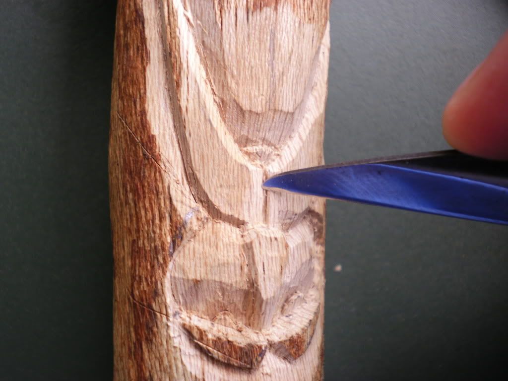

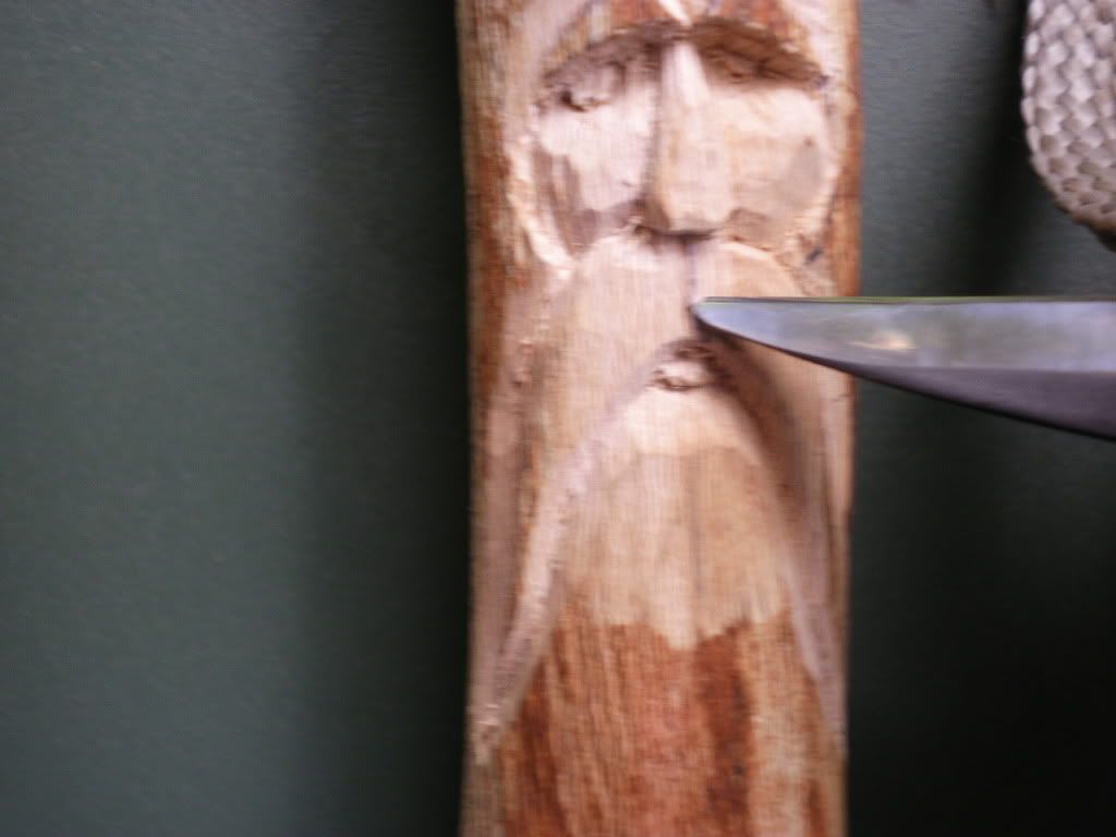

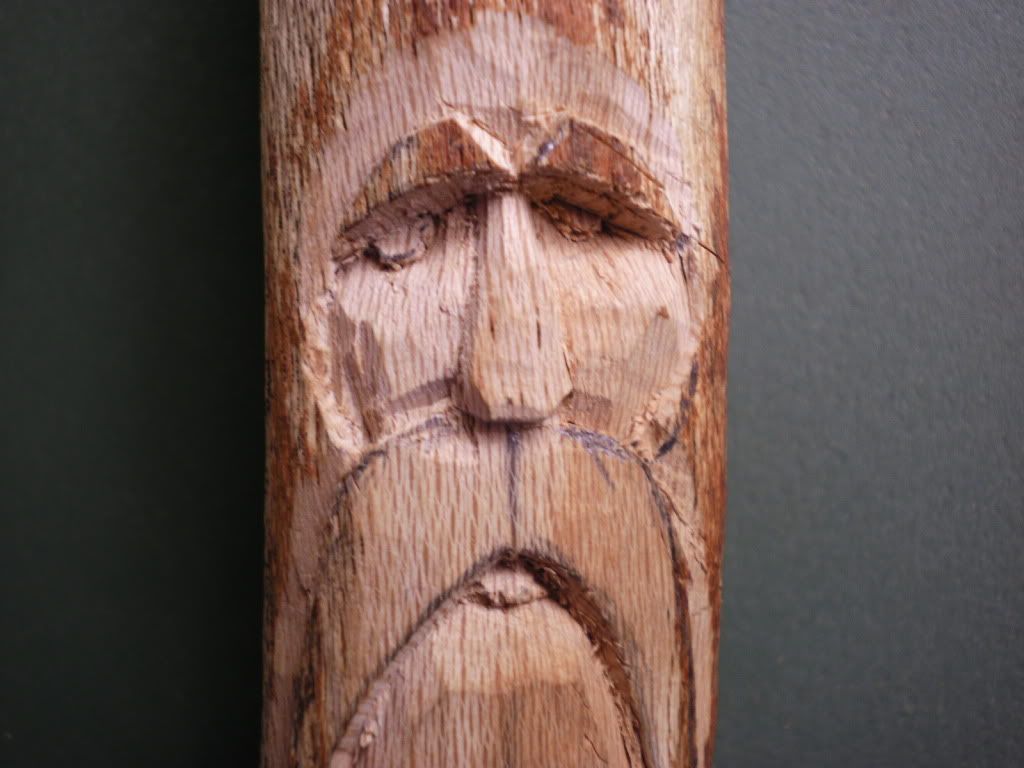

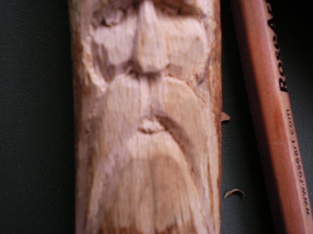

Make slicing cuts along the nose to "round" it off.
The nose should look something like this now.
Make slicing cuts along the mustache to "round" it.
And our face now.
Make a stop cut along the mustache center line.
Make slicing cuts along both side of the center line.
Our face should look something like this.

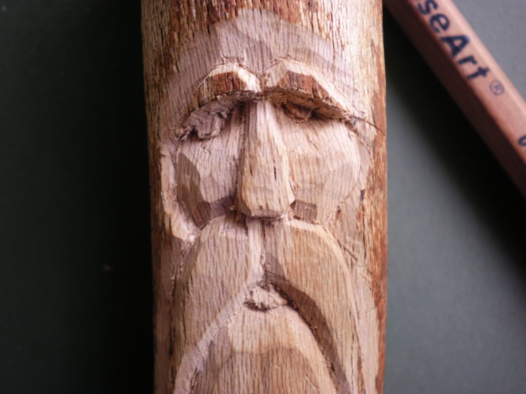

Now we need to make some slicing cuts along the eyebrows to "round" them.
What he looks like now.
Next, are slicing cuts along the cheek lines to "round" them.
Now our fellow looks like this.

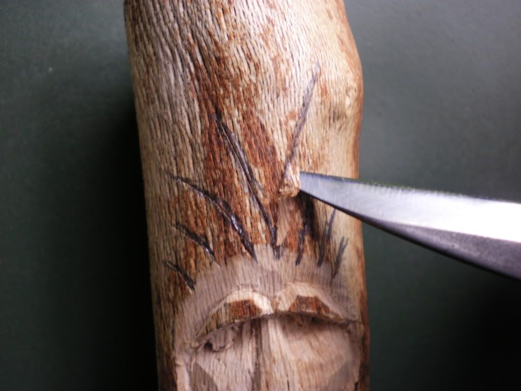

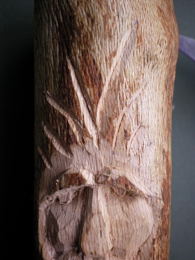

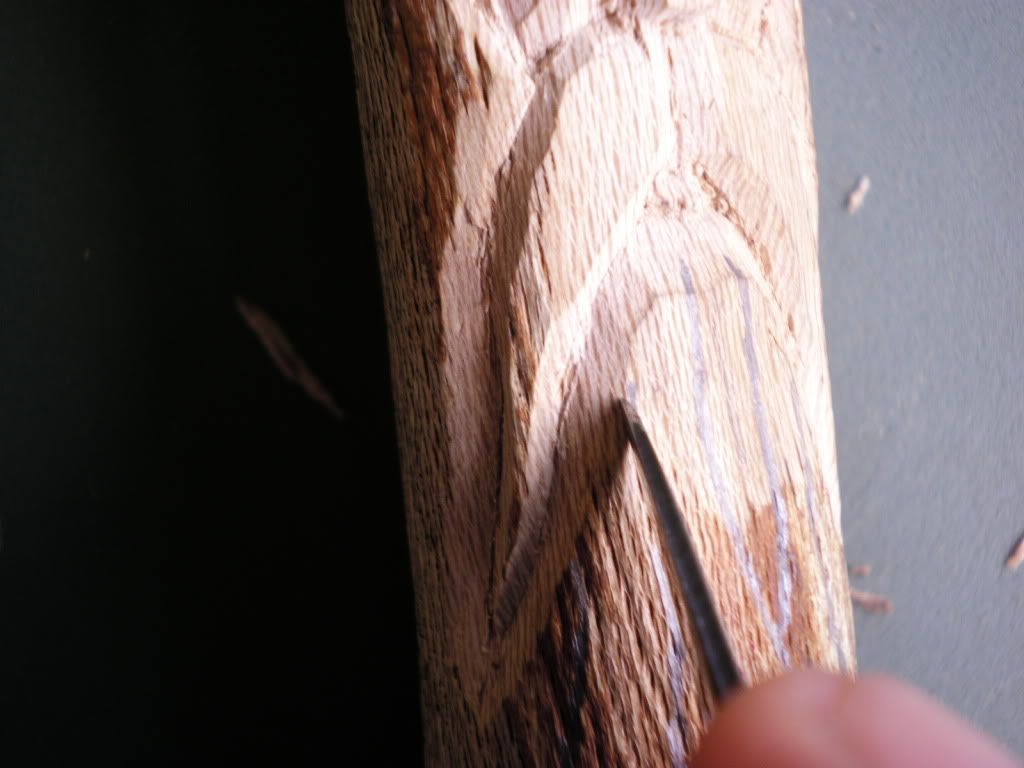

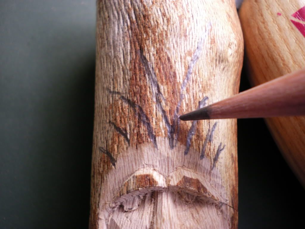

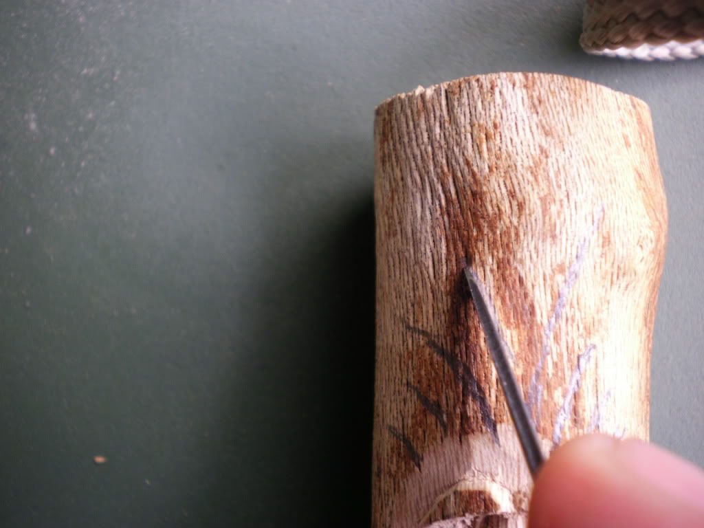

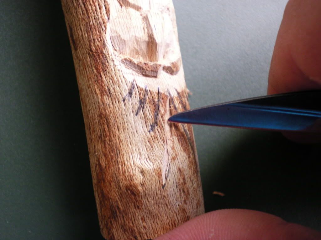

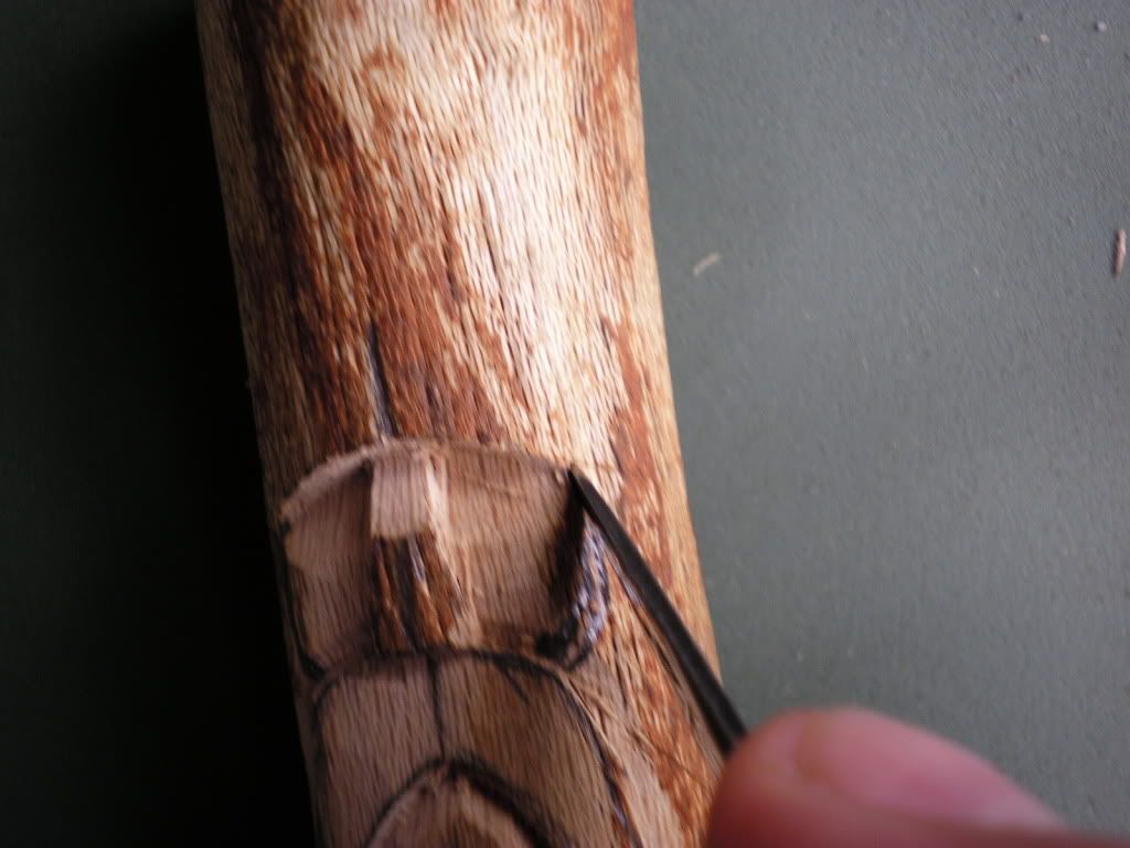

Now we need to give our fellow some hair. Draw in a few lines to give a hint of head hair.
Make stop cuts on your hair lines.
Make slicing cuts on both side of your lines to create a "V".
Our fellows new hairdo.

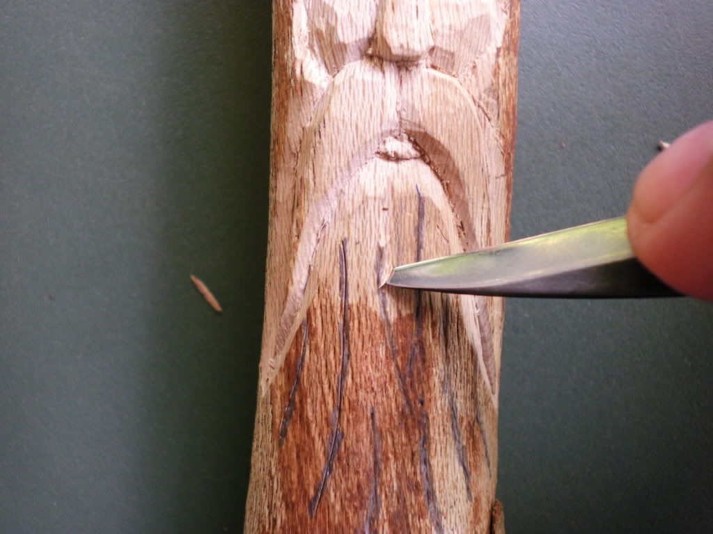

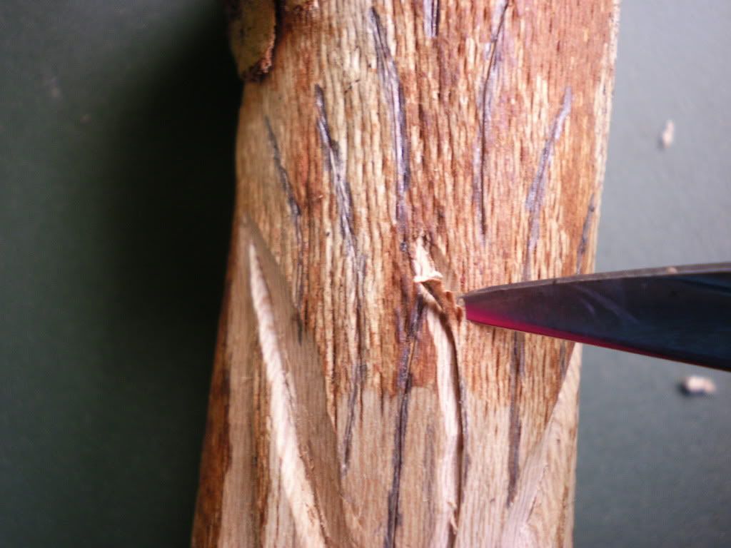

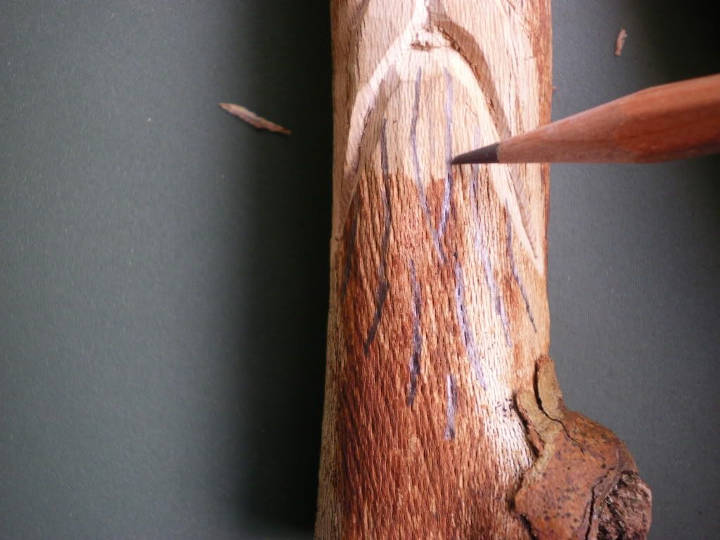

Now we want to give him an indication of a beard. Draw in a few curved lines.
Make slicing cuts on both sides of your lines to create a "V".
How our beard should kind of look now.
