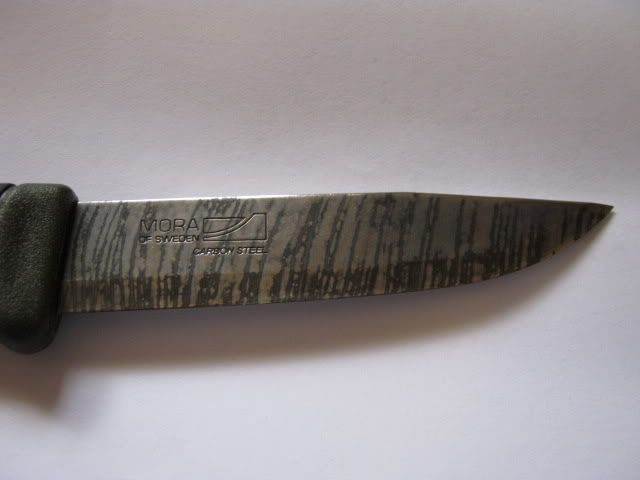

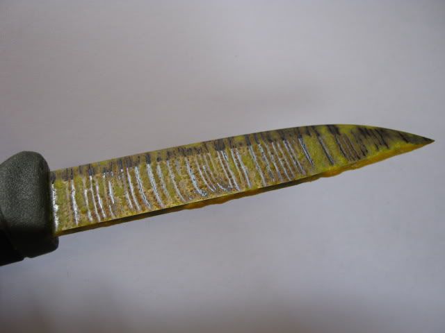

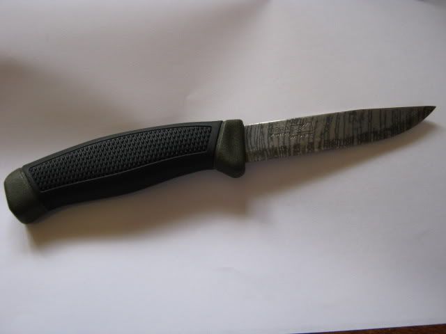

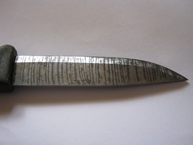

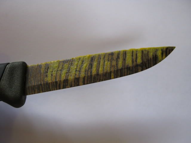

Most of you probably already know all about this, but for those who don't...
This is a nice way to get a striped patina on a carbon steel blade. First, make sure the blade is very clean. you can wipe it with alcohol first.
Then using a silicone basting brush (the kind with silicone "noodles" for bristles), bush on a very thin coat of yellow mustard. If the coat is too thick, you will not get a good patina. The coat needs to be thins so that oxygen can react with the steel and the acids in the mustard.
As you can see from the photos, the dark portions are where the mustard was thinnest, and the light portions are where it was thickest.
It makes a nice striped effect that seems to be fairly durable even after the blade has been used to split wood. Eventually, a natural patina will take over and obscure the stripes. If you mess up, you can use some metal polish to remove the patina and then clean all traces of the polish off and try again.

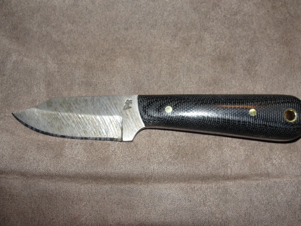

« Reply #5 on: March 30, 2012, 09:52:28 AM »

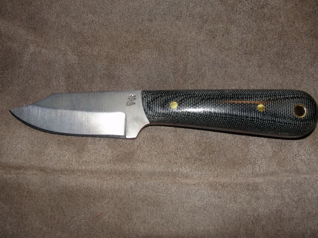

I have this little BHK Frontier Trapper.  I got an uneven natural patina on it from cleaning out some pheasants a while ago from the natural acidity in the bird blood etc.  (You can't notice it too much in the picture.)  I decided to force a patina on it with mustard and a basting brush.  Here are my before and after shots of it.
« Last Edit: March 30, 2012, 09:54:12 AM by MATT CHAOS »
Re: Mustard Patina
« Reply #6 on: March 30, 2012, 11:02:16 AM »
Looks nice, those basting brushes really make the stripes work well.
Re: Mustard Patina
« Reply #7 on: March 30, 2012, 11:11:37 AM »
Thanks.  As you can probably tell, I did not leave the mustard on very long, hence the light patina.  I am debating about giving it a second dose of mustard and leaving it on a lot longer.
Re: Mustard Patina
« Reply #8 on: March 30, 2012, 11:15:01 AM »
It is a little light. If you go for it a second time, remember thin is the key so oxygen can react with the steel. And the appearance of a little rust is normal, it will turn black as you scrub the mustard off in the sink.
