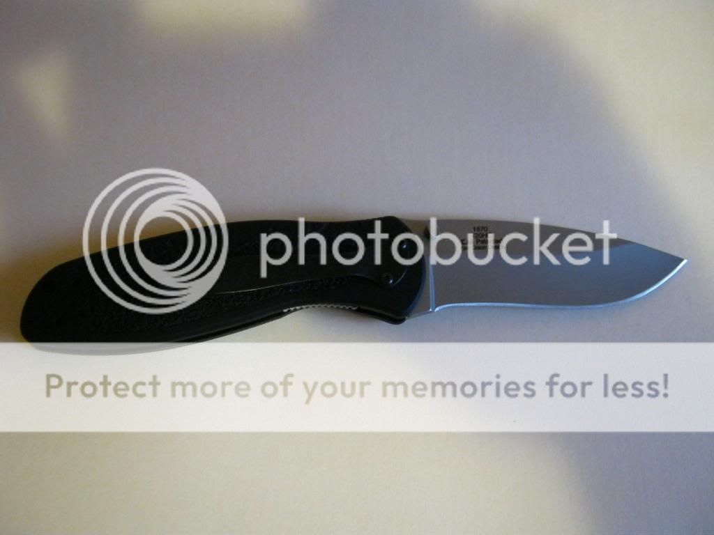

This picture was taken indoors with the blinds closed, using artificial light. You can see the shadow of my arms holding the camera, and the detail in the handle is lost in the dark.
This next picture is in the same location, using the camera's flash. Not much better. Camera flashes are for taking pictures of your friends in dark bars and nightclubs.
There are some instances where a flash can be useful in taking pictures of knives as a way to supplement existing, adequate lighting. But in the image below, flash isn't helping anything.
This image was taken on the same background, outdoors on an overcast day. you can see the lighting is much more even. There are no shadows, and the colors are reproduced very well. More detail would be visible in the handle if the image were made on a slightly brighter day.

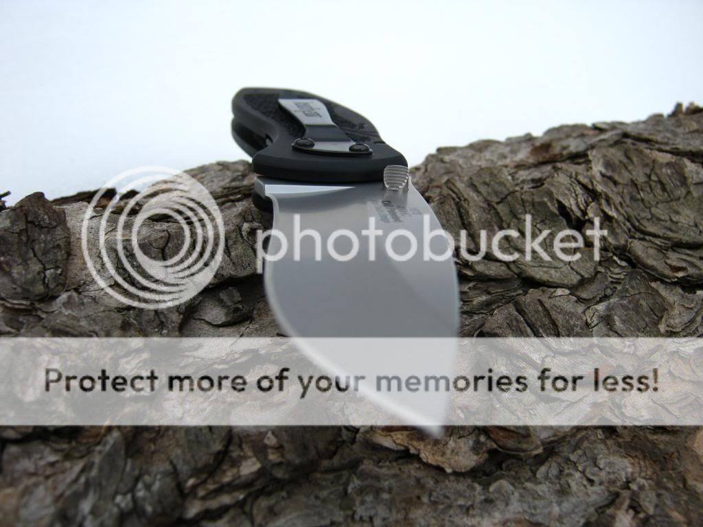

So here are a couple of examples of depth of field manipulation. In both pictures I attempted to focus on the thumb stud of the knife since it is about halfway down the knife. Autofocus likes something with texture to focus on. Often when you use it, it will not focus on a plain solid color object. after I locked in the focus I recomposed and took the shot. However since I was close to the knife and had the lens zoom backed out as wide as possible, some of my image was blurred and out of focus. Notice the tip of the knife, and the pommel? Blurry.
By taking a step back and zooming in until the frame was close to the previous picture, this is the result. Still not perfect, but much more of the knife is in focus now. This image has more depth of field. If I had a tripod instead of hand holding the camera, I could have chosen a smaller aperture and a longer exposure, and squeezed even more depth of field out of it and gotten the entire knife in sharp focus.
