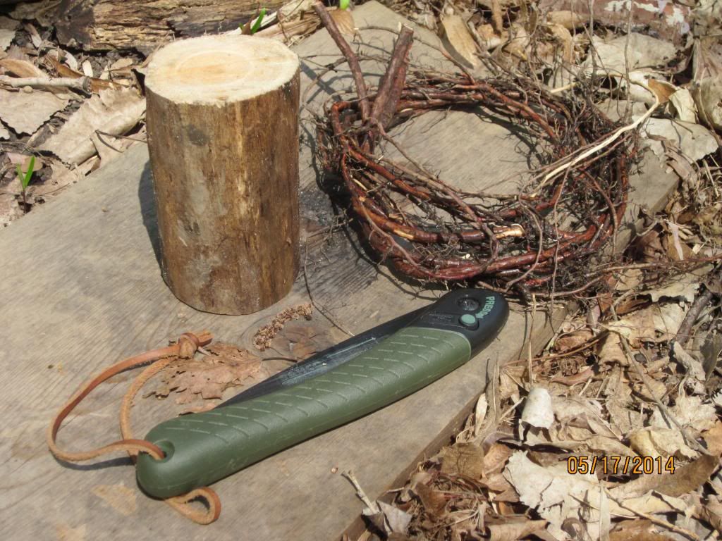

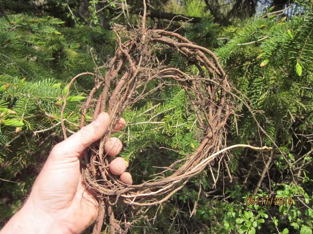

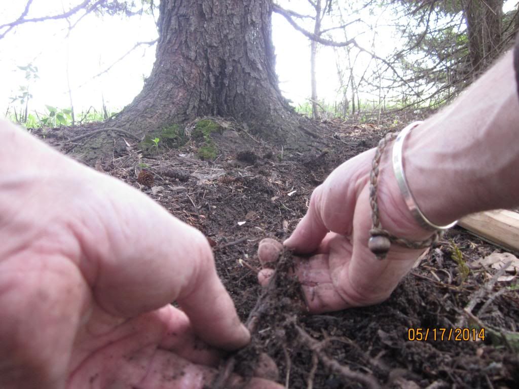

I started out by collecting some Spruce roots which can be harvested just a couple of centimeters below the soil.
Spruce roots are an exceptionally strong natural cordage.
Using my Bahco Laplander saw I cut a piece of straight grain Willow, I chose Willow because its abundant and easy to carve.

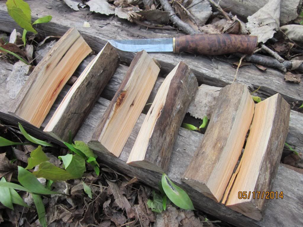

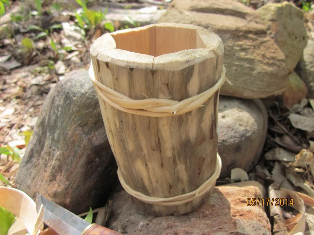

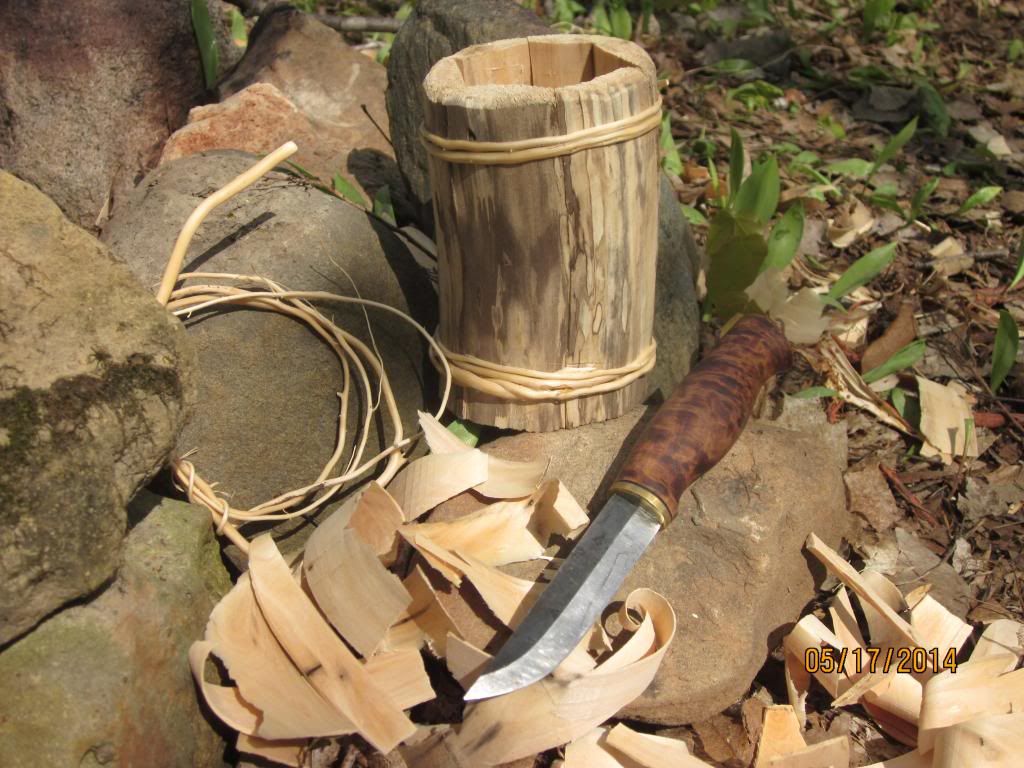

I battoned the chunk of Willow with my Puukko...
I cut the chunk into 6 somewhat equal sections.  Make a note here; it is imperative to keep these pieces in order as you cut them because they have to go back together and the seal depends upon these pieces matching up!

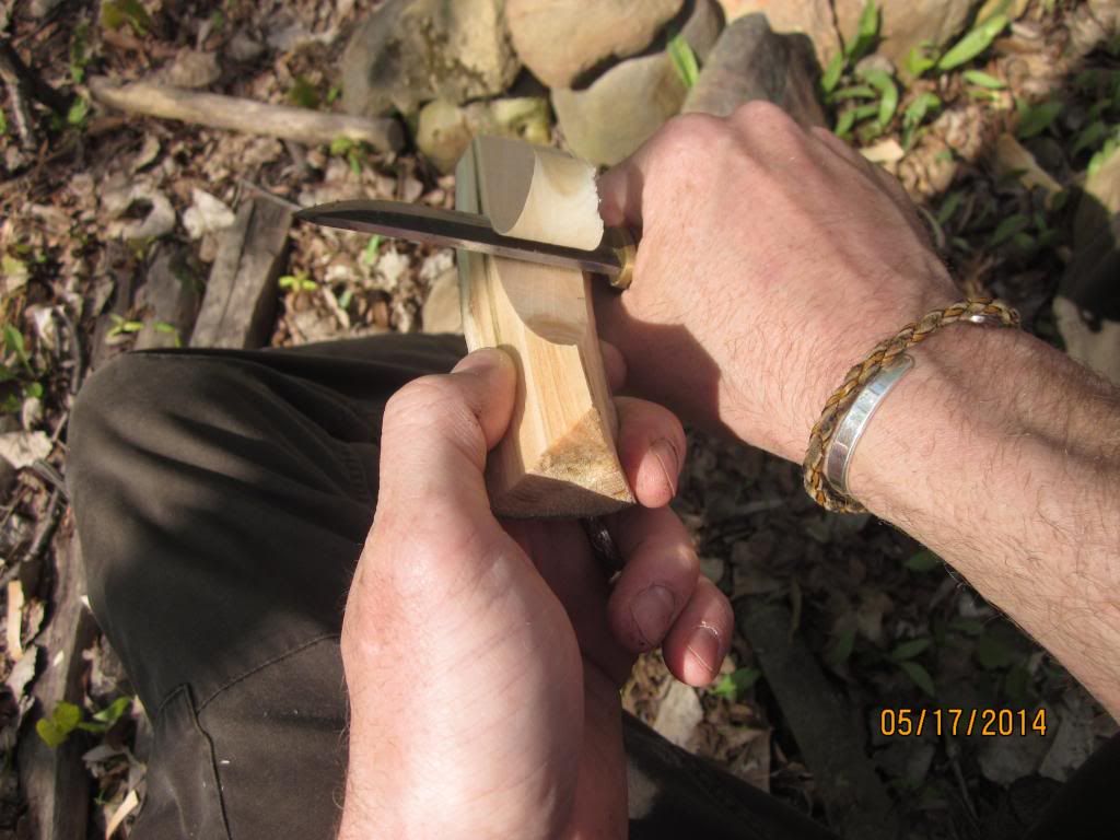

I begin to remove material on each of the 6 pieces to create the cavity for the cup.
Next I bigin to prepare the Spruce roots by removing the outer skin.
The Spruce roots are a bit too thick so I decided to split "em.

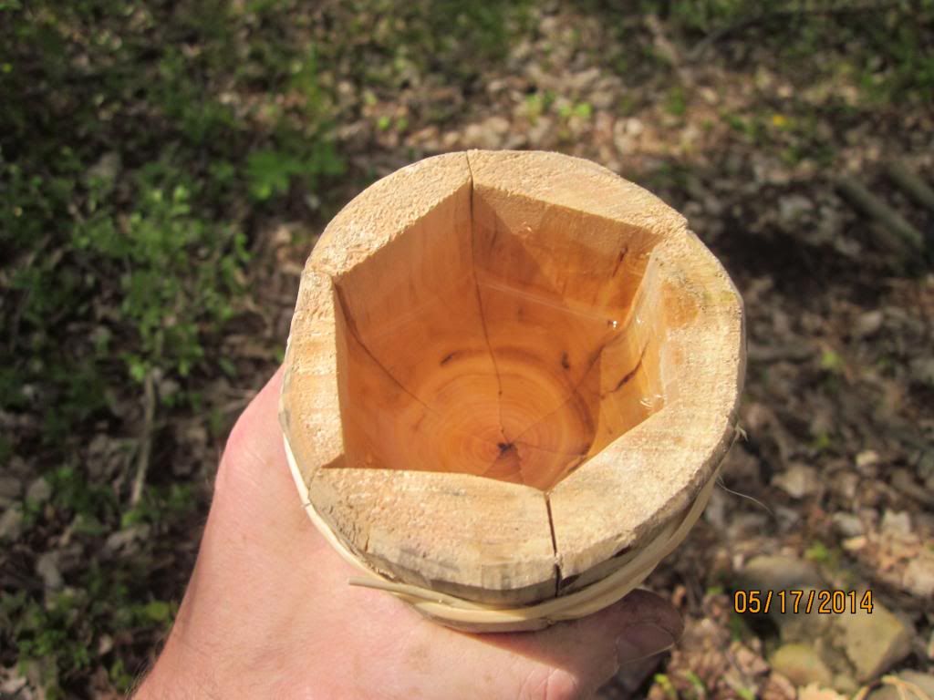

This next part can be a bit tricky, I lined up all the pieces making sure they fit tightly together then wrapping the Spruce roots around the cup I tucked the end underneath the wrap to secure it.
I filled it up with water to see if it sealed properly, it did have a small leak...    :'(  Not a problem it'll seal itself as the wood swells!   :)   I could use some Spruce pitch if this was vessel for long term use.
It does the trick!
It's a bit crude I could have evened the inside, maybe made the walls a bit thinner but it did the trick.
This was a fun little project and is a lot easier/faster than carving a Kuksa!  Next time your out in the woods and you forgot to pack your coffee cup give this a try!   ;)
