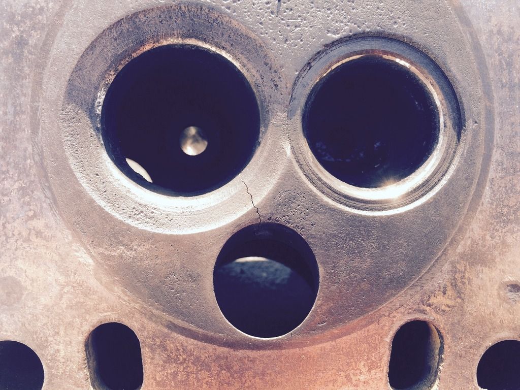

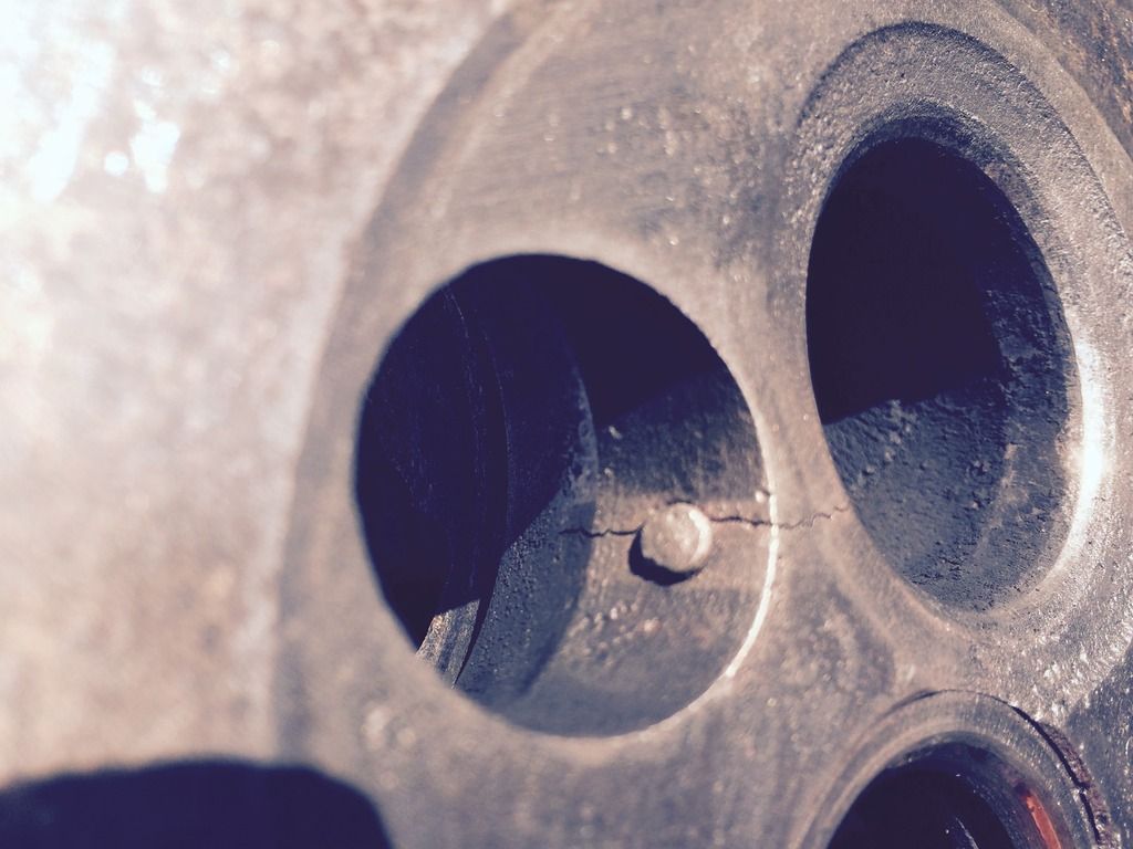

So, While cleaning the head I found a crack. From the turbulent chamber to the intake valve seat. On all four cylinders.
I happened to find one on e-bay and cut a deal for $600. My company is going to have a driver swing by and pick it up for me. No shipping.
A re manufactured head would have been $1500+ a $500 core charge. If this head has something wrong with it I'll be going down that road...
I took the fuel injectors to get checked whether or not they were working correctly. They were not. They rebuilt all four of them with spare used parts they had, ( all discontinued ) They didn't ask me if I wanted them rebuilt. Then wanted $75 each. I put up a fuss. A bad head cracked and unrepairable what good are new injectors ? Now I paid $85 which was the cost of testing. I didn't know I was going to fix or scrap this at that point. Still don't really. It could have so many other issues hidden.
I'll give it my best. I hope to get at least 5 years out of it before it totally dies.
