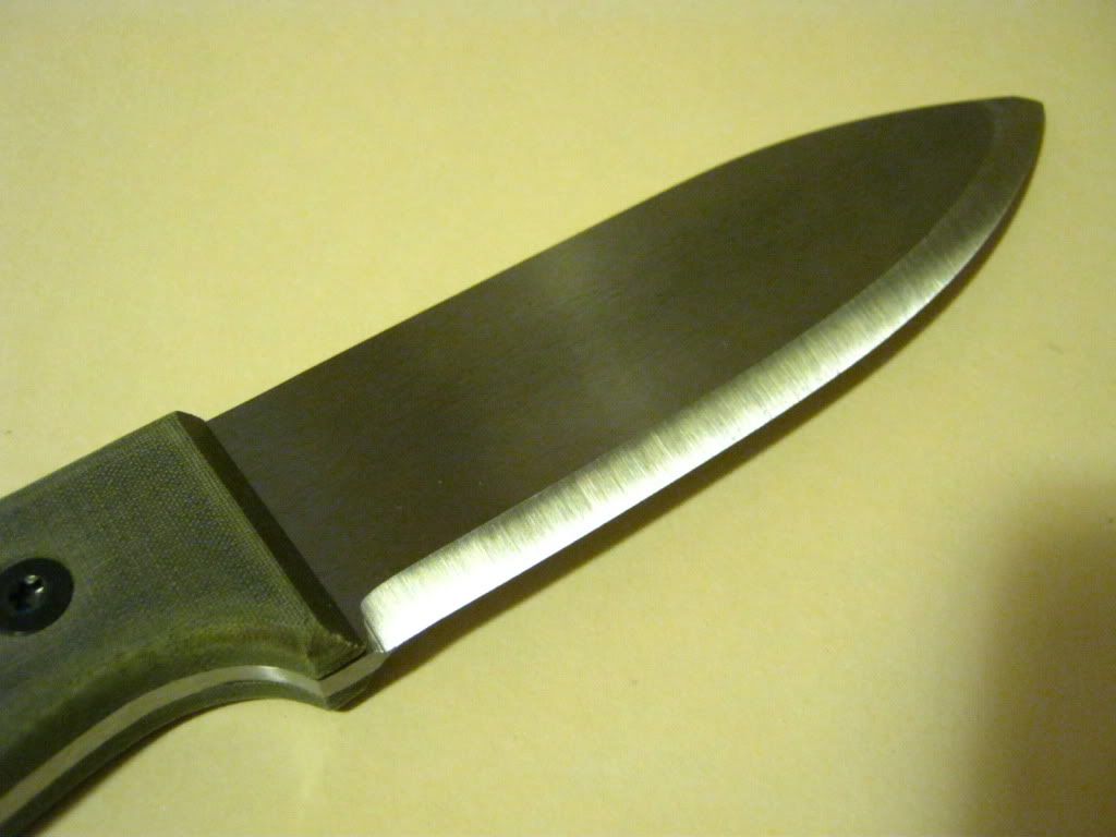

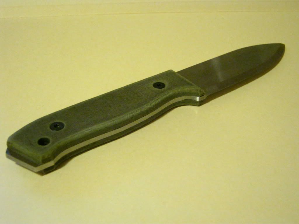

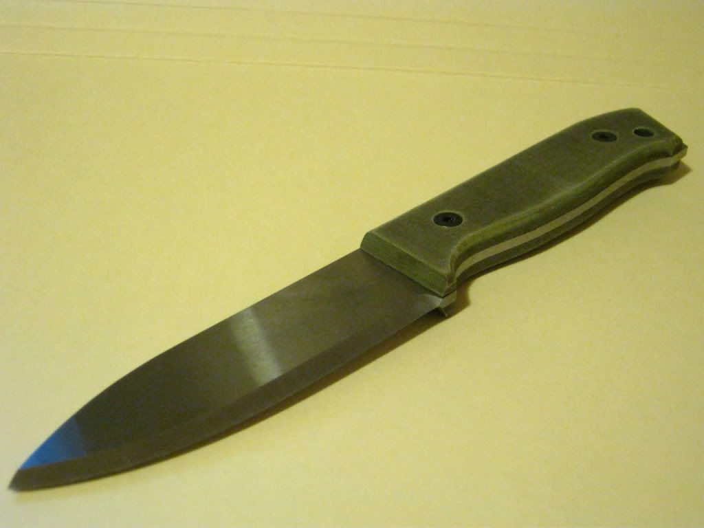

Ok, I got a little more progress done in the shop.
This is a Scandi grind Intrepid knife. This is the same profile as the orange and black Intrepid I built. But it's got flat green linen micarta scales. I plan to leave the scales with a sanded finish instead of polishing them, for added grip. I've got a little tweaking to do here and there with some sandpaper and need to etch my logo. I expect to have the knife completed by tomorrow, and the sheath as soon as time allows. I'll also get some beauty shots up when the knife is finished, and more when the sheath is completed.
This knife is made from 1/8" thick O1, so it's thinner than the orange Intrepid, but the scandi grind leaves plenty of meat on the blade for strength.

looks GREAT man!! good job on that :D

« Reply #53 on: March 17, 2012, 10:06:53 AM »
how wide is that blade from edge to spine PW?
  • Posts: 11370
Re: TOKT News
« Reply #54 on: March 17, 2012, 10:13:49 AM »
I made it from inch and a quarter stock, so just a hair less than that after it's ground and finished.

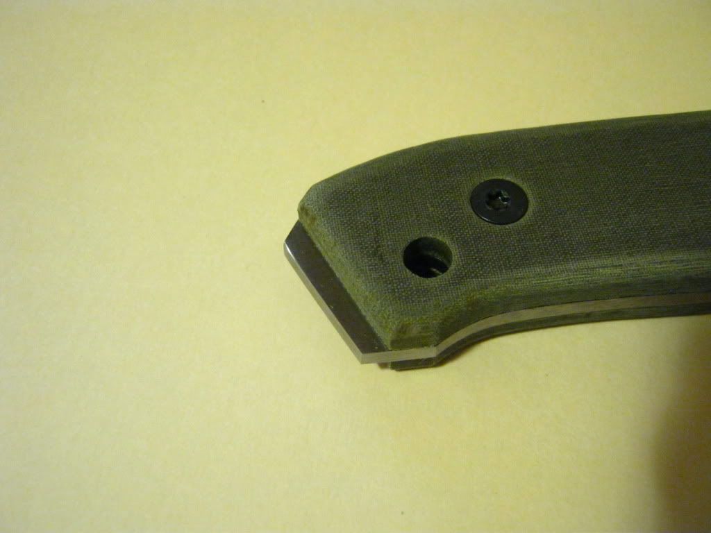

I have temporarily suspended orders until I get finished with my upcoming move, and can build a new workshop. However, I am completing a couple of existing orders.
This is a custom Kephart inspired blade. 1/8" O1 steel with a full flat grind. It's profiled and rough ground. It still needs heat treat, finish grind, and a handle put on. This is one of the thinnest blades I've ground so far, and it feels like it will be an outstanding slicer!
