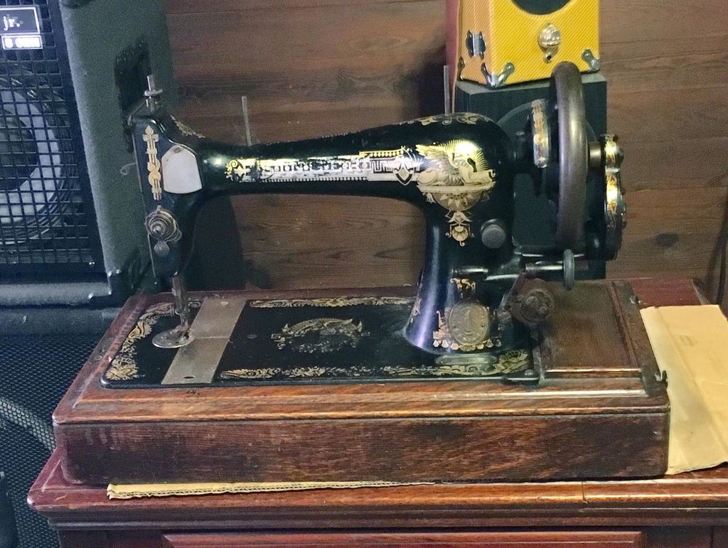

Sewing machines revisited;
A friend of mine, from time to time, is bringing me machines, older vintage singers. I pulled one out I hadn't looked at since she brought it to me about 3 months ago. It didn't have a motor, or wires and no lamp. The mounting bolt was on the machine. I wouldn't say it was abused, no rust or buildup of crud. It's smooth running and has been consistently maintained. I took a modern, made in China, hand crank off a post WII Japanese copy of the Singer 15 and put it on the machine to see how it runs.
It's a 128, which is a 3/4 size vibrating shuttle machine, it was built in 1919. The modern hook and loop is a rotary design, honestly I can't see it's advantage. It may have something to do with various stitching patterns or the reverse stitch function, I don't know but I really like the vibrating shuttle on these old singers.
There is not a machine ever made that makes a better looking straight stitch.

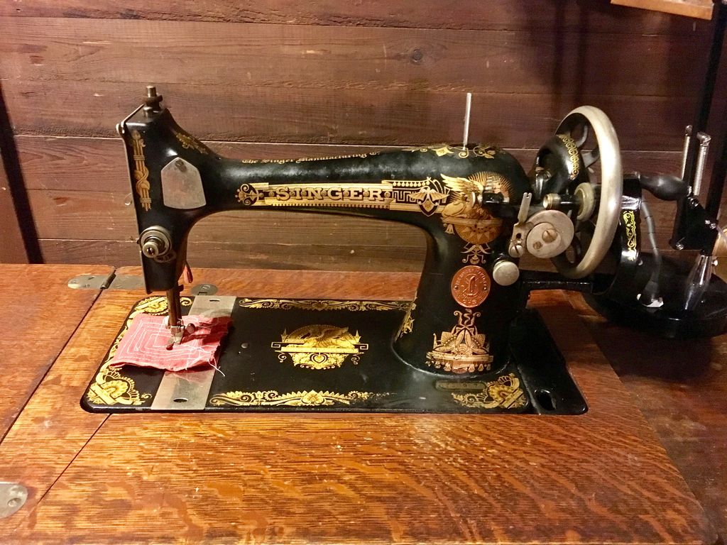

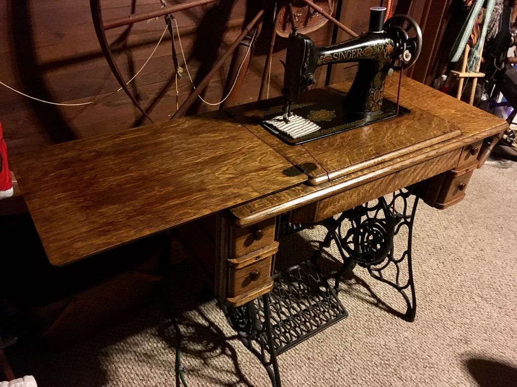

Got it home, serviced it, took some of the slop out of the leather drive belt, it's a bit dry, it cracked a bit when I punched a hole in it for the staple. I ordered a new one.
The machine is perfect and it's just slightly better than I thought it would be, very close, I drove to St. Augustine to pick it up. It turns out the guy she got it from is a partner of one of my neighbors. They started a company called Salt Life about 20 or so years ago.
The machine head
The cabinet/treadle
  • Posts: 18265
Re: SEWING MACHINES
« Reply #14 on: April 08, 2017, 07:15:26 PM »
HOLY COW.....that thing looks brand spankin' NEW!  :shocked:     The paint on the treadle doesn't look like it's even begun to wear off yet. :thumbsup:

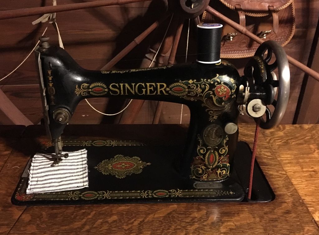

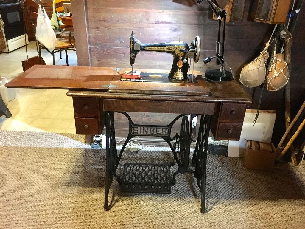

Since the I found the Singer 15K in the treadle base I've come across 4 more machines, only one of them is not a vibrating shuttle, it's an early Singer 66, without a reverse drive, it also came with the treadle cabinet. This machine is in really great shape, the cabinet is one of the nicest I've seen, I found it in Jacksonville via Craigs List. It was $5.00 more than the last one. I had a spare drive band and installed it the other day
The machine head;
The cabinet
