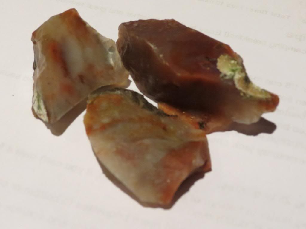

I'm going to have to post a pic of some rocks I collected at a specific area and if I can find the coordinates I'll post those as well. I've been calling them chalcedony but I might be misidentifying them.

These work very well for striking sparks, but do not flake easily, however I have found a piece at the deposit that appears to have been pressure flaked. As you can see, these were broken up long ago, they have some lichen growing on them in places.
This deposit was about a 2 hour drive from me. It was a slight depression in the land where they were strewn about everywhere in an area about the size of 2 football fields. A professor at the local college who also works at the prehistoric museum in the paleontology dept. (and from who I took a gem cutting class a few years ago) directed me there. I think I asked him where I could find "chert" at the time.

They look like chalcedony from this angle, PW.  I'm sure they are.
In these photos, the red rock is jasper from the northwest end of Glendo Reservoir and the other is a piece of chalcedony I collected locally.  Note how the jasper has a dull appearance and the chalcedony is waxy-looking.
I wanted to use better examples in the photos, but my rock specimens are buried under a couple of feet of snow.  >:(
I'm going to post something of interest in the Utah board in a little bit for you to check out.

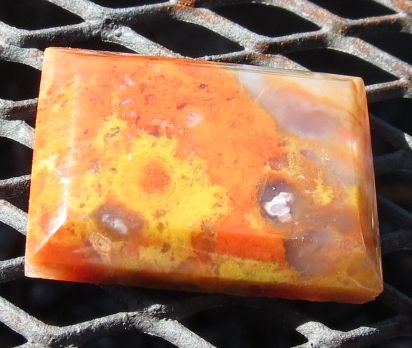

Ok, I'm pretty sure this was collected at the same location, though I didn't collect it myself. I did polish it though.

Definitely chalcedony, looks textbook.  Nice polish - it shined up like a new penny!
Wow, that's beautiful 8)
Nice post Half Axe, thanks :thumbsup:
