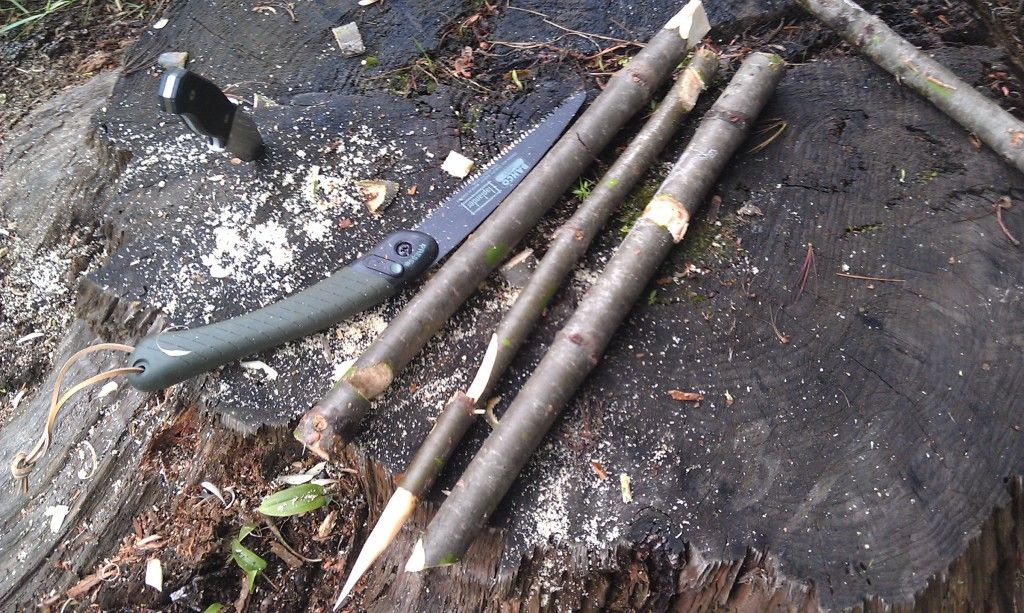

Here is mine. The figure 4 is the very first deadfall trap I made as a young feller. This is how I do it:
The tools & the stick I used. ( I cheated, I used a swede saw for a couple of cuts & to make the 3 pieces I needed):
10-15 minutes later, all the pieces made & ready to set:

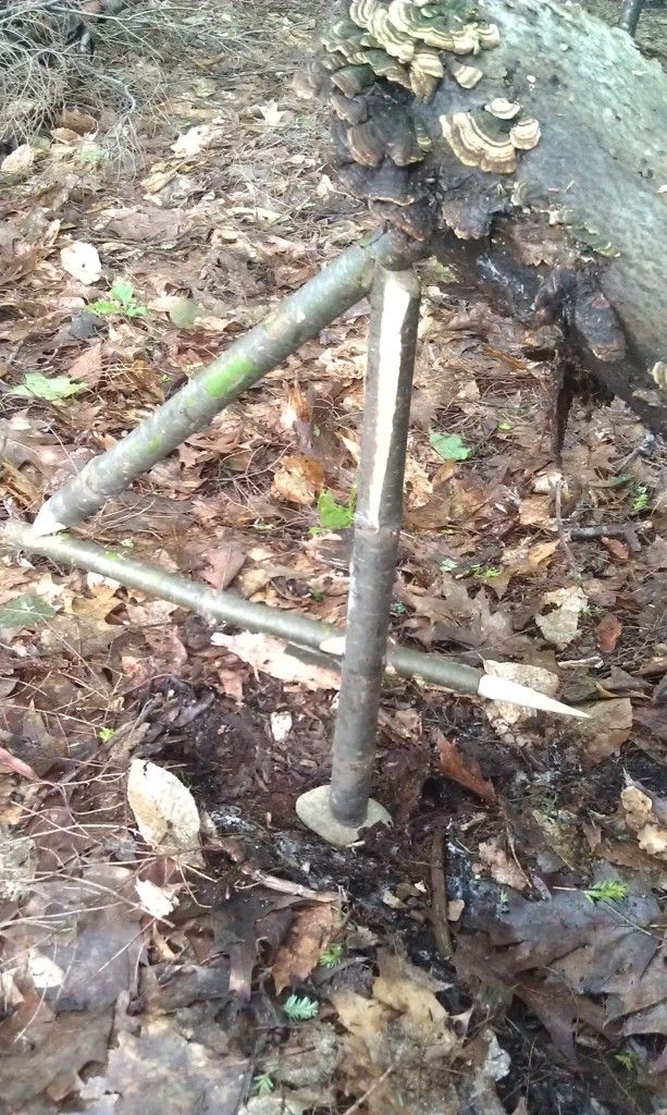

Set with a concrete slab  use for my tip firering. Beer there for scale & I was thirsty:
Closer look... &  had ta finish my brew:
Now disassembled & sitting in the tipi fire-ring for kindling. If anyone wants a close up of the pieces, just let me know, or they will get burned in the next week or so. Or.. DUke will drag them off & chew them up.. He likes to eat stcks.

Nicely done, MN. You didn't waste any time on this one! :thumbsup:

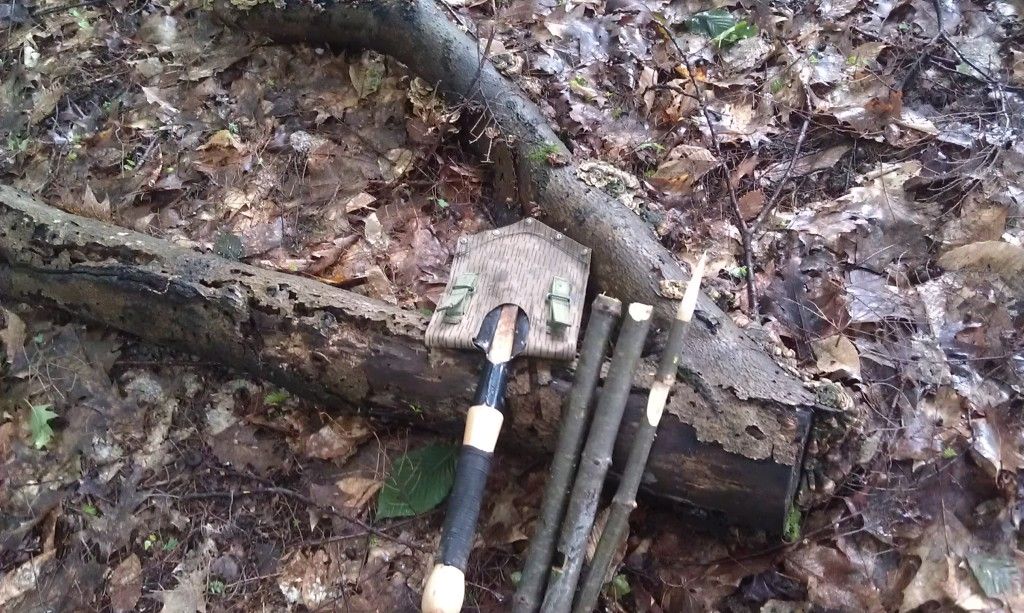

I gave it a go today and wasn't completely successful but I learned a few things along the way. I underestimated how tight fitting the parts need to be and I need to cut the trigger shorter. This one was way too touchy when I got it under a deadfall and I managed to drop that damn log on my wrist about a half dozen times  :-[  I made this one huge thinking it would be easier, but I dunno... I think I'll go smaller next time. Here's a pic of the trigger lying on the ground...that's a full sized woodlore for scale

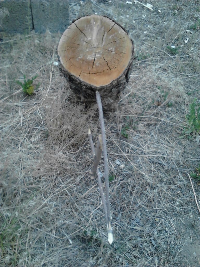

« Reply #9 on: June 05, 2012, 10:06:04 AM »

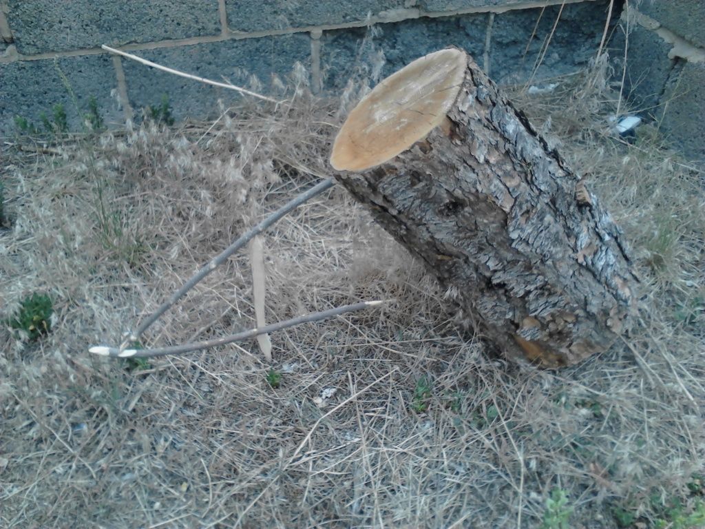

this is my best one yet, seems like the bigger they are the easier.
that log was pretty soaked and heavy, I think this would have been pretty effective. the upright failed to eject with the rest of the pieces but I think it would actually cause kind of a guillotine effect and maybe lead to a more humane kill. it left a pretty deep impression in the debris under the log.
video subplot: learning to trust the leash beast.
« Last Edit: June 05, 2012, 10:07:59 AM by Binalith »

« Reply #10 on: June 05, 2012, 10:13:11 AM »
Many folks place a flat piece of wood, some bark, or a rock under the post stick when actually using this for real trapping. So the "post" stick does fall to the ground, with the weight load.
I only mention the above, for some folks who may not know... (not trying to pull a "Cliff Claven" of Cheers fame snippet.)

wait, I don't understand, why? does it make it fly out better or something? brb I'm gonna go try that.

LOL You will answer yur own question(s) when ya try it.

well that was definitely a more 'explosive' drop, hit a lot harder too. So I guess the rock caused the upright to fall some and rotate. allowing the log to drop faster and cleaner
 it made a nice thump under foot that you can't hear in the video
video subplot #2: objects in frame are father than they appear..

I figured you would see by "doing".
Glad to see it worked for ya.
I watched the Ron H. vids ya posted, & that is basically just how I did mine too. My Dad taught me most of the ones I know. His growing up in the Depression( Hoover times) made it sometimes a necessity ta get fresh meat without ammo which cost money that sometmes was scarce. Thus the traps/snares were used a lot, up in the mountains.

I tried again today and was successful. I still need to do some experimenting as far as trigger sensitivity but I got the basics down now.
Thanks MNS for the useful info on the rock under the fulcrum!
No sweat. If I can help, I'd like to be able to do it.
Glad to hear there's beengood success for ya & everyone else.
In regard to sensitivity, try not to go completely 90 degrees with the "upright/post" & the "bait-stick", make it a lil more "open". You can leave one at 90 deg., but try changing the other to a 90-95 degree. ( I think I got that degree setting right??  :-\ ) I could show it, but not sure I can explain it here in words the rightway...?? I tried though. ;) )
In the Ron Hood videos, he shows how to use "rounding" to accomplish makng a more "hair-trigger" effect. By changing the "trigger to uprght" joint so that it does not "Lock", so much as just "hold", will make for a better trap "set". Rounding the outside(s) of that particular joint will help do the same.
Hey! Experiment...
You may need this type of skill to survive & feed yurself/family or others someday. Best time to practice this, is when ya "Don't" need ta use it.
I hope to see more here. This is Bushcraft/Woodmanship at its' best. Sharing info... I like learning, as much as the doing.. Most folks here seem to think the same way, & that is Outstanding!

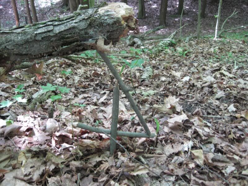

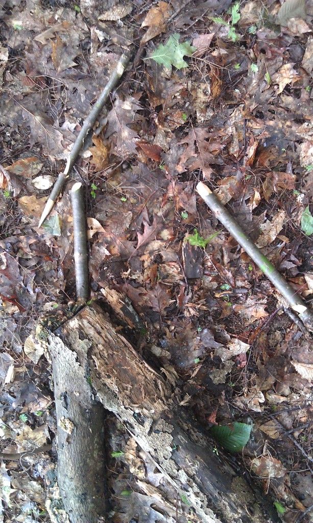

Ok, crappy cell phone pics. AND... "backyard bushcraft". :taunt:
The trigger is Chinese Elm, the log is lodgepole pine (I think).

Looks good to me PW  :thumbsup:

Looks fine to me too!
Only real trouble I can think of... The only one around this place who drinks beer(s), seems to be me. Of course, I only drink it so that I can use the cans for "Scale".. mind ya...

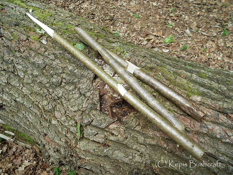

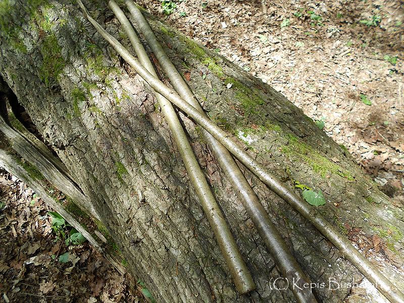

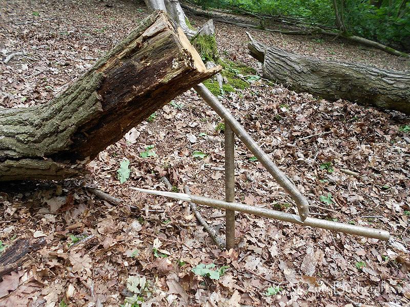

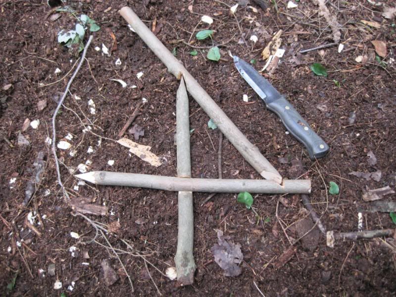

Did mine in the woods today
Raw materials
Carved
and in action
The shape ont he rear of the trigger stick, gives a very fine trigger, saw the shape in the wood and thought, i can use that, it's held in place by friction alone, rather than a stick in a notch as normal

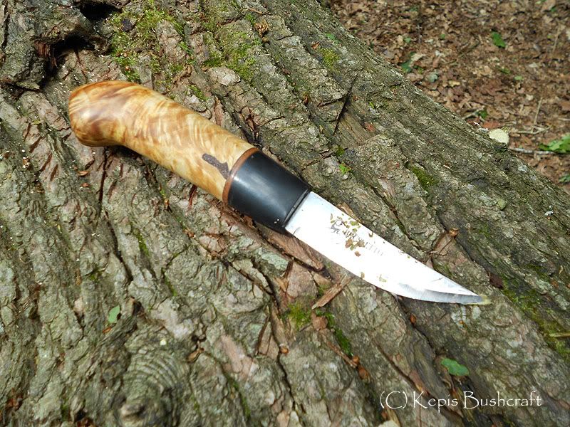

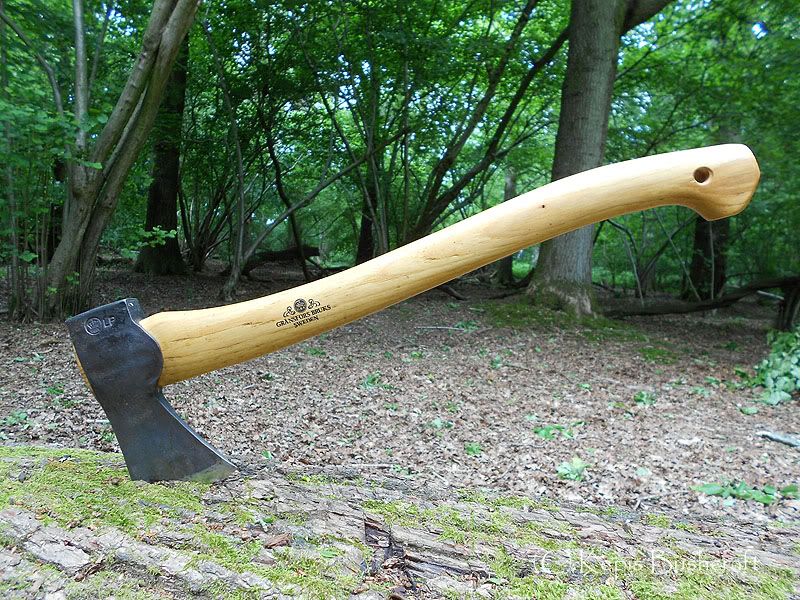

what i used to make it

Kep.... ya showoff..
Fine job!
That diagonal sticks "end" off the trigger stick does look like it would be a possible advantage.
Good use of what was at hand. Of course puttin in them sharpies doen't hurt...
P.S. - about time ya got this done.....  was beginning to worry.... Crooked log may not hit the ground under that trigger, but it was the "Doins"... not the action... Plus, putting in them "sharpies" at the end would never hurt...

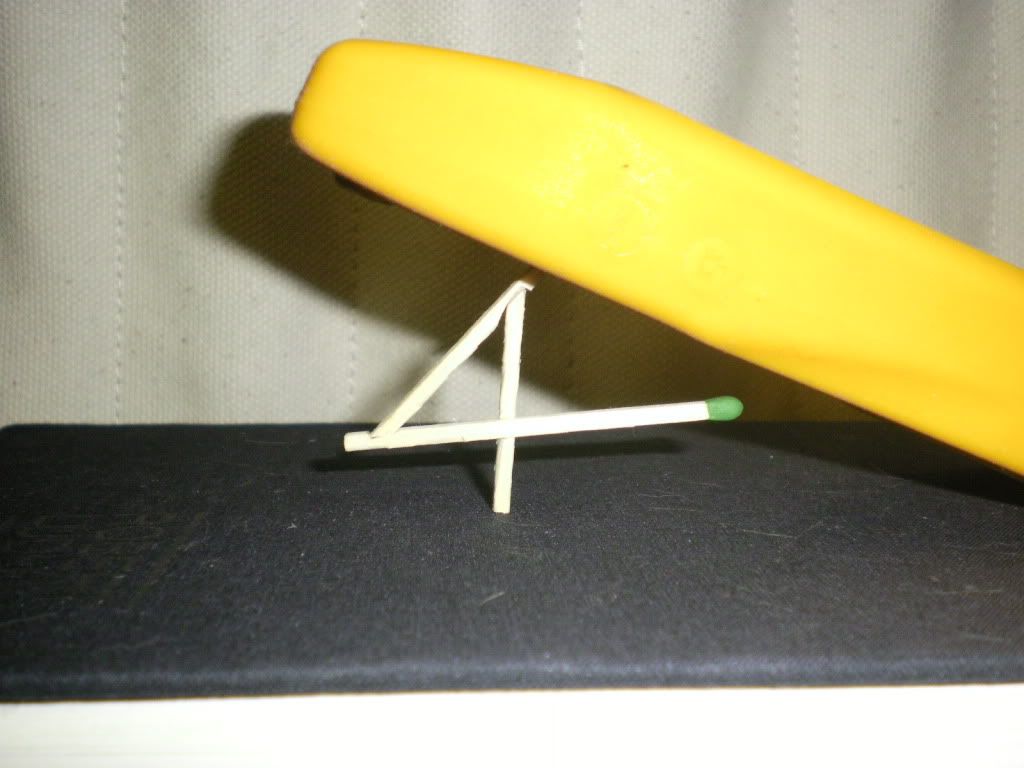

Dose this count?   8)
Re: Monthly Project - June 2012
« Reply #26 on: June 10, 2012, 07:17:25 AM »
LOL
In my book it does.. Not sure about others...
Good one too!

Could've used a little more work here but it still holds:
