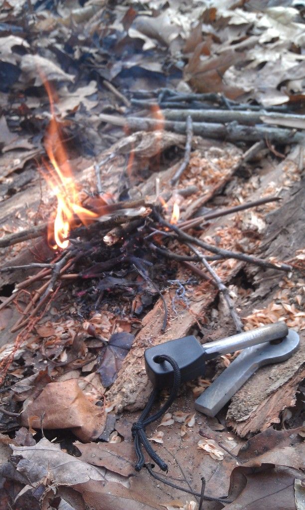

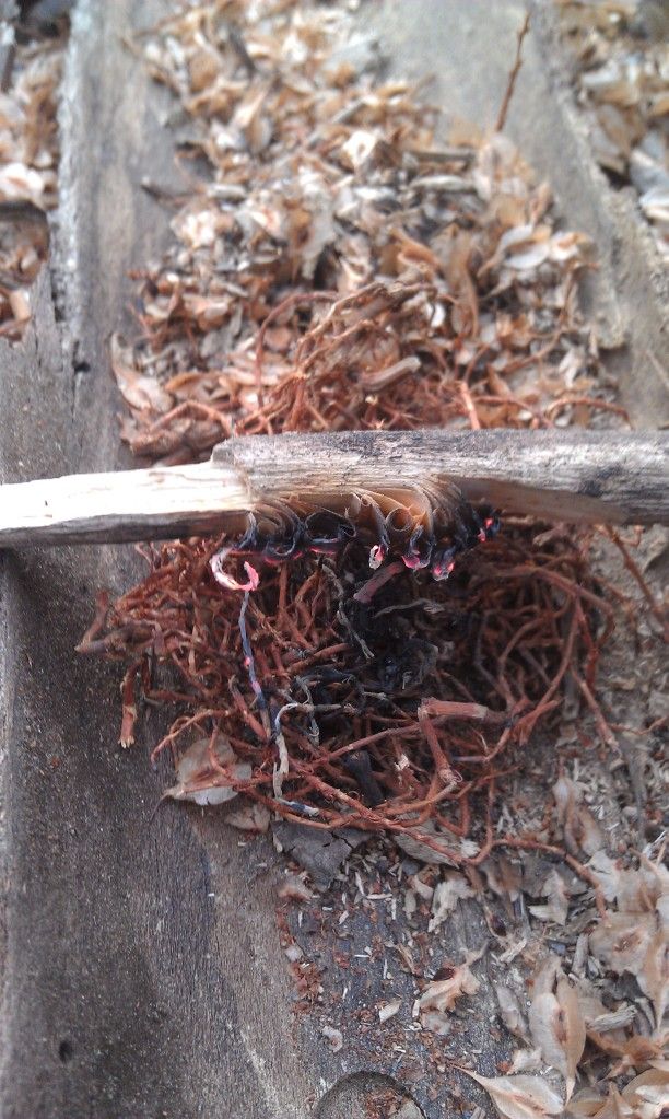

hey everyone, how are ya.
went out this morning to get this one done. I tried like hell to get it going with flint and steel, but unfortunately my flint is all rounded off and I wasn't able to figure out to get a nice sharp edge back on in the woods this morning, I need to learn a little knapping. All I could get were very tiny sparks that were utterly ineffective with my damp tinder selection. It's been very wet around here, we had some snow the other day and everything has that deep inner dampness from the snow melting on it. Ended up going with my firesteel, which due to the level of damp was still a bit of work to get going.
heres my tinders, pale rot, ant rot, not sure what that stuff on the right is called, it was pretty dry, but it took a lot of work to get it fluffy enough to catch, ended up being the small twiggy part mashed and fluffed in my palms that produced a flame, with the the 'leaves' as the secondary catch.
I couldn't get the rot to stay alight, had a few catches, but once the truly flammable parts burned off it quickly went out, maybe in a real sitch I would fill my tinder box with it and possibly roast it a bit for a sure fire coal extender.
Heres the stuff that took:
and my little fire:

I have had no luck with flint and steel. I am a never ever be without a firesteel guy. I have a bunch and still get giddy when there is one on sale.
My always go to is birch. I believe it is yellow. The bark curls off the tree in horizontal shreds. It can be lifted off the tree with no damage to the tree at all. I have two videos, older not recent, but the first is very wet conditions and the second is a bushclass vid from "over there" LOL.
I also have had good luck with the dried ends of the lower dead branches from pine trees. split or shaved. I read a lot about milk weed and cattail and even thistle. Not sure why you guys go so small in tinder. I can get some big stuff to catch from a firesteel. Here is proof.
VERY wet conditions...
http://www.youtube.com/watch?v=ZismRx26g94&list=UU267Lhxoc5LcsQwai7X2NyA&index=20&feature=plcp
This is again birch bark right off the tree...
http://www.youtube.com/watch?v=uFJosknOMhQ&list=UU267Lhxoc5LcsQwai7X2NyA&index=3&feature=plcp
This is a pile of shavings from a random branch I found that was dry. This too was just shaved wood. no small tinder at all. took a lot but I did it LOL.
http://www.youtube.com/watch?v=BaXBXZfoYoc&list=UU267Lhxoc5LcsQwai7X2NyA&index=12&feature=plcp
