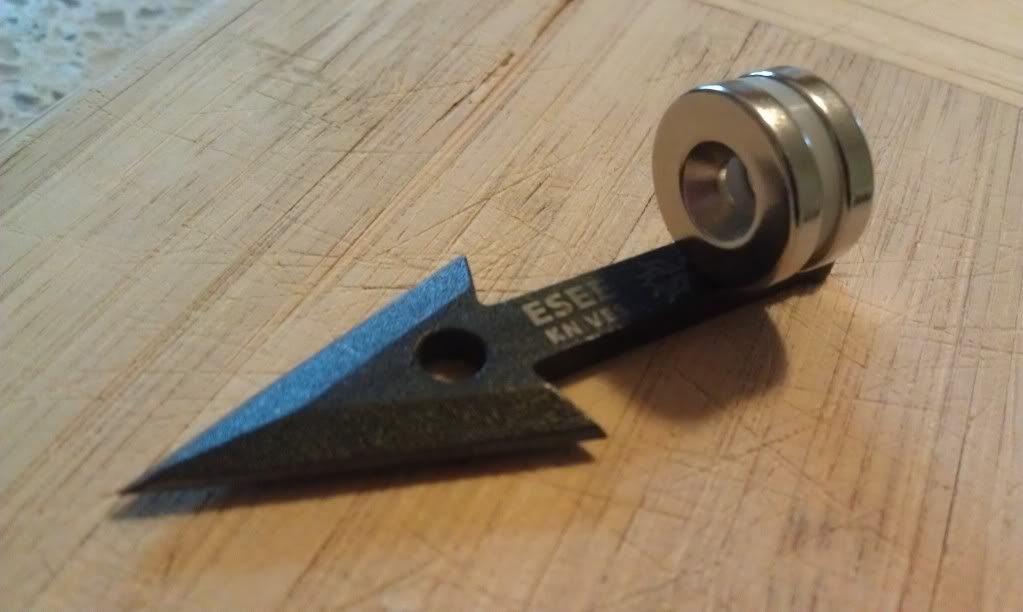

this is definitely using fancy tactical gear, but I was excited that it worked:
I pushed the magnet from the tip back to the end probably 20 or 30 times. Those are round neodymium magnets so I think the poles are on the  perpendicular axis to the plane of the round....i think. Since this seemed to work so well I think I will get a marked bar magnet and keep it on it when I'm at home so I can be assured it will always be aligned correctly.

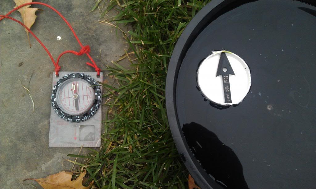

heres the compass in action.

Awesome! I have one of those ESEE arrowheads. That is a really neat choice of compass "needles".
