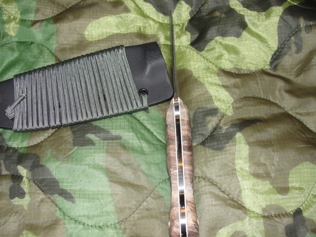

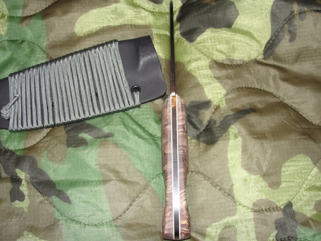

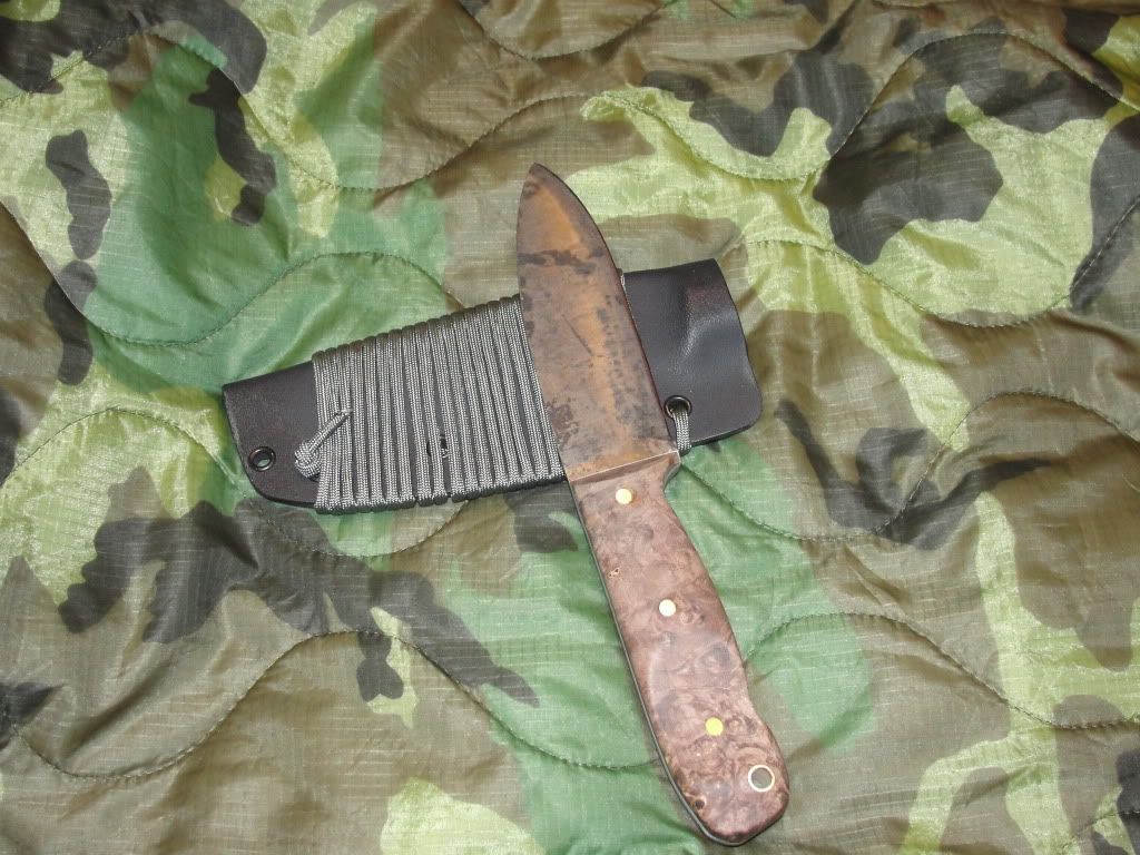

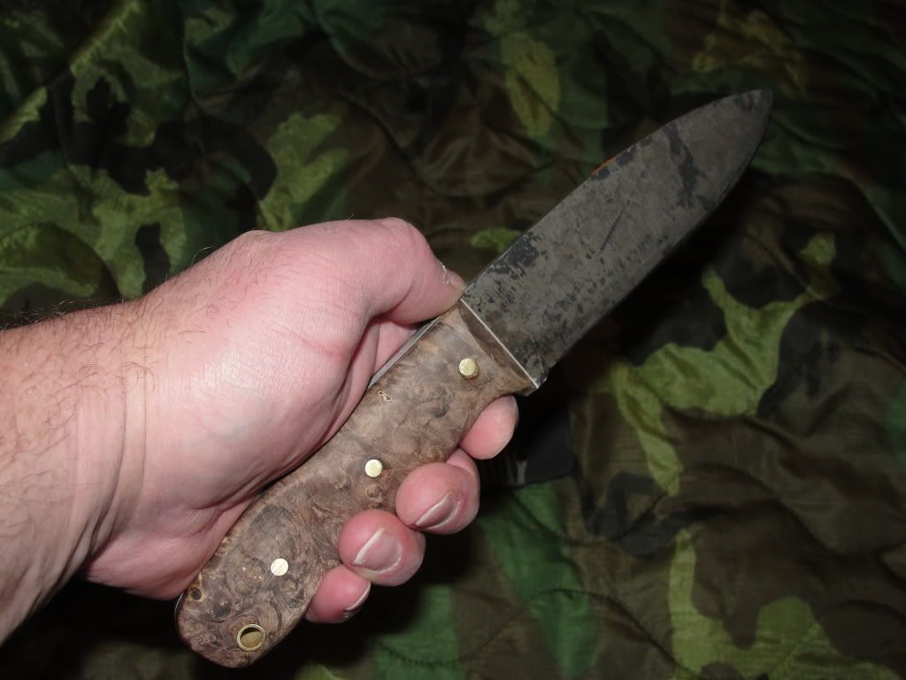

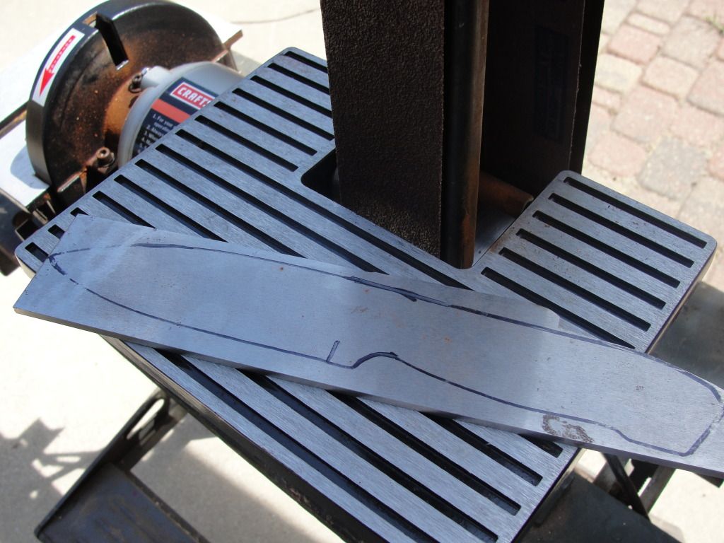

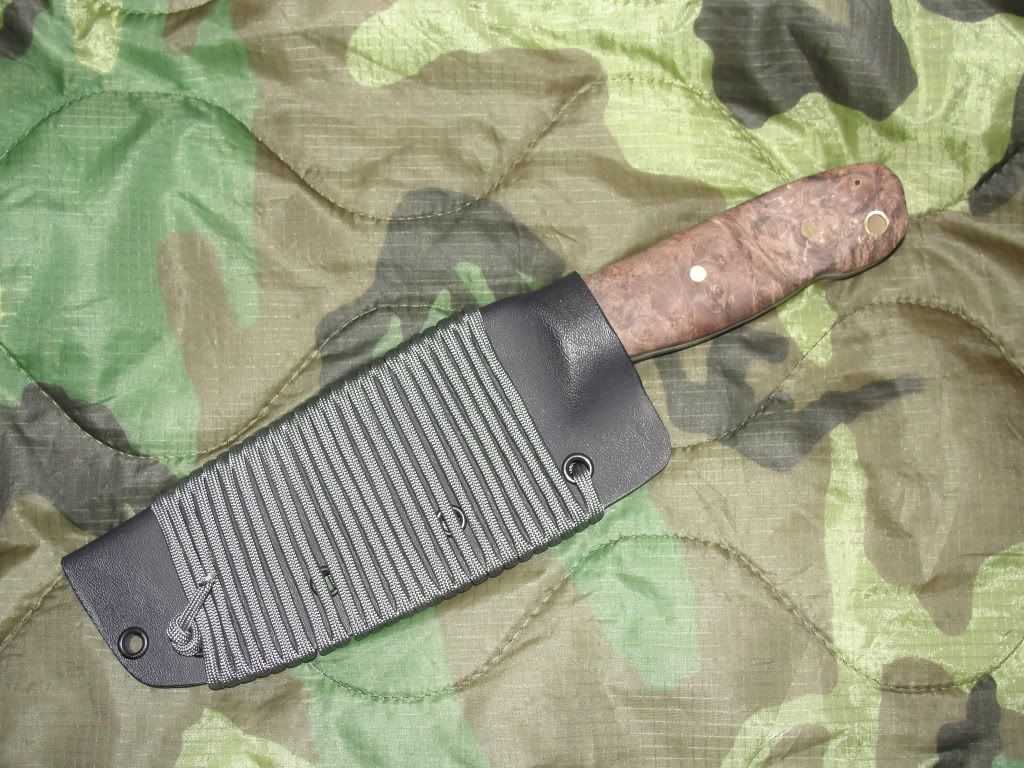

I am heading to the Florida Kracaneuners Pot and Knife Survival Challenge in a couple weeks or so.  I have several knives but I couldn't decide on which one to bring.  So, I decided to build my own.  I wanted a heavier knife that I could use as a chopper/hunter knife (is that my own classification).  I am not sold on a convex edge but I decided to put a very robust convex on this.  I think after the event, I will end up regrinding it and putting a scandivex on it.  My interpretation of scandivex is initially a scandi and then slightly convexing it.  Ultimately, whether I regrind it or not depends on how it performs.  I left a lot of "meat" on the scales because I have feebly large hands.  I have nerve issues in both my hands and a larger handle, definitely, helps me.  I left the forge finish on the knife because I think it looks good.  Usually, when I have a beauty queen type knife, I don't end up using it.  I end up looking at it and that's about it.  So overall, on this particular knife, I put 75% emphasis on getting a beauty finish.  As you can tell if you look hard enough that I left scratches in the scales etc.  This is because, I don't want to be afraid to use it.
I made the Kydex sheath.  The knife fits snug and won't fall out.  I tried a new technique with the kydex this time and I will be doing this with all my future sheaths.  When I get back and if this thing performs properly, I will reward it with a proper leather sheath and a high gloss handle finish.

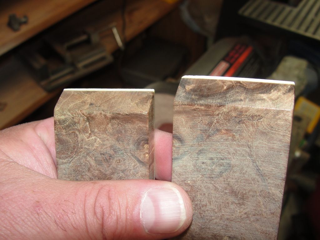

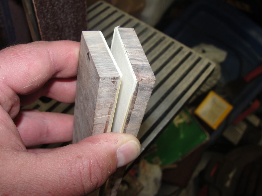

Here it is followed by a build along.
Spec: O-1
5/32" thick
10" overall
5" blade
5" handle

Very nice robust looking knife but based on the pictures it can't be very sharp.... you still had hair on your arm  :lol:

No I don't shave my arm hair.  I shave my leg hair.   ;)
Actually, I did the paper shaving test.  It comes out decent (better than I thought for a big thick convex).  It is not designed to be a hair splitter with the robust convex but more of a chopper.

Damn it... I'm just not a fan of kydex sheaths.
Other than that it looks fantastic :)
And yes... I am a bit of a traditionalist ;)
Re: My New Personal User Made for the Pot and Knife Challenge
« Reply #10 on: January 09, 2013, 04:43:48 PM »
BH, I'm not a fan of kydex either. I met my friend CSugg for breakfast this morning and he had a bushtool in kydex set up for upside down necker carry. Was one of the coolest rigs I've seen in a while. I'm shopping kydex for my bushtool now. Open minds breed open hearts :)

Nice looking beast you made, Matt.  Make sure you beat the tar out of it before you head out so you know it'll hold up when you need it.  Now, if you're gonna cheat and bring 550 cord on your sheath, make sure you throw a few more yards on it so you have enough.  LOL.

Very nice.  Love the scales.
Although, the 550 is on the sheath it won't be used on the challenge.  ;)
And I won't have a chance to use it before the meet up.  I am sending it to FL today so that I don't have to worry about it on the airlines.  It will be a 100% blind field test on this.   ;)

SA-WEET Matt!!  Those are some purdy scales too!!  What kind are they?  I'm digging this and can't wait to hear your report!  That was a good idea to ship it down there, good thinking...that would absolutely suck to get there and find out your knife didn't!

I left a heavy heavy convex edge on it and I am second guessing myself now.  I haven't tested it out at all and I am starting to think if I should have made it a little better for slicing than chopping.

The knife did all right.  I left a heavy duty convex on it but I should have thinned it out and made it a little more for slicing.  The flora down there is way different than up here in Illinois.  I was planning on batoning logs etc and in actuality needed it to bite into palm leaves (fromms???).
I mentioned that I was going to give it a face lift once I got it back to IL.  I just got it back.  My Dad only took 4 months or so to send it to me.  :P (I didn't want to take it on the plane)
