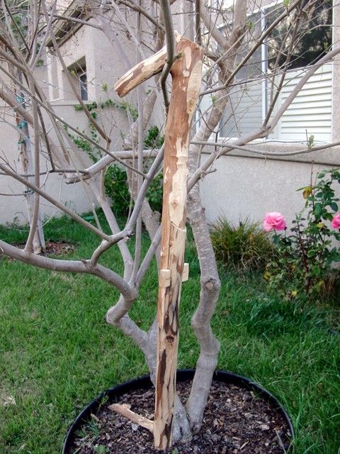

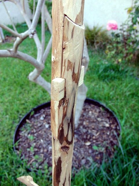

« Reply #10 on: March 04, 2012, 06:53:29 PM »

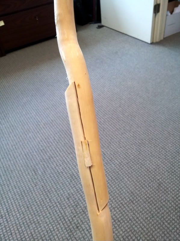

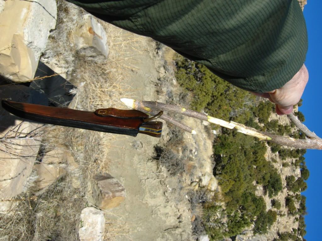

I got one about 75% finished today.
I still need to carve the locking wedge. I think I might have made the 'split" section too long so that the wood will flex enough to make it pop apart, but part of this is learning by doing, and I've already learned more than I ever could about this design without actually taking a knife to some wood.
« Last Edit: March 04, 2012, 07:01:22 PM by PetrifiedWood »

lookin good PW! ill gather some wood this weekend and do one up, been getting slammed with work last week, and this week doesnt appear to lighten at all.

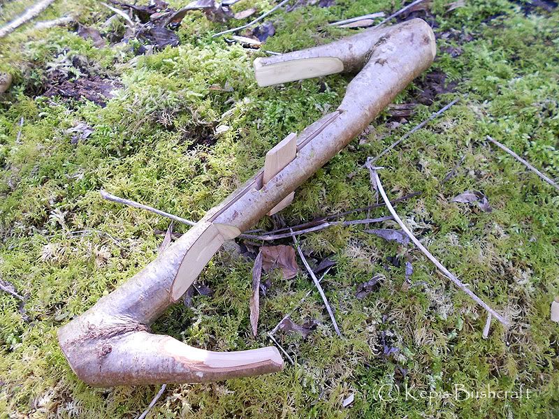

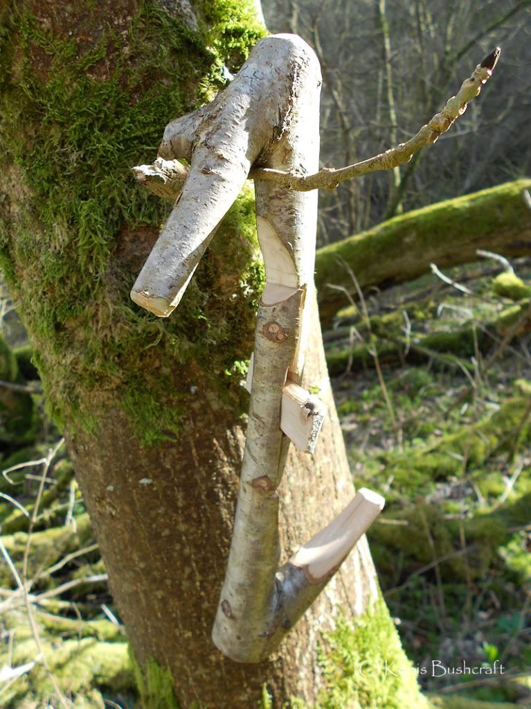

well here's mine, made it up the woods today, not the best one ive ever made as the wood was a little too thick apart from the fact that one piece was also dead and just starting to become a litle punky, but it will work
Made from Hazel, i couldnt for the life of me today find the right thickness of wood, i might do another, better  one in a few days time as i know where i will be there are suitable branches i can use

Looks good to me, Kep!

cheers guys, im going to redo mine i think, not happy with it at all

Mine's not nearly as nice, but it holds together enough to lift my knife and probably a one quart pot. :D
I shortened it up a good bit from the first attempt, and was able to save the pieces that way.
If I were to make one "for real" I think I'd go with much thicker limbs. These were about 5/8" at the thickest. The larger the parts are, the less precise the cuts have to be. And I'm terribly sloppy at carving.

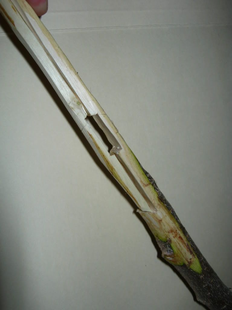

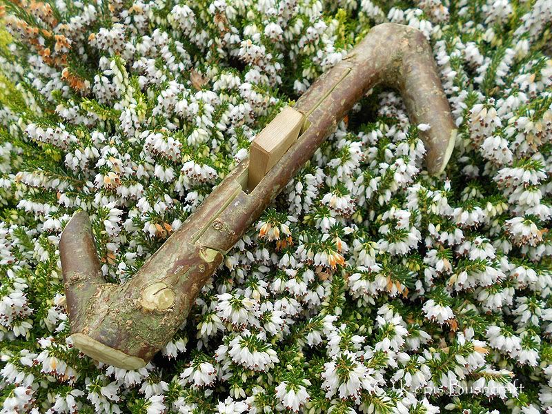

i wasn't totally happy with the pot hook i made earlier in the week, so today i made another one which has turned out far better
The hooked sections are Hazel and the wedge is seasoned Cherry, made the whole thing with my Little Whittler knife, will probably make another later in the week of a slightly different design ;)

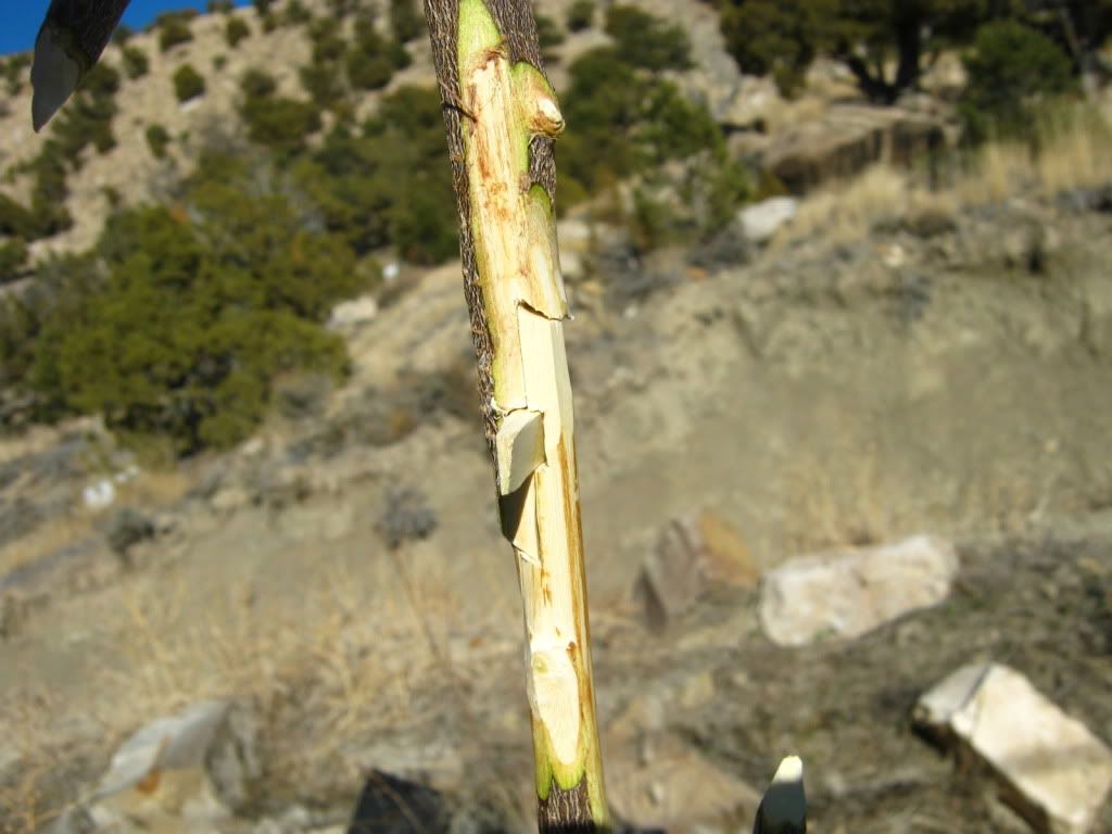

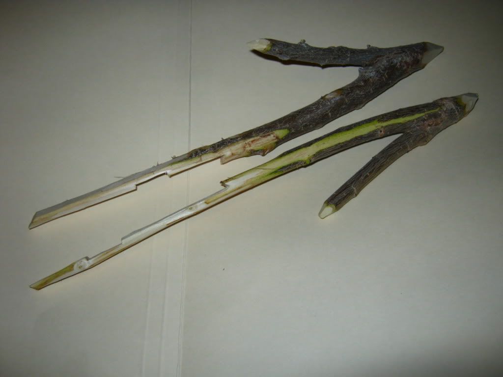

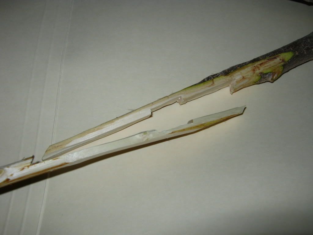

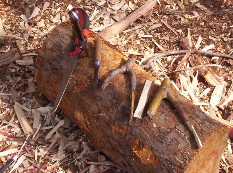

Ok, I tried this today and learned a few things. It is a fail, but I will try again when I get a chance!
I stopped because attempting to go any further was silly!
Things I learned:
1.) do not try with dry hickory
2.) Use a more stout knife
3). Carving skills are forgotten when you are so use to just hacking at things with long blades and axes!
4.) have fun, I started to get frustrated and realized that this was supposed to be fun!
5.) pick straighter more even sized pieces
6.) have a plan!
Here is what I got. The wood was a bear to carve and would split when trying to do the angle cuts
« Last Edit: March 11, 2012, 01:26:47 PM by Mr. Tettnanger »

Kep, I was examining the photo of the pothook that you took and posted on March 11th and while it looks hefty enough to hang a 13" cast iron potjie, brimful of Cajun gumbo......I think I see a potential problem.  As pictured, the wedge isn't filling the mortise all the way to it's ends and it is depending on friction alone to keep it from slipping, so it doesn't appear to be taking full advantage of the basic mechanics of the design.  In other words, just a little too much weight could allow enough movement to pop the ends of each hook out of it's dovetail mortise.   Correct me if I'm off base, but I am one to always anticipate looming disaster....after all, I'm a farmer :-X
I hope that makes sense to you......just trying to keep the cauldron from falling off the crane and into the fire pit.  A lighter billy pot probably wouldn't be a problem at all, but an old Dutch oven slinger like me would probably encounter disaster 8)

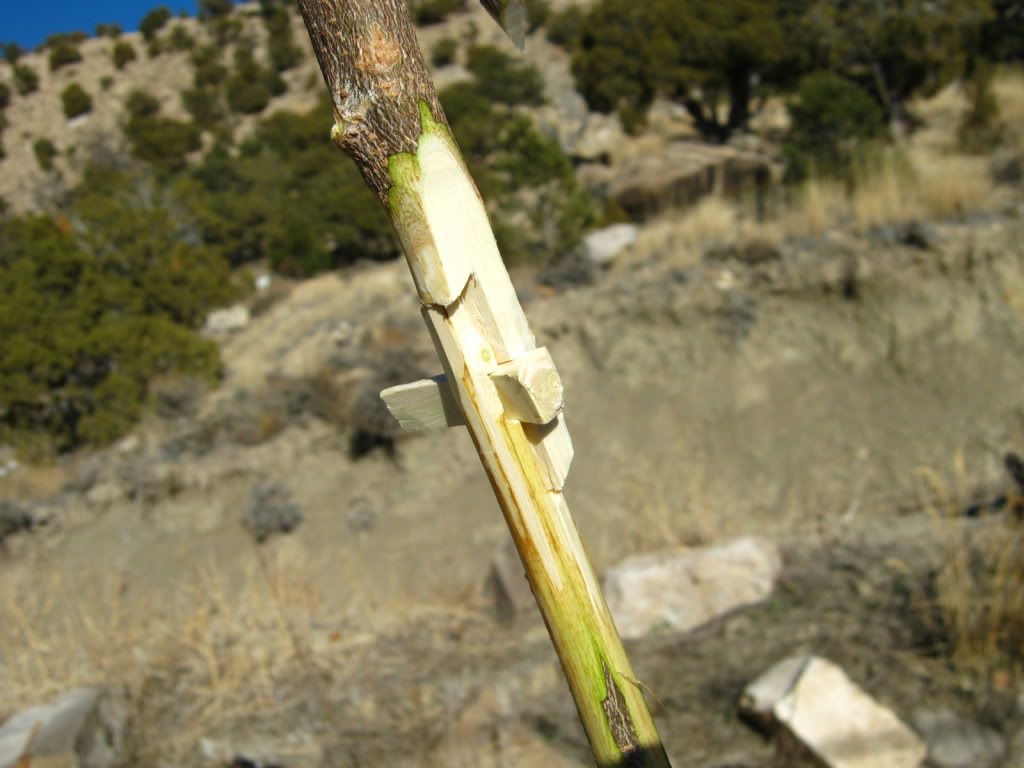

I finished mine today.  It's made out of the only two pieces of cottonwood I could find that weren't too thin or rotten.  Both are about an inch in diameter.  I tested it with a full 1.3 gal./5 liter jug of Tide detergent. (only thing heavy and with a handle I could find at the time)  It held up fine.

that is a good solid fit GB! im still trying to find some pieces for mine amidst my work :( i will finish it before April!!!!!

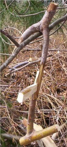

Did it! Don't know what the wood is, but it seems to work. I'm going to make a new wedge, but it fits and hangs pretty well. I pulled on the hooks and it stays together.
Next time I do one, I'll make it a tad shorter, but I like the double hook on one end, will work to hold multiple things.

Put a beercan in my Mug for weight, I didn't want to go dig out one of my pots, as I was thirsty & the mug & beer were handier.. ;)
Took me over an hour to go get & make that potholder. I will likely not make one again unless I get bored sometime..LOL   was losing patience with that damn wedge part..let me tell ya LOL
so...I took about 3 minutes to walk over to a tree in my yard & cut this potholder below(next to the other one), which is what we usually do for a holder when we use a crossbar:
Been using the type I showed in the last pic for so long that I think I'll just stick to that kind, or one of those pole type ones... Much faster to make, & I don't carry stuff like that around with me, when I can just make a field expedient one on the spot.
So I got the project done & as a matter of fact I did the DeadFall(April) 2 days ago, just haven't up loaded the pics yet...

I don't have the materials close at hand to make one right now...unless I sneak into a neighbors yard and cut up their stuff...
..but bonus brownie points if anyone can name that joint y'all are using on these hooks.
Be back later with the answer.
Hint: It's a timber framing joint that was first widely used in shipbuilding.  The USS Constitution has a number of those joints in her framing as well as her keel and they are still tight to this day.
