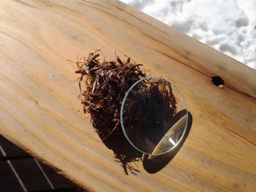

A good source of 'burning glass' lenses are the objective lenses taken from old cheap binoculars that have gone bad. :thumbsup:
Another helpful hint to get the most heat from the focal point, is to keep the focused light-point perfectly round.  This may require tipping the surface of the tinder so it is perpendicular to the sun's position in the sky.  Wear sunglasses! 8)

Good tips guys! Definitely use caution with the bright spot formed. It is hard to look at.
Also, darker colored tinder works better than light colored tinder since it absorbs more light energy.

+1 on the darker colored tinder.  I have tried countless hours trying to get white cotton balls to light to no use.  I have had great luck in using dry grass and leaves and the papery inner barks of trees like birch.
I vow that if my lawn becomes as dry as it was last year, that I will try to start the whole yard on fire with pictures to prove it.   ;)

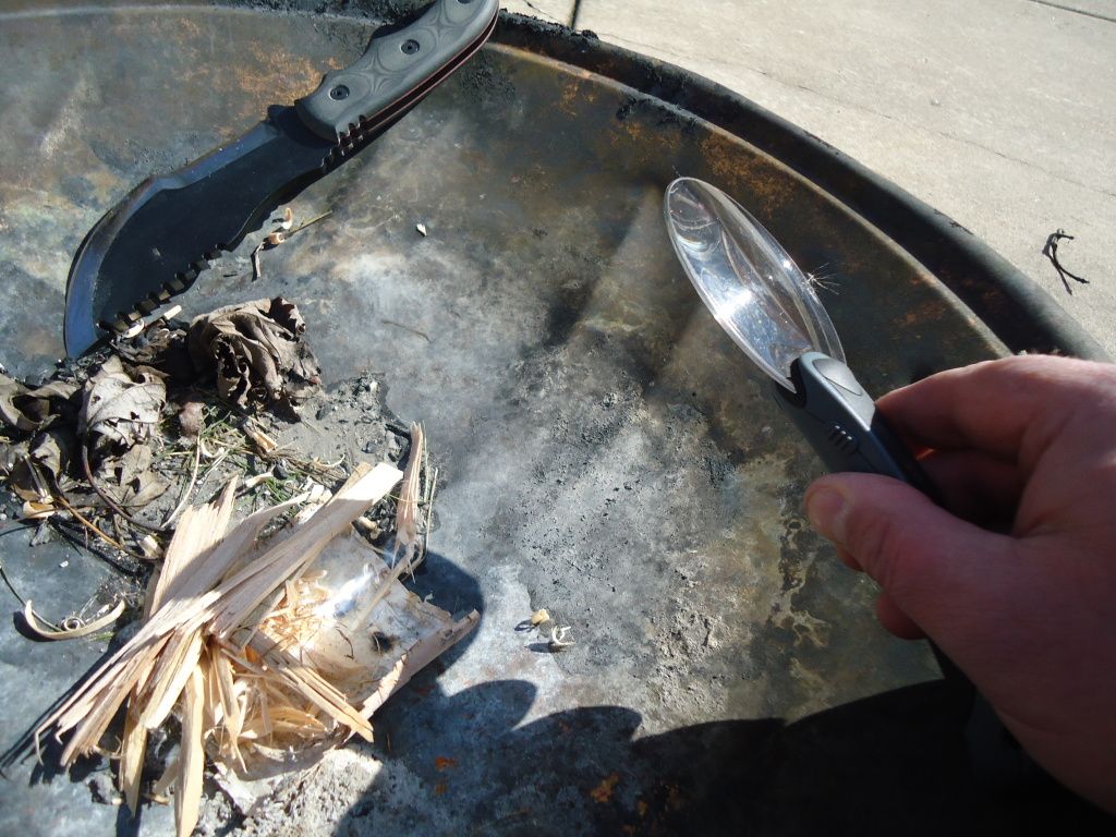

My wife has a SAK with one of those small magnifying lenses on it.  I tried to start some tinder and char cloth, but with no success on either.  Not much sun here today, though....lots of hazy atmospheric conditions, so maybe on a summer day with more direct overhead sunshine.  I still have my doubts, though. :-\

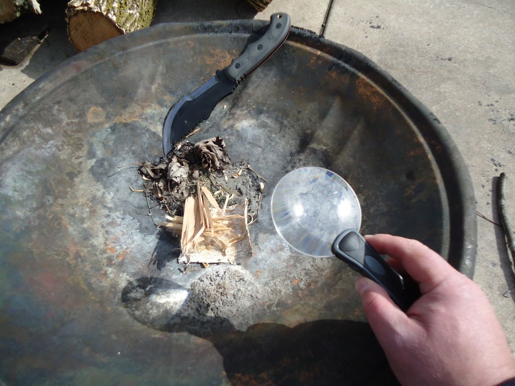

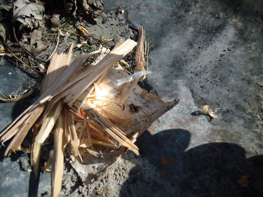

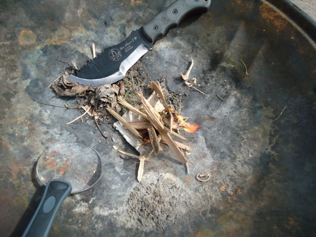

Here are my entries.Outside conditions were Sunny sky, North wind at a steady 5 knots or so. Temperature was about 9-10 Deg.F at the start, maybe 15-17 Deg.F. at the last pic.  I used one of them Hudson Bay type tinderbox mag. glasses for the first one, & then a broken "credit card type"  Fresnel lens for the last ones. There are 3 different types of tinder I used. Cottonwood punk for the first one,  & Birch-bark, and then Horse-hoof fungus for the other entries. I had success within 4-7 minutes of the start with each one, but the ones that were the hardest was the Punk-wood at about 9-10 deg. F. at about 10:15 C.S.T.. The other 2 were at around mid-day(12 noon C.S.T.) and took off right away, to get an ember.. The Birch-bark was stubborn. It lit the fastest, but wouldn't hold the ember very long the way I did it. I needed a bigger pile of it, rather than a thin wafer of bark, & if I had "tufted" the bark a bit it could have been the "champeen" of the deal.....HH fungus was a "shoe-in" of course, but I knew that already..You get an ember& you are "made in the shade"...LOL ;)
Here are the pics:
Punk-wood with the Hudsons Bay Tinderbox setup. I used one piece ofpunk & got an ember, but the North wind was not letting it grow, So I got another chunk o punk with a "ridge", to help block the breeze, & shredded the other punk...Worked much better:
Getting ready to line up the "spot":
Burnt an ember, but it won't"take"yet...
Got an ember again, but the time to take my gloves off, & get the cell phone ready to take a pic...not good...Think...gonn a change the "tactics", same mission...:
New chunk o punk-wood with a "ridge" in the middle:
Couple minutes later, I try to take a pic of an ember...It is there...crappy pic:
There it is....:
Still there... :D :
Moving on to a bit later. I had to send out a package of 550 cord to Woodswoman. I barely got there before they closed.I only sent one of 2 packages.They wanted to shut the doors & go elsewhere... I'llsendanother on Monday...
Anyway...
Time to try a different material & a different lens. The Fresnel lens I had was broken. So all I have to use is one that is 2/3rds regular credit card size & the other is 1/3rd credit card size. I use them both & have success with both...
Materials used are Birch bark& a HH fungus/mushroom. Used a Lansky puck for a"tinder weight" for a while, until the breeze lessened...
Here are those pics:
Well.there they are...I may have a couple of pics out of "order" towards the end in the Fresnel part...But that is one of the reasons I hate trying to upload, download, upload again & post them daggone things...
My "submission" for the March 2113 Monthly Project anyway...
I hopeto see some other posts showing this months projects right soon!
Sun is out in the daytime...

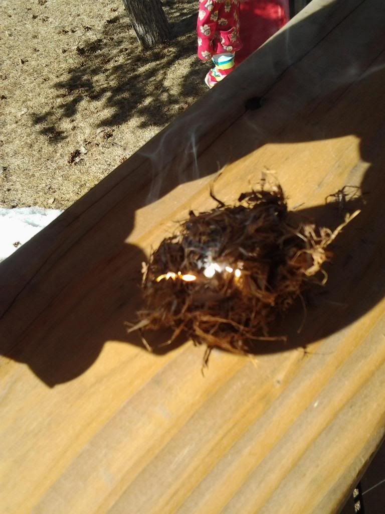

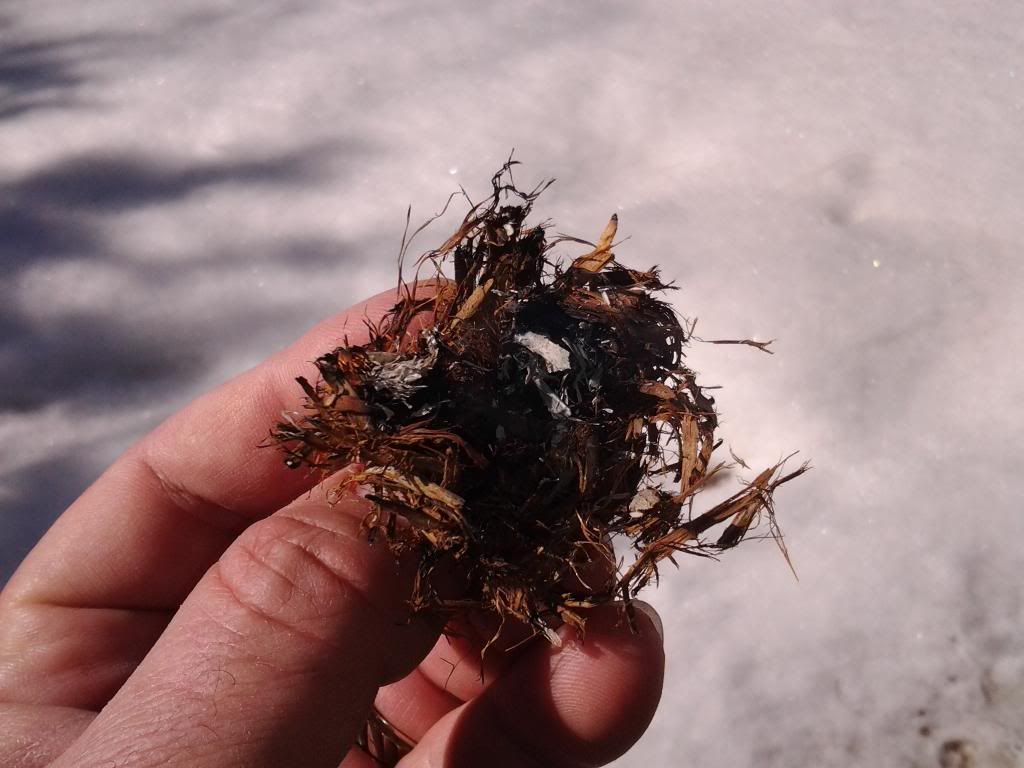

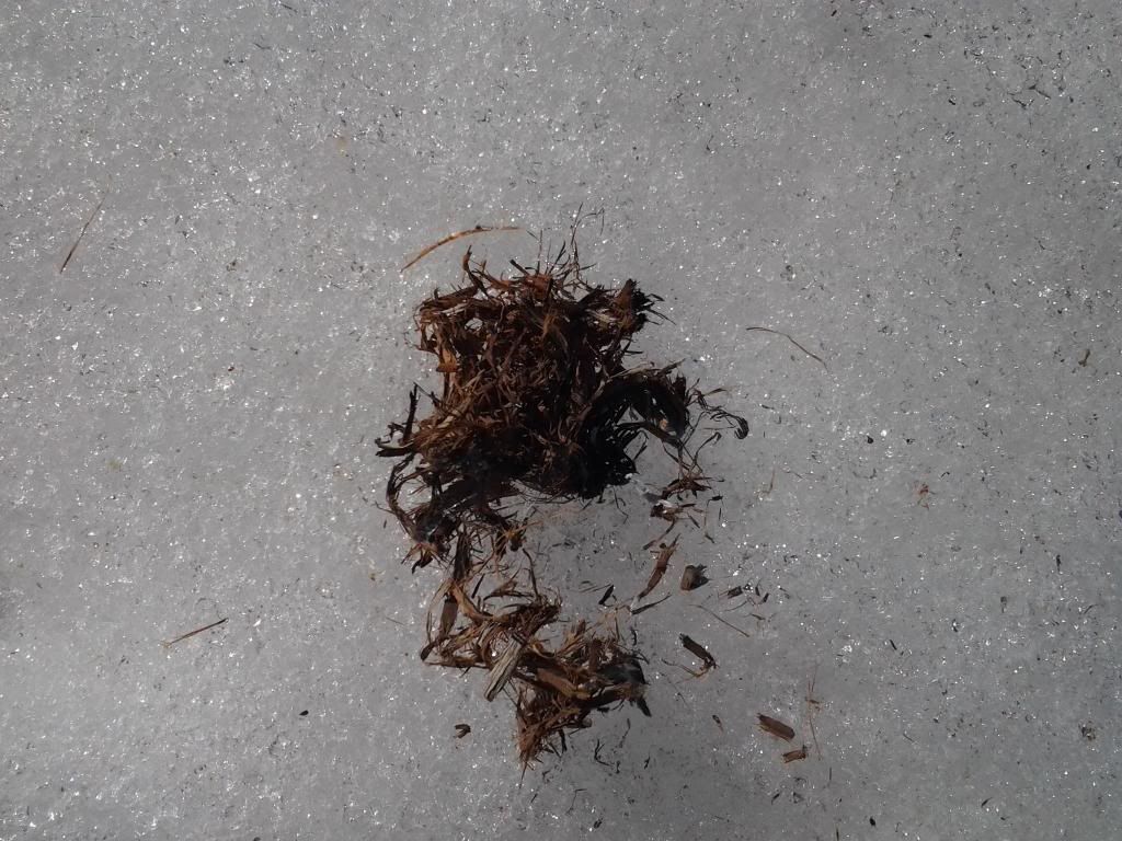

« Reply #23 on: March 05, 2013, 03:08:17 PM »
Well, I got a few minutes to give this a shot today. I have been so busy lately I just try to grab a few minute here and there when i can. I wish I'd had video of it, but only got some "before and after" pics. I blew it to flame on the deck railing and then quickly tossed it down into the yard where it went out, but it continued to glow for some time.
The tinder was juniper bark, and I had to blow on it while simultaneously holding the lens at the right distance and angle to get it to work. It was easier that I expected it to be. I didn't have to use any coal extenders or anything, just the bark.
The prep.
Smokin'! You can see my helper in the background. :)
This was after it hit the ground. It's a bit bright to see the embers in there but it was still smoldering at this point, about 20 seconds after the flames went out when I tossed it down. I blew on it again but couldn't get flames a second time.
The remains. Still smoldering slightly.

I had some sunshine today so I got out and made this task work.  I have such trouble in the winter and cold months and just the opposite in the summer and warm months.  I am not a physicist but I think it has to due with the distance of the sun from the Earth.  Or it could be the colder temps outside in the winter.  Whatever it is, I will tell you this, that I placed my finger under the beam and it took longer to make me have to move it out of the way (a lot longer) and in the summer it is less than a few seconds to where I feel pain from the heat.
I was outside for over an hour to get this to light up.  I ended up having to blow the ember that I, finally, got to flame.  I tried to light up some really old and dry cattail fluff and that didn't light but only burnt up.  In the end I had to use some natural fibered rope to get it to take an ember and light up.
Just getting ready to get the lens lined up (before adding the natural fiber rope bits).
Getting smoke but no fire yet.
Finally, got some flame after blowing the ember that took me forever to get.

Finally! Got synchronous free time and sunlight!
Using an old glass pocket magnifying glass my wife had:
Using the tinder tube I made a week or so ago. Got it smoking pretty good but it's pretty windy so I ended up having take both in my hands and use my body as a shield.
Wasn't out to make a fire so I just lit some shavings, etc.
Out of focus pic where you can see the tinder tube lit.
