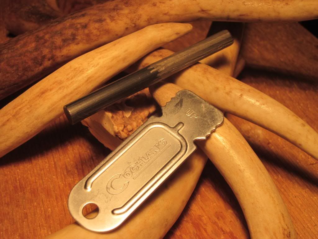

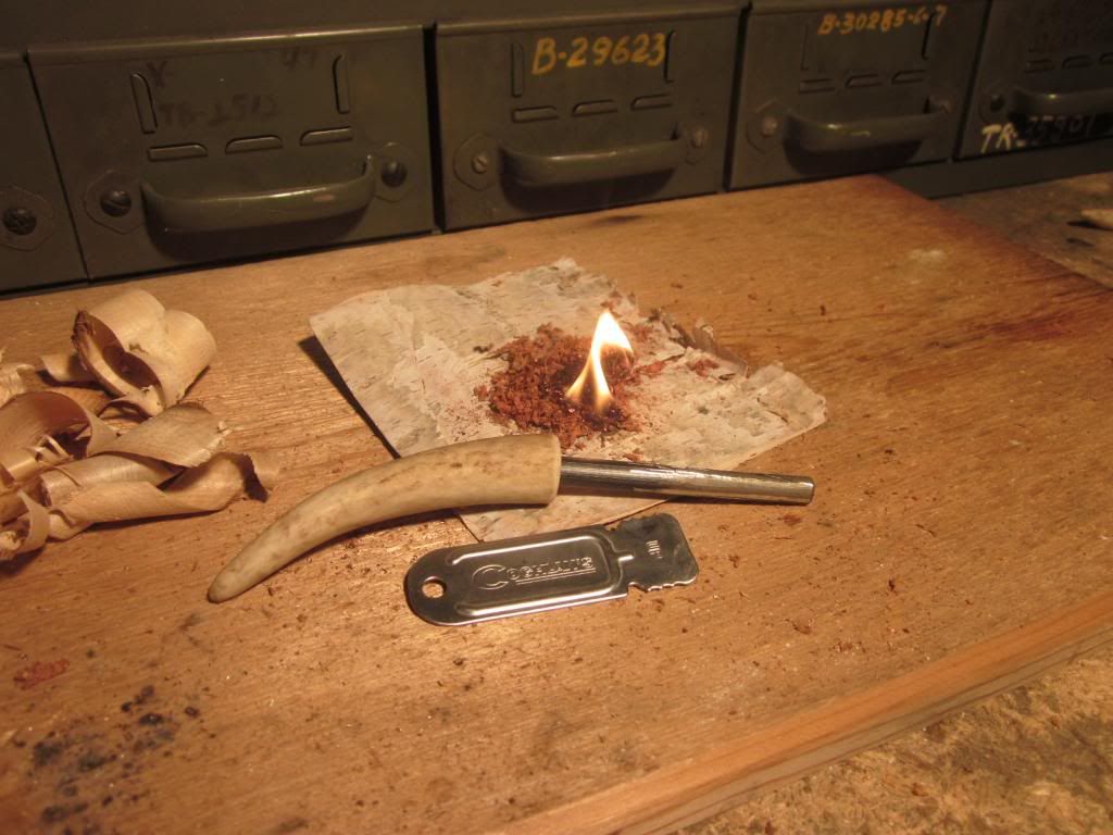

This month's project will be pretty simple, a lot of you guys think out side the box so it will be interesting to see what is created.   ;)
November 2013 Monthly Project will be to make a custom handle for your Ferro Rod.
I enjoy using Ferro Rod to create fire, I prefer the Swedish made Light My Fire Ferro Rods but when I saw a Coghlan's brand (at the local Farm & Fleet) for pennies on the dollar I snatched it up!  It wasn't a such a bad buy but the handle fell off after a couple dozen strikes.  Ahh... What do you expect it said "Made in China" on it!   :P  So when you get lemons you gotta make some lemonade!  This little mishap gave me an opportunity to make a way cooler custom handle the old one was a small stubby piece of plastic that was difficult to get a decent purchase on!
The guidelines for the project are to make a custom handle for your Ferro Rod!  You can use any kind of material and any size diameter Rod!
For my replacement handle I wanted to use antler.

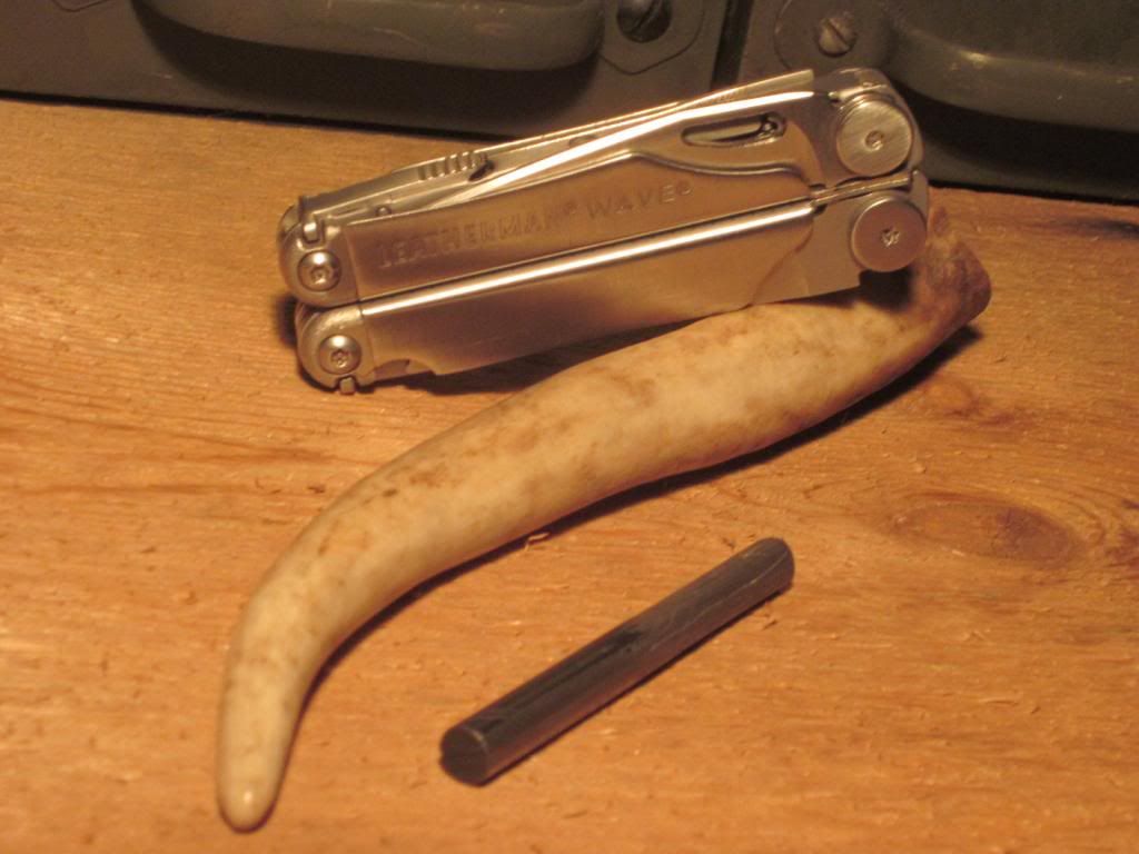

I selected a tine of stag antler that feels good in the hand.

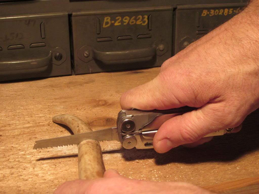

The saw on my Leatherman Wave is perfect for making clean cuts.  (Always wear a dust mask when cutting antler!)

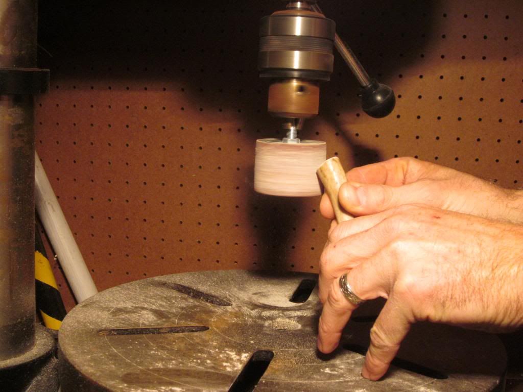

I'm using a drum sander to knock off the sharp edge from the cut.

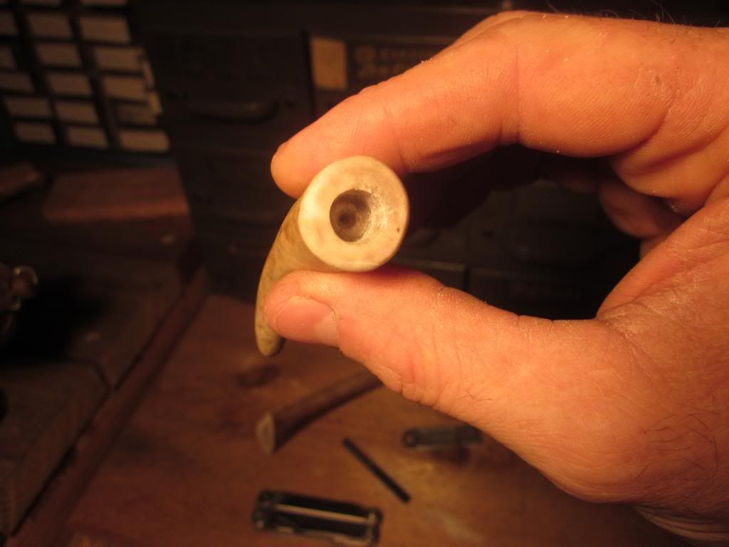

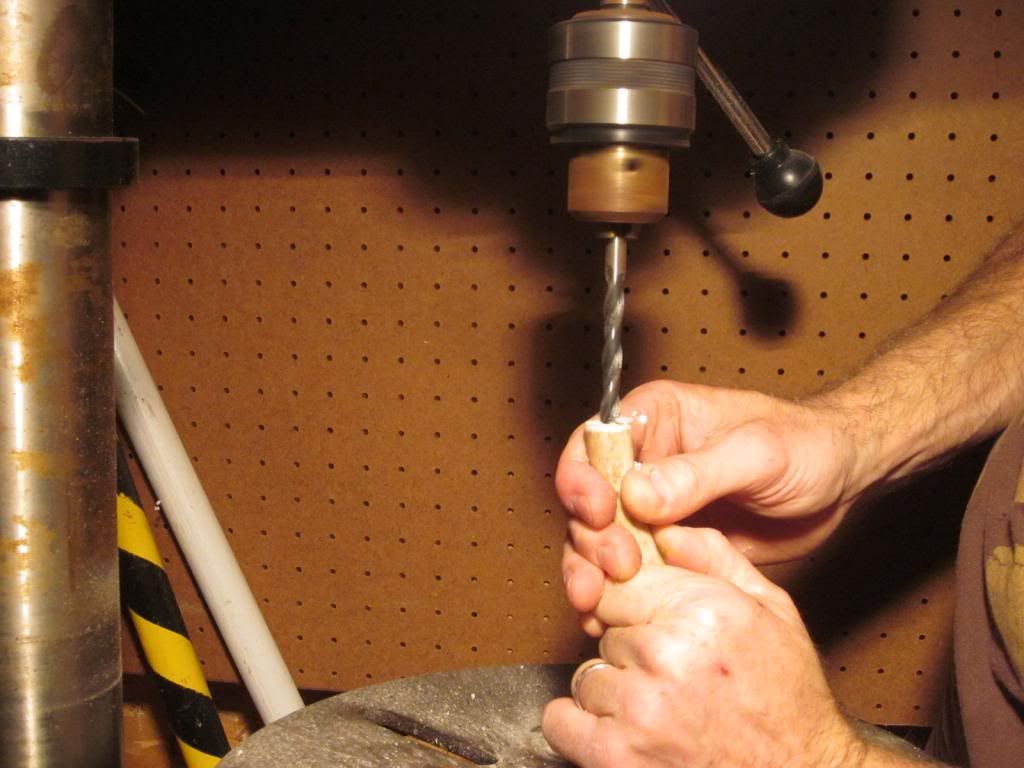

I drilled about a 3/4 inch socket for the Ferro Rod.
I got the hole centered pretty good.

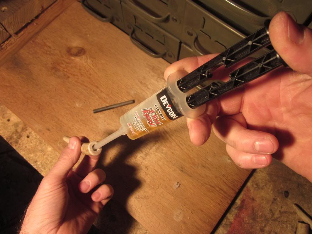

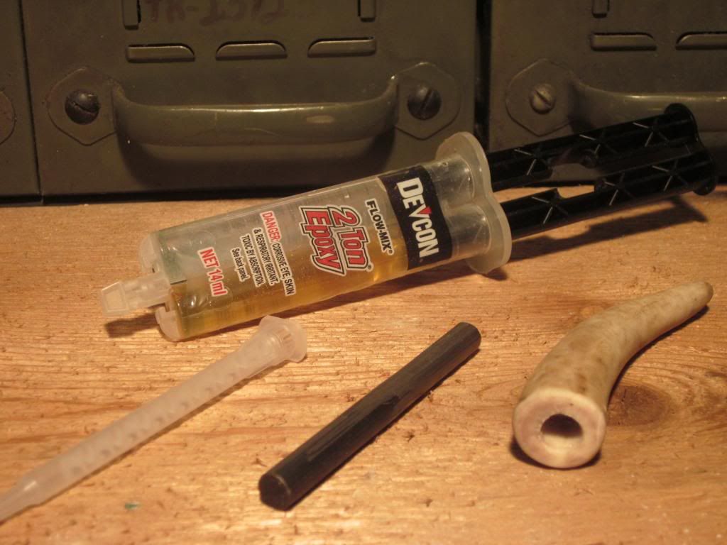

I got the old "mad scientist" epoxy syringe.
2 tons worth of GRIP!  Never coming off again!

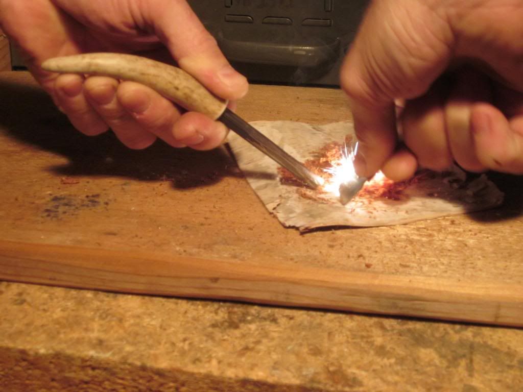

Time to give it the test!
Much better than the original!
This was my first time making a custom handle for my ferro rod and I'm quite pleased how it came out!  My only regret is that I waited so long to do this project (I've had the Ferro Rod for a few years now)...   :-[
I'm looking forward to seeing your custom handle!

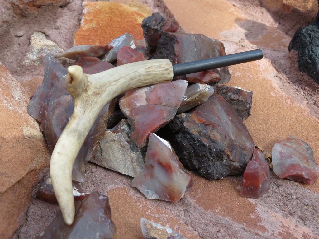

I've made a few along the way and I will post the ones that I have pictures of still.
Unfortunately that's the only photo I have right now. I will try to take a picture of a few more.

this is the last one I did (a while ago)... Have to give it a try again.
Very nice.....great work....Thanks for posting.
Re: Monthly Project - November 2013
« Reply #28 on: November 03, 2013, 06:05:17 PM »
+1
Is that burl wood Jontok?

Christian, do you have a vice for that drill press?....sorta gives me the willies seeing ya hold the antler in your hand like that......just saying.
BTW working with antler, drilling sanding or cutting in the basement is not advised if DW is having a Home Interiors party.....just speaking for past experience.....LOL
« Reply #30 on: November 03, 2013, 06:38:16 PM »
Christian, do you have a vice for that drill press?....sorta gives me the willies seeing ya hold the antler in your hand like that......just saying....
Vice? We don't need no stinkin' vice!  Real men can only count to 9, anyway. BTW, I found out the hard way what an "orbital sander" really was. Orbital velocity is a lot less than we've been told!
I do not...   :(
In hindsight I should have put a disclaimer to that image, maybe that wasn't the safest way to drill a hole in the antler.  However, I can assure you that my digits weren't in harms way, thanks for your concern though John.   ;)
