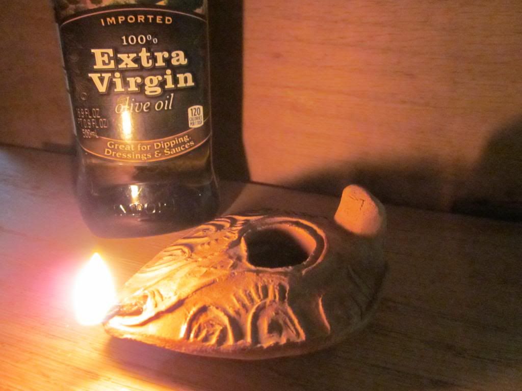

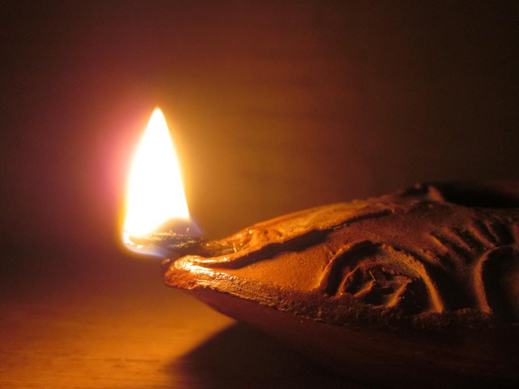

February 2014 Monthly Project will be to make a Lamp.
The lamp pictured as I said is just an example of what I'm getting at.  I didn't make this lamp I got in Israel many years ago I believe it's made of terracotta, I used olive oil as the fuel and a bit of hemp cordage for the wick.  The guidelines for this project are to make a lamp it can be out of any material you want,  any liquid fuel and any natural material as a wick.
It put's out a good amount of light and heat.
I decided on this as a project when I built my Quinzhee, small lamps like this are perfect for not only lighting in such a shelter but an excellent source for heat.  I'll be posting my intended lamp for this project soon hopefully!   :-[
Looking forward to seeing your Lamps!   :D

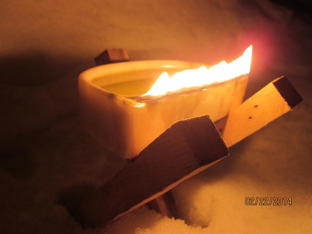

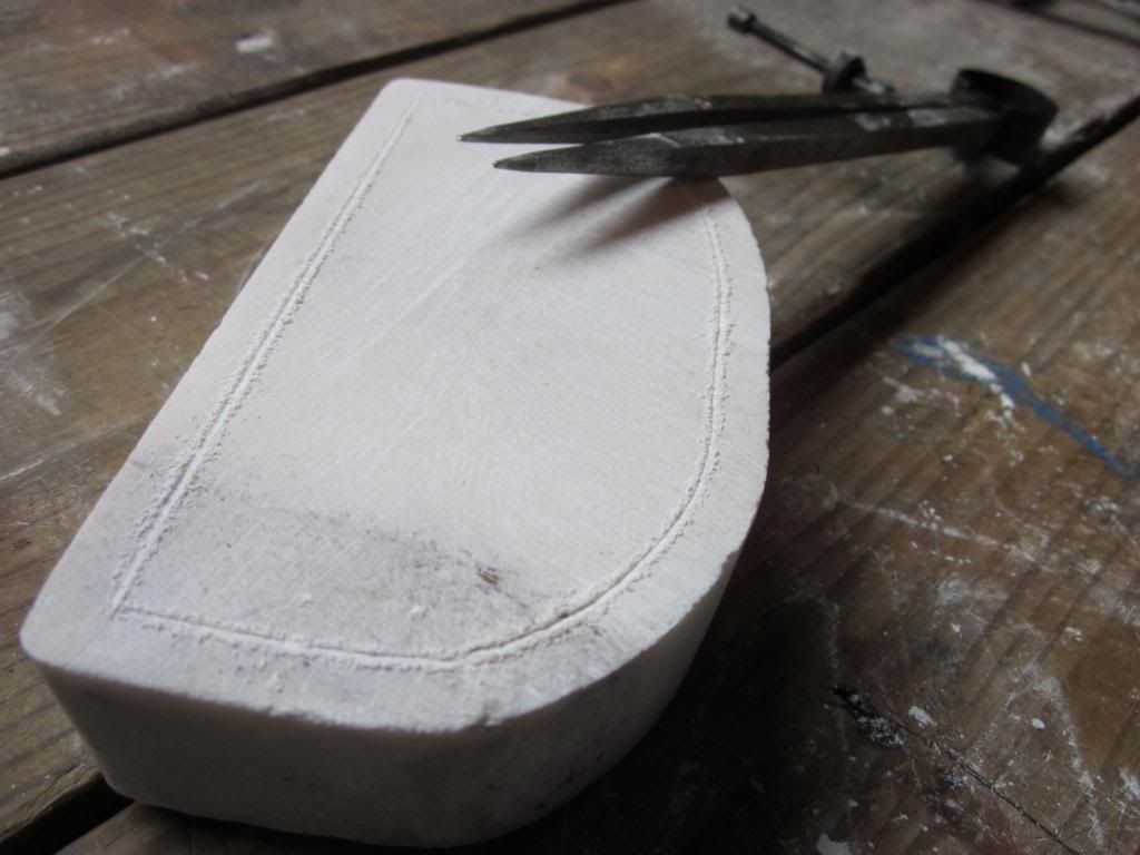

FINALLY, I finished my Lamp!

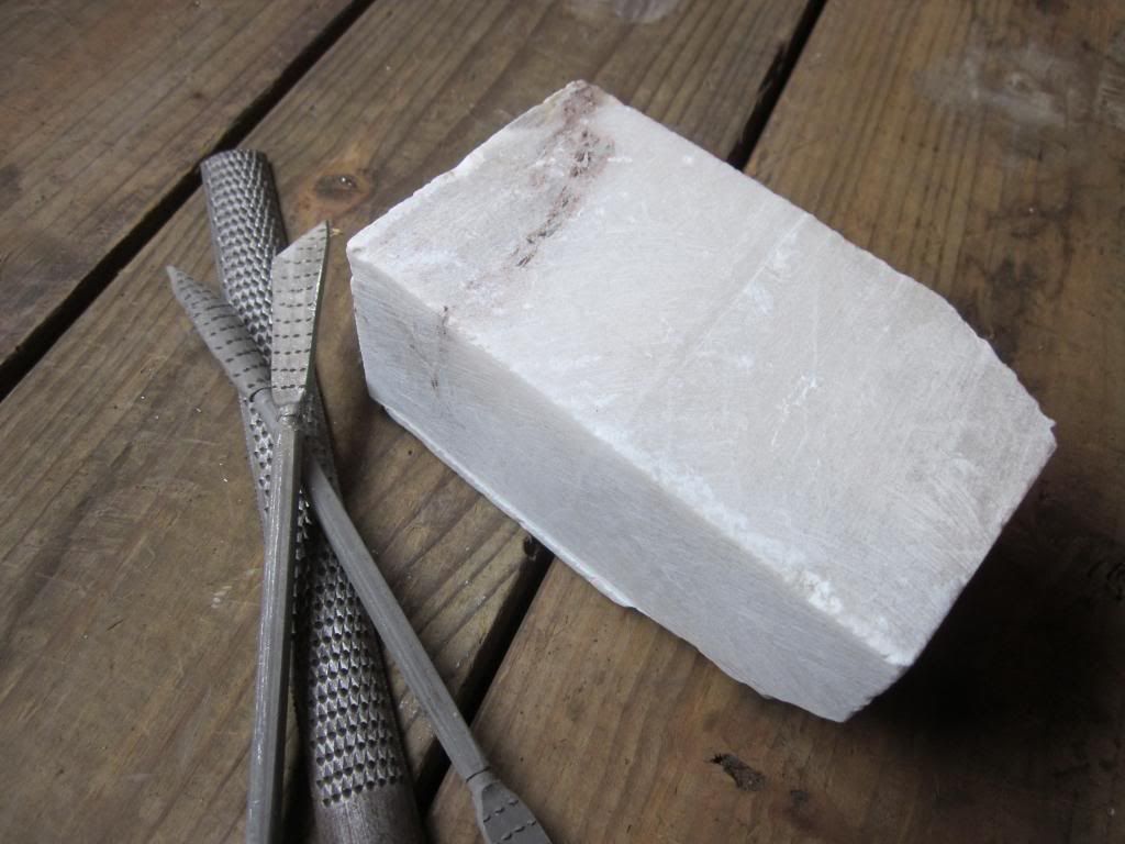

This has been a long time coming because the only time I could work on it was when the temperature out in my shop was tolerable, it was about 32 degrees F today so I committed to completing it.  A few weeks back I made a Quinzhee and I was toying with the idea of a traditional lamp that would not only illuminate my shelter but provide a decent amount of warmth so I set out to make a traditional Inuit Kudlik from a block of soapstone.  So I went out to the local craft store and purchased a small block of soapstone and some carving instruments.

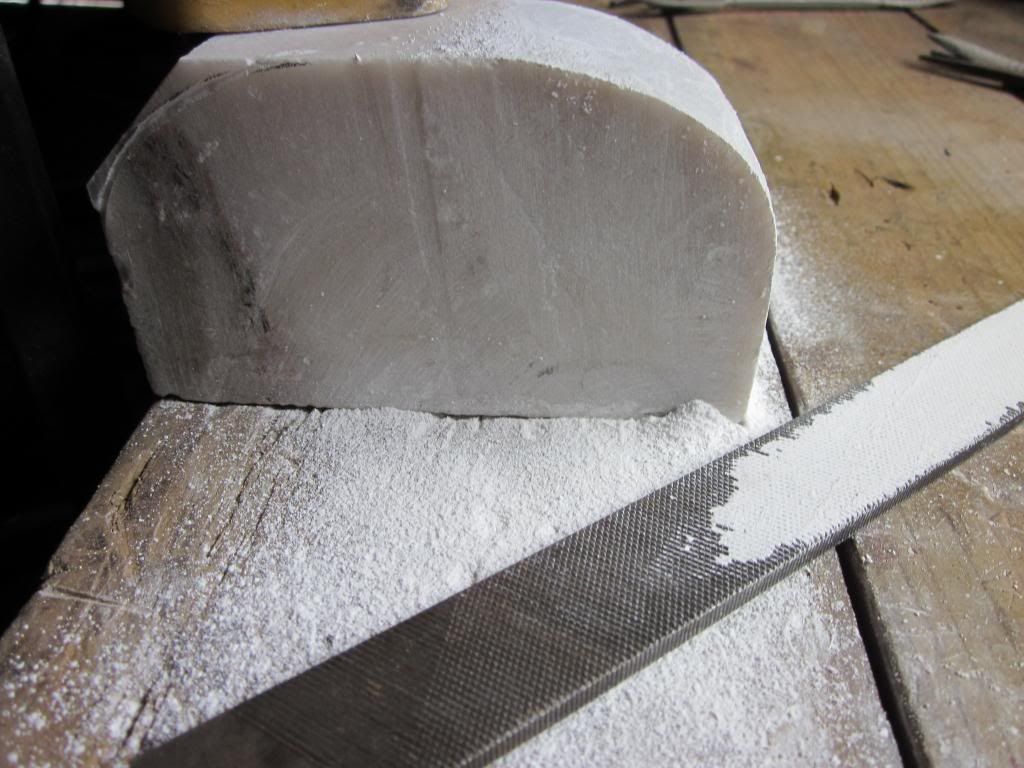

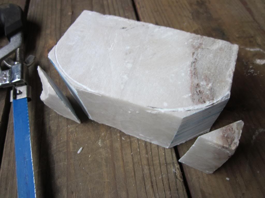

I began by shaping the block to a traditional shape which seems to be crescent-like (or D shaped) with a hack saw I trimmed the corners off.
Then I used a bastard file to smooth the cuts.

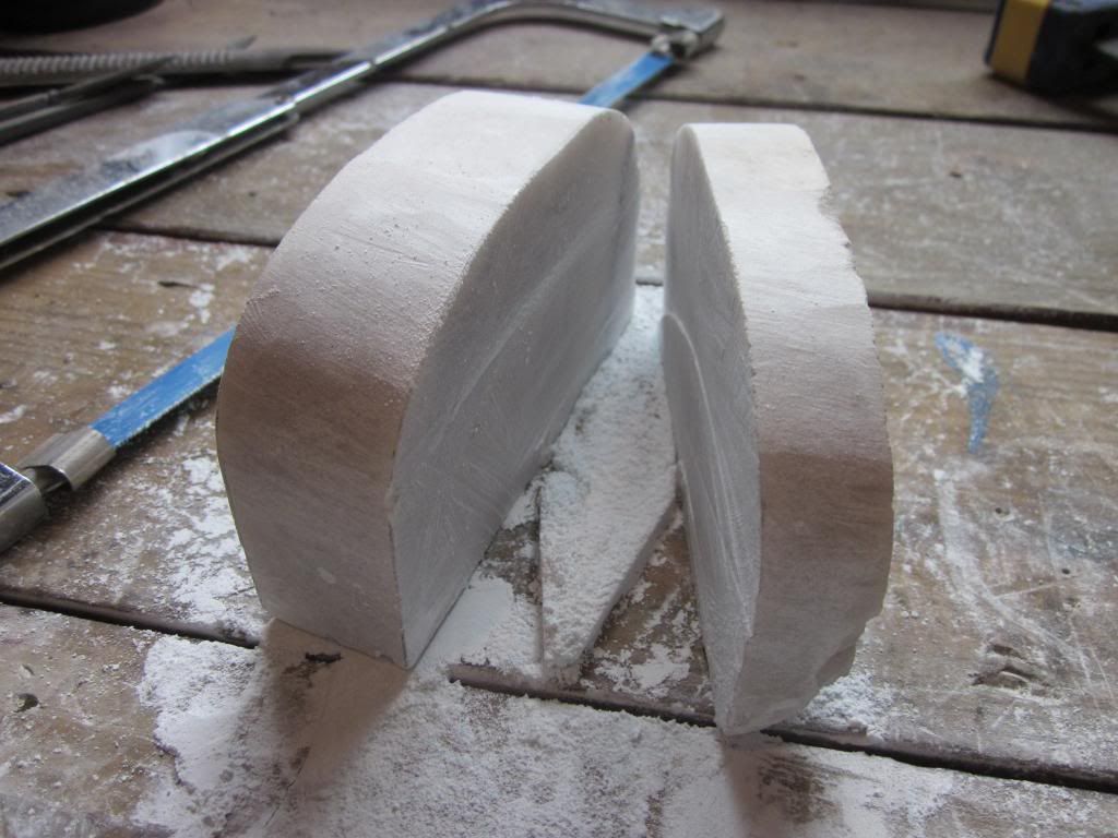

The block was a bit too thick so I cut a third of it off.
Then I scribed an outline with a compass for the reservoir to hold my oil.

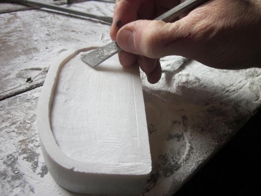

I used a varying array of metal implement to carve the reservoir out...  This process produced a lot of talcum like powder that got everywhere.

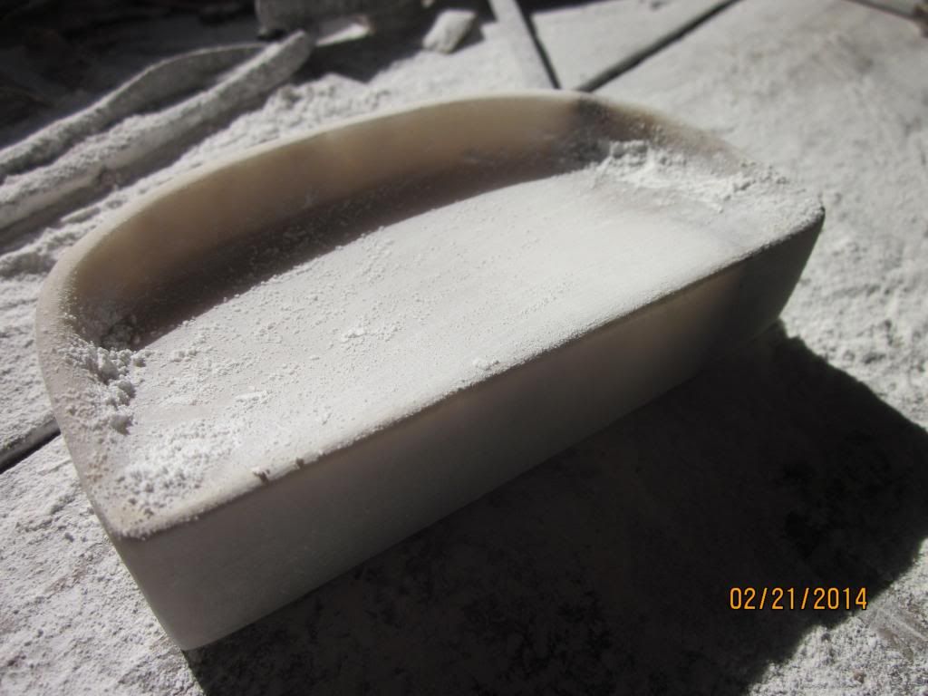

I finished the process this morning by smoothing the edges with varying grits of sand paper.

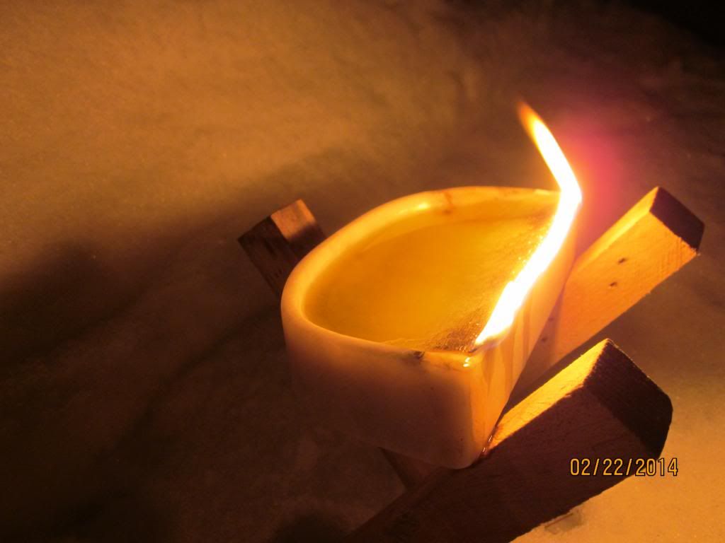

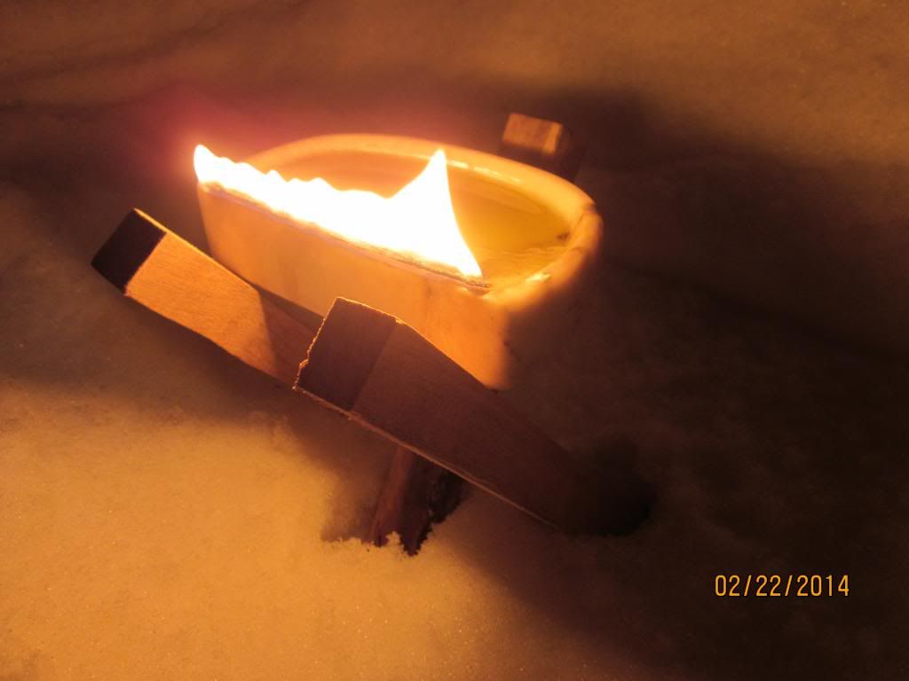

I didn't have any whale or seal blubber on hand so I used Extra Virgin Olive Oil as my fuel and a paper towel as my wick, traditionally Arctic Cottongrass or Moss was used.  I pounded a few wooden stakes into the snow to form a tripod to keep the Kudlik from melting the snow and spilling the oil.
I found it hard to believe that the Inuit would be able to not only heat their Igloo's but dry their cloths and brew up coffee, but after making a Kudlik and lighting it I can see this is a sufficient heat source.
I just love how the flames dance across the edge of the Kudlik, it's almost mesmerizing...
This has been a very rewarding project for me as I'm sure it has been for all of you who participated and shared this month.

Very nice, I gotta try that soapstone thing.
If you burn seal fat in that kudlik, it will really put out some heat. So hot you'll be sweating in a decent shelter. I stayed in a wikiup one night with a friend in colorado and he had one with a big chunk of seal or whale fat he got someplace...it nearly roasted us.

« Reply #21 on: February 23, 2014, 07:32:37 AM »
I'd love to get some whale or seal blubber to test it out but I don't know any guys that hunt seal or whale...   :(
Believe it or not this little Kudlik would probably raise the temp inside my one man Quinzhee too much and it'd be way too wet.  This is definitely sufficient to heat a larger two man shelter.  The heat output is so great I'm going to try to brew up some coffee over it...
