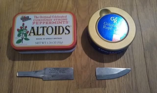

Not really self made so much as self-broken. Didn't really know where to put it but I guess you could stretch it to semi-made/repurposed.  ;D
The entire process consists of filleting and quartering an old knife. Shortening the tang and snapping the blade. File for smoothness. I use the tip as a small paleo type blade in my PSK. The rest can (and has/is) in use by folks as an altoids tin psk knife.

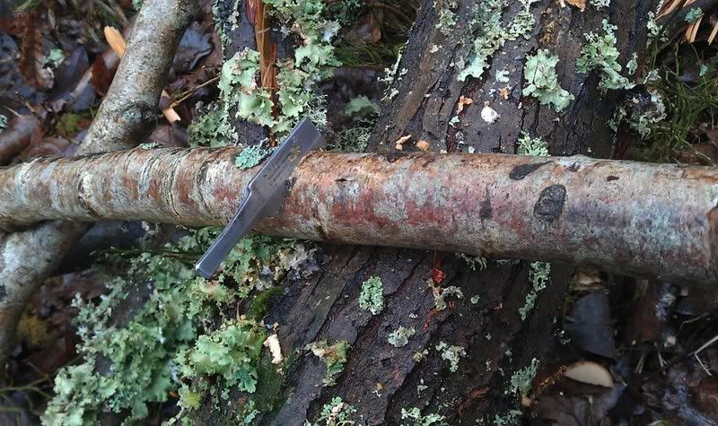

Get branch. In this case a downed birch lent me a limb. Get one that is comfortable to grip, and wet wood. Not dry. Dry wood cracks.
Baton like a pico beaver.

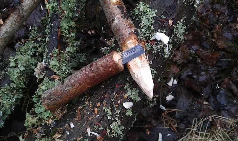

Snap, it broke! Now drive the shortened tang into the piece of wood by vigorous bashing.
And there you go. A finished knife, sort of.

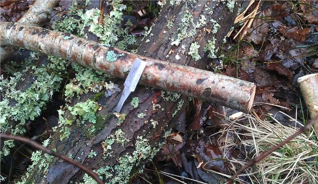

You get a small tip to use for notching, cleaning game etc. Not optimal but not terrible either.
Bashed the handle off after this little build.
And it packs up nicely inside one of those nifty tin cans.
This one came off of an old Mora "Scout" knife, the plastic handle was a real hoot to get off. I broke the tang off and filed it so it doesn't have sharp edges and is kind of wedge-ey. I then filed a "notch" in the blade where I wanted it to break and used the backside of my axe to snap it. Filed that down smooth as well.
Might not be for everybody but it solved a problem of mine while simultaneously getting me into the paleo-tool thinking again through a detour.

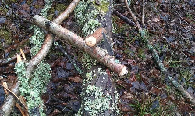

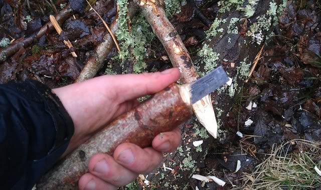

So I was asked by a friend how the heck I use a knife tip for anything but being miserable in my PSK. I took some pictures to show my basic thinking/and painful learning by doing behind it. Might as well add them as an addendum.
You can with a bit of effort procure a shorter handle even for this little nub of a knife. You could also grip tape the sides of the blade for better purchase.
Smacking the tip into the end of the stick gives you a semi-sturdy tool. During work I'd recommend frequently checking on it and giving it a smack once in a while to keep it driven in.
Driving it into a stick from the side will give you a bit of aid when procuring grass, reeds, twigs etc for cord making or eating.
Smacking it into a larger piece will give you a good splitter for the ever important cord making.
