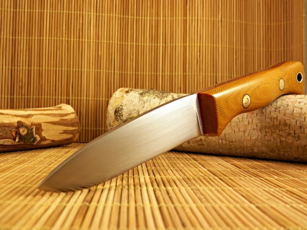

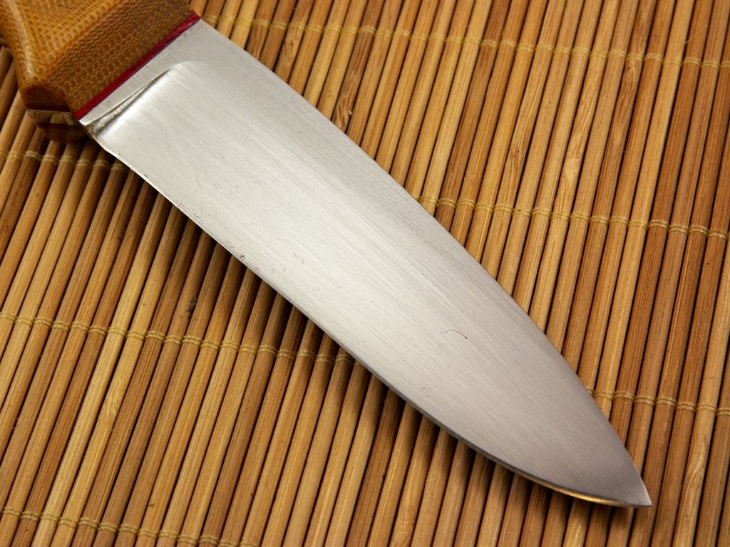

Well, this was a rather tricky build. OE wanted my old original woodie blade shape, with a 3/4 high convex grind. Definitely learned the limitations of my 2x42 grinder, and the additional 30" of belt on a 2x72 is definitely a must for that kind of grinding. Even removing the platen only gave me about 3" of slack, not nearly enough for what I needed to do. So I had to get creative, and this is the result..

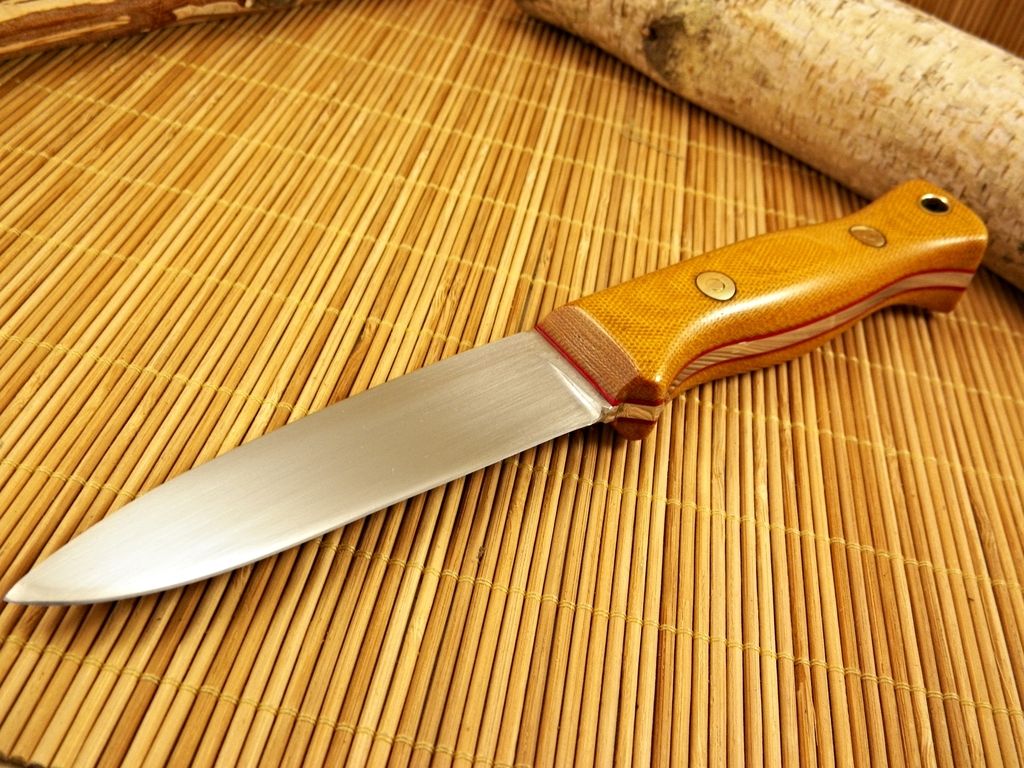

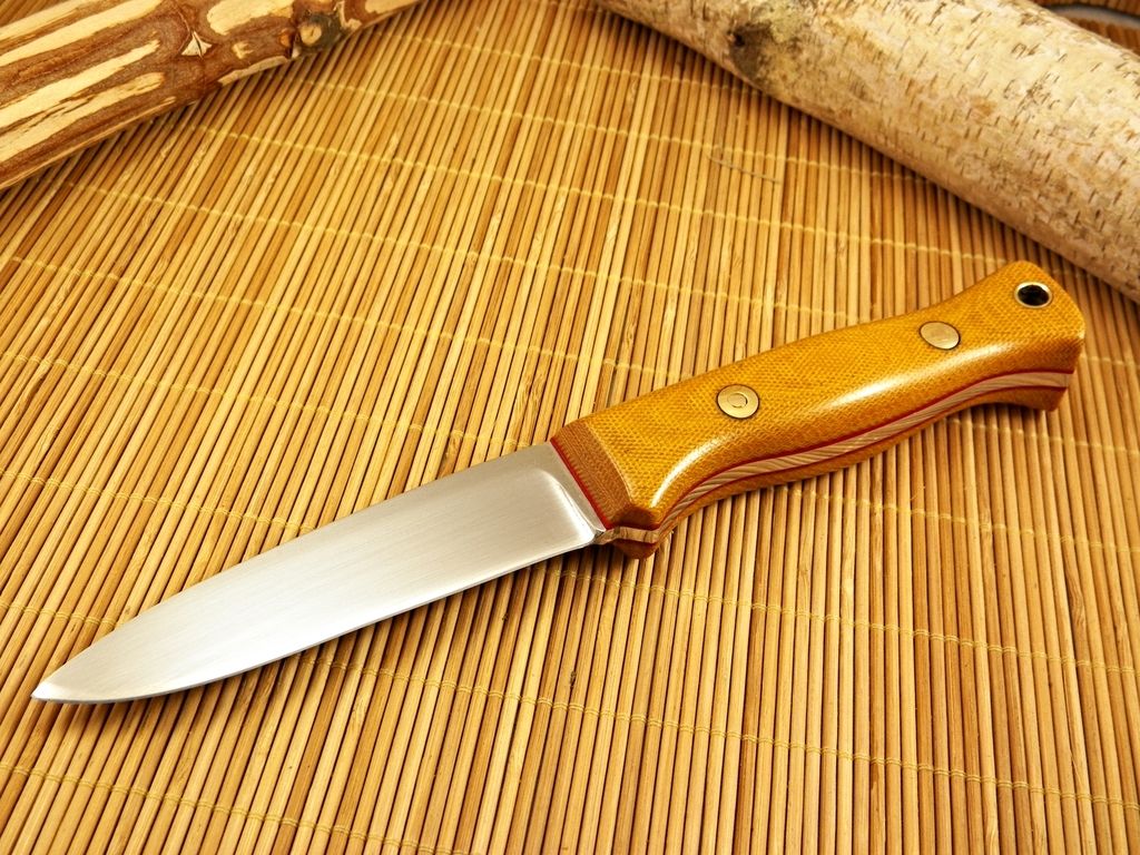

I also learned that on these lighter handle materials, I need to drill the loveless bolts to exact size. I always drill 1/32" over to give the glue room to set on the bolts and lanyard tube. It is clearly visible on this one, it looks like I burned the bolts. Totally not the case, just the glue being visible. Anyhow, I have updated him along the way, and he seems pretty happy about the outcome, so once he gets it in his hands he will either praise me or trash me lol :P

Hell, I'd just say I did the Loveless bolts that way on purpose!   I think it looks better to have them 'accented' the way you did it, with the light colored micarta......kind of sets the whole handle off a little more. :shrug:

I thought the exact same thing!  I think I'd rather see just a tad and know it's there, than lose it in the grinding process and not know it.   I think that looks great and will be a great user for sure!!  I also like the makers mark on the spine side, very nice addition!!
I'm curious now that you've made a few Red, how are you liking the convex, or should I say are you liking convex profiles more?

I don't like it at all, but that's mainly because my grinder makes it it very hard to do with such little slack. It would probably be the easiest grind to do given a 72" belt and 6" of slack to play with, but it becomes a real PITA on a little 2x42 with practically no slack.  I told OE today that I probably wouldn't try it again until I upgrade my grinder.
All that said, I still wouldn't use one, I am partial to my Sabre grind with a good secondary. Easy to sharpen, easy to maintain, and easy to get nicks and chips out. :thumbsup:

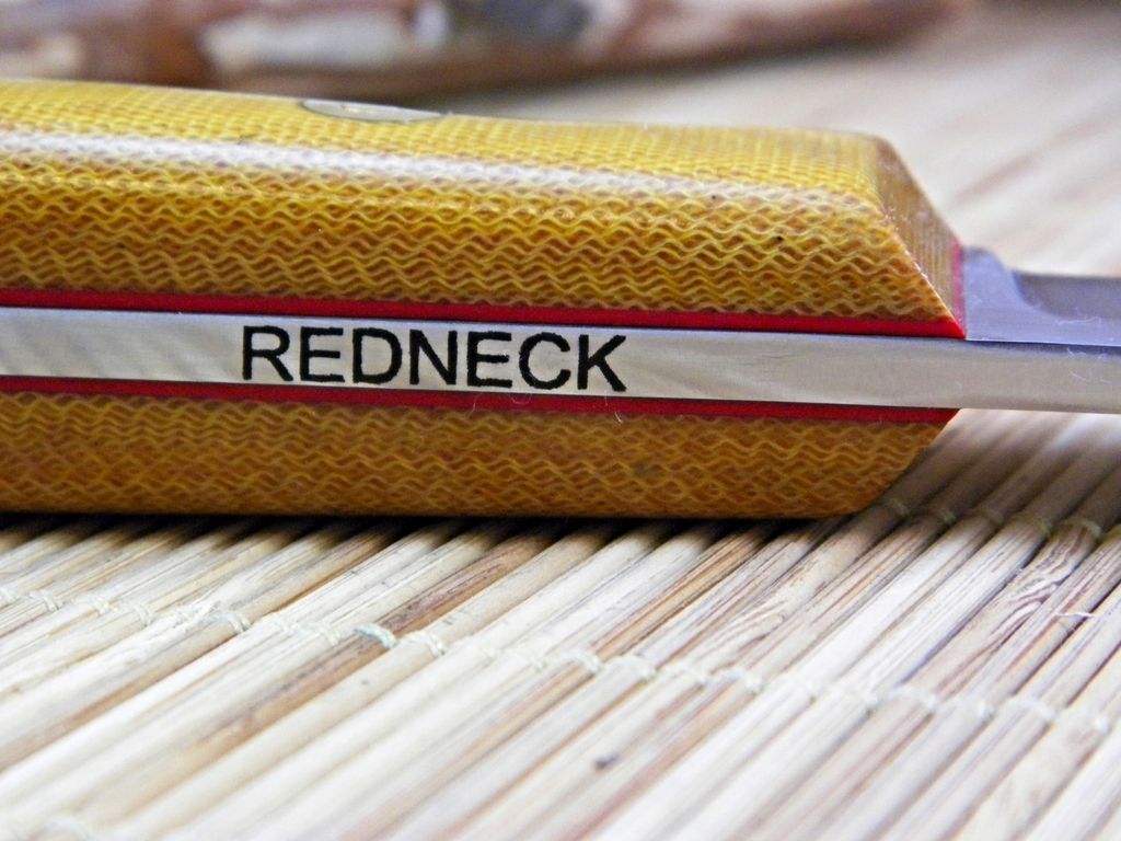

Are you changing your makers mark?
Re: Outdoor Envy's replacement..
« Reply #10 on: March 15, 2015, 09:48:00 PM »
Nope, he didn't want the profile etched, but still wanted the brand on it somewhere. So I did that :)

Awesome flat convex grind! :thumbsup:

Yeah, well, we all know that's^ a lie! It's amazing, Red! :hail: I honestly wouldn't have even paid attention to the bolts if you hadn't of mentioned it. Every knife I've tried to make (or put handles on) have the same thing happening with the pins.

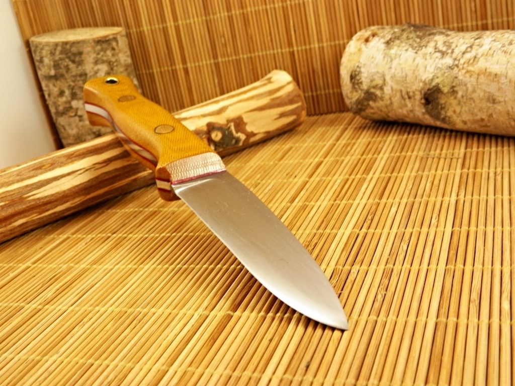

Got it in and it is just what I wanted!  Red did a great job on getting the handle shaping and thickness to be spot on for what I wanted.  The grind was really good too for improvising, however he decided to get it done.  I hope he kept the cursing me to a minimum as he did it!  LOL!   Well all and all I am one happy customer.  This was fun to do with him and the end result is really something to be proud of.  Well I ran outside and messed with it for about an hour.  Here's a couple shots of some curls.  More to come from future outing threads...
