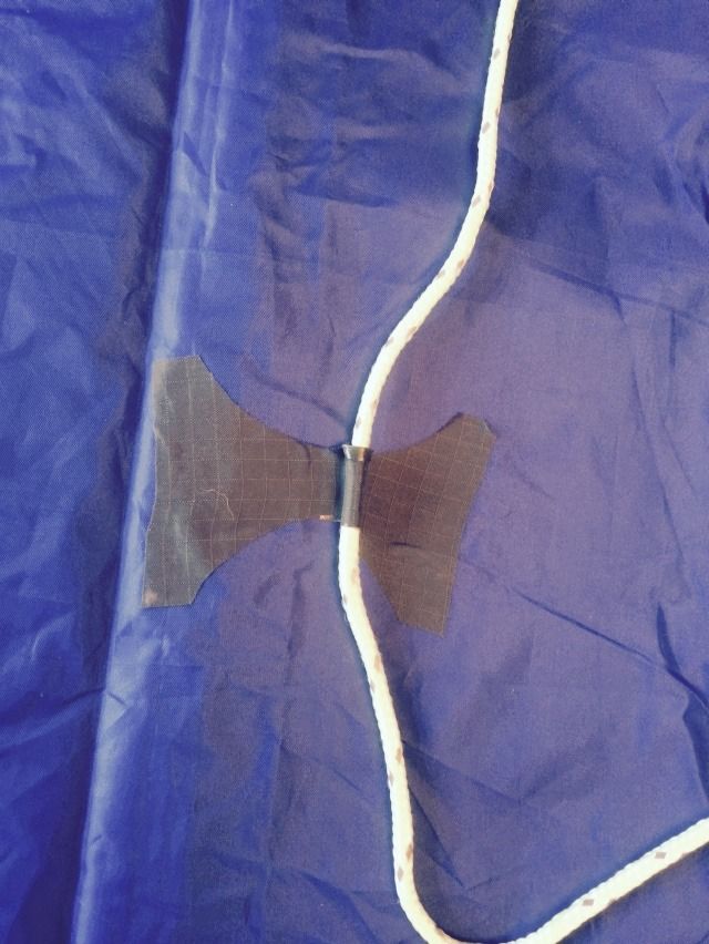

I am using a sample from wilderbeast of this sticky backed nylon repair. The thread is here.
http://bladesandbushlore.com/index.php?topic=11657.0

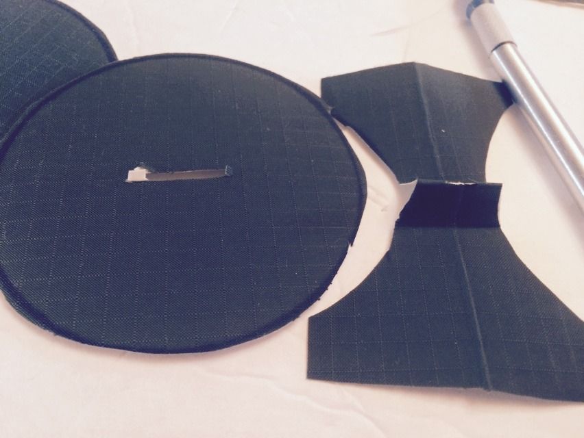

I cut a big circle and a 'butterfly" patch.
 I stuck a square of nylon to the center so the cord didn't stick to the loop. Then I stuck the butterfly patch down on my tarp and put the big circle over it for reinforcement.
 Not sure it's going to hold. I wanted to put a piece of pvc or maybe a small section from a Bic pen under it for strength but worried about the wear through my tarp over time. An suggestion for better reinforcement? Maybe a butterfly small plastic milk just piece with the patch over it ?
This is just a tie out to keep the tarp spread open a little after it's set up. There shouldn't be a lot of stress on it.

I just want to add an update. I thought the loop would tear out. It didn't even in the strong winds. The adhesive let go, The whole thing just came off the tarp.
I think it's because I handled it too much trying to get it situated in place. I also think the waterproofing of the walmart tarp may have been a factor.
For the record I'm surprised that tiny loop didn't tear. The thing was beating around pretty good and it held well.
