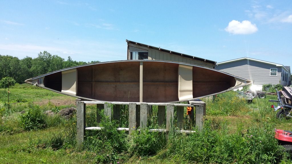

I want to canoe camp and sail. Maybe a 5 day trip.  I would like some help with the setup and packing.
My canoe has a very small 3/8" square aluminum gunwhale. This makes it hard to attach anything. I will need to change this to maybe a furring strip. Along the inside edge stainless screwed and epoxied on, just inside and under the aluminum.

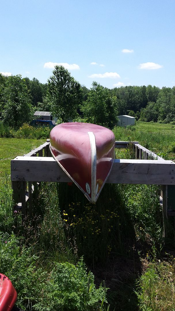

Here is an idea I found and thought it would be a great addition to storage and stability. I wonder if it would act keel like to prevent going in circles?
I would like to sew a silnylon tarp that fits the canoe, that I could prop up enough along the center to sleep inside. Maybe snap or velcro to the side. It's 3.5 feet wide 15 feet long and has a load capacity of 700 lbs. I have options...
That wooden pallet is my wooden rack for the truck. it's 8' long

Really curious about packing. keeping the dry bags inside in a roll. If you look at the inside bottom of mine it has reinforcement ridges. Going to make sleeping a bit difficult.
Maybe I can lay a piece of Luan on foam for a secondary floor?
