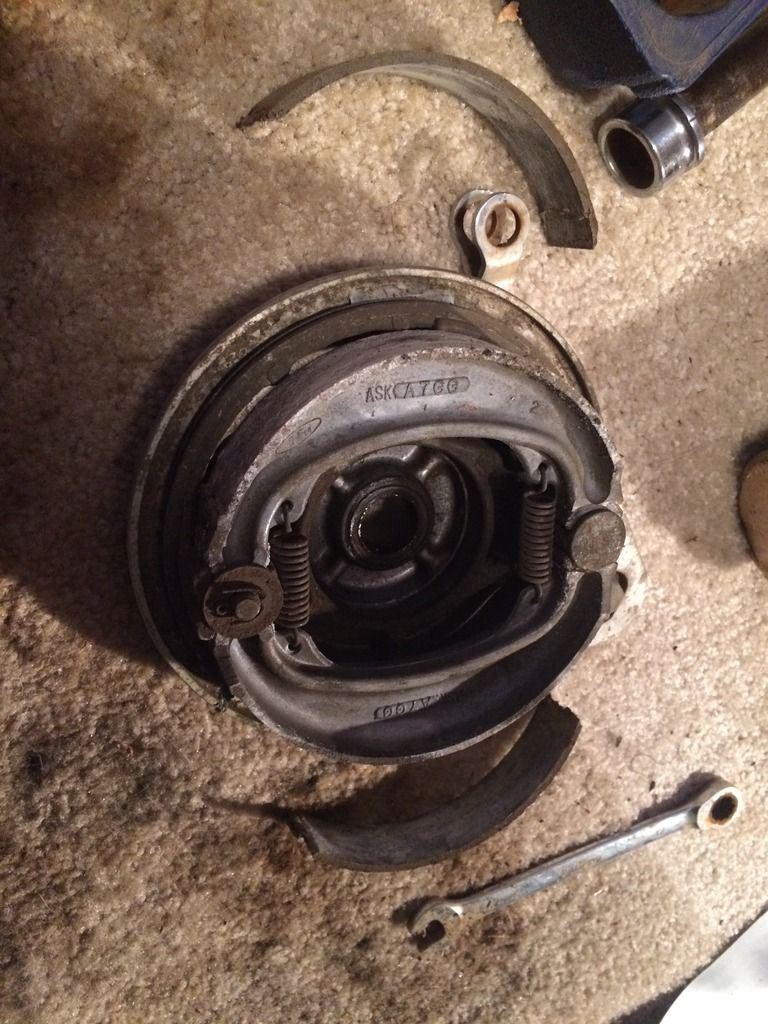

After pulling the rear wheel to replace the tire I found the brake shoes had fallen off the backing plate. I had suspicions that the pads were wore down and bought replacements. Good thing too. I had to clean the bore and shaft of the pivot. It was tight and corroded. I put 2000 grit in a slotted dowel in my drill and honed the bore. then hand sanded the shaft. Added a little grease and all good for another 45 years!
With the wheel off I decided to remove and clean the rear fender. I found the two metal support brackets to be very rusted. I didn't want to do a restore on this but I couldn't put it back together with that much rust.
Evapo-rust is an amazing product. 10 hours soaking and the rust was gone. You can see some pitting from the rust damage but there is no rust to return. I gave it a quick paint from left over purple that we used on the hillbilly hotrod. These two parts are not easily seen once it's back together. I just wanted it to be protected from future rusting.
Now The new tire and brakes are done. once the paint dries the fender will go back together along with the wheel.

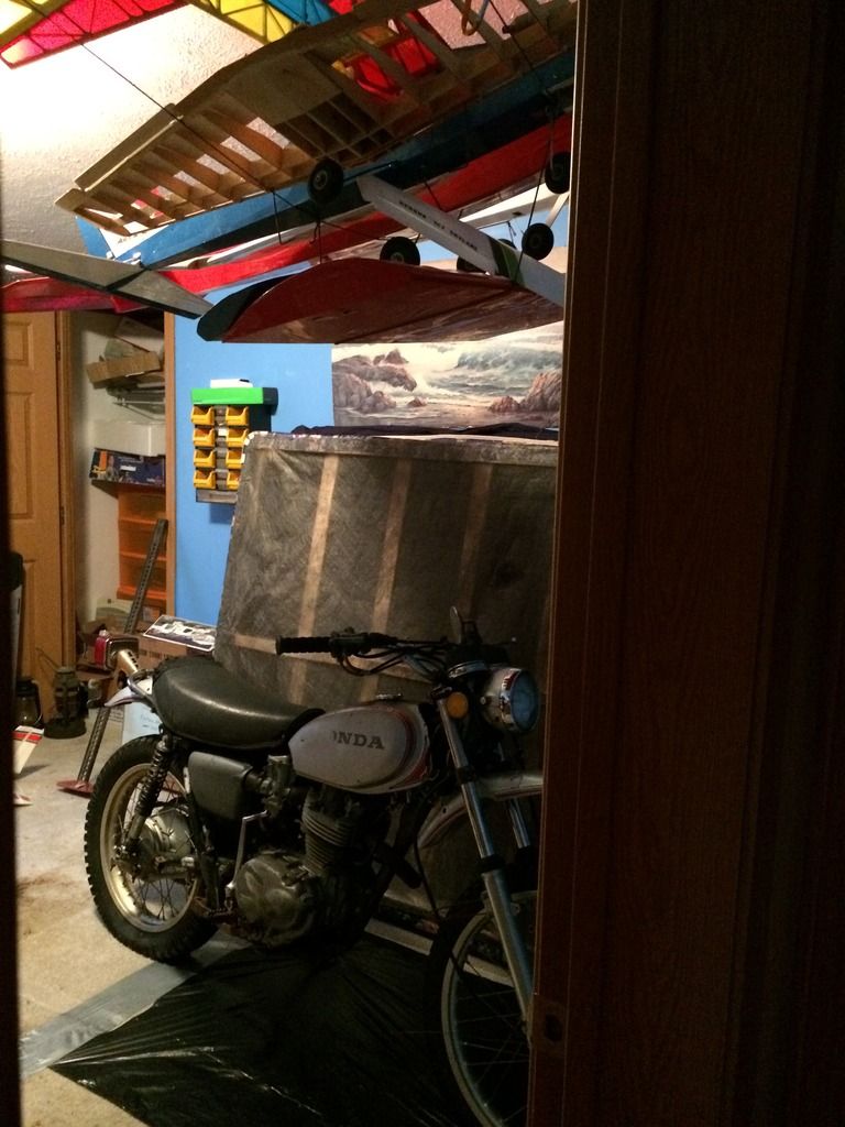

The first thing that caught my eye was the airplanes in the first pic.  Heck, you could start  topic on just those.  Really looking forward to seeing your progress on the bike.  I have a friend that is really into the old Hondas.
  • Posts: 2189
Re: 1972 Honda XL250 Freshen up(pic heavy)
« Reply #2 on: January 02, 2017, 12:22:15 PM »
I did a long time ago. Changed a lot of planes since then.
http://bladesandbushlore.com/index.php?topic=8217.0
Keep original paint with natural wear and patina or repaint to a royal blue?
i kind of think a paint job would make it less identifiable as a collectable XL250. This one was built in January 1972. First year and first month of production. serial ends in 1948. Is it the almost 2000th bike built?
