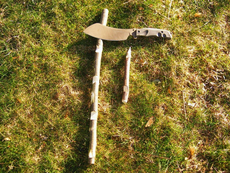

My typical MO is to make half a dozen tent pegs and at least two try stick but given all the repair and cleanup work I did that day it was only one peg and a single try stick.  This is the only picture I took, which was after I got home and not in the woods:

It is a good review of a knife that I wouldn't buy. The text was interesting enough to me to read it all and either more photos or a video of the knife in use would make it even better.
