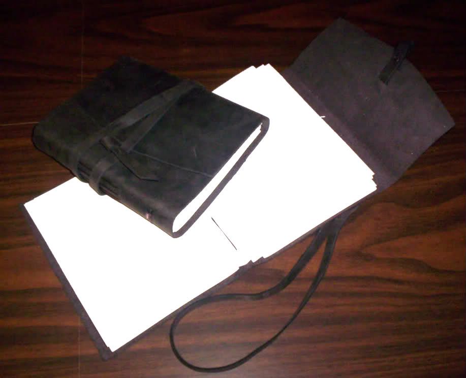

So I've been making these journals for a while now. I had this posted on another board so I figured I'd share it with my B&B buddies.
Here?s how to make it!

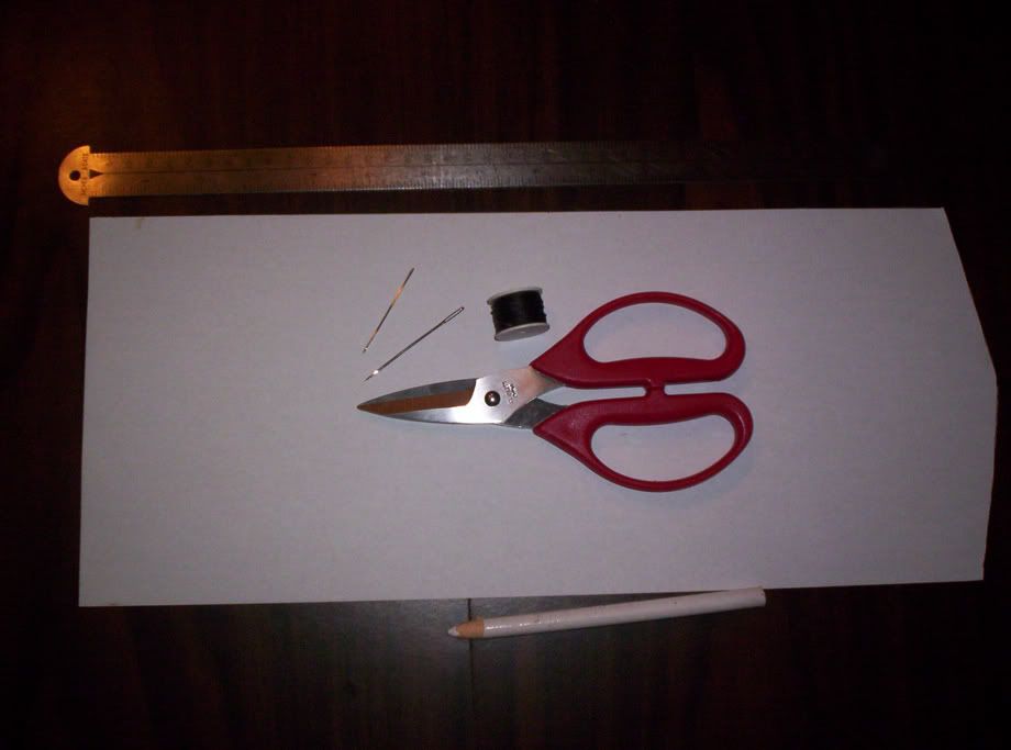

These are the tools you?ll need. Not shown is an awl. You really do need one of these but If you?re a tough one you might get by with a needle. I also used a strap cutter but the scissors will work if needed. Shown are my pattern (make one of these before any leather cutting), scissors, a straight edge (I went old school and busted out my line gauge), marking tool (this is a china marker but a chalk stick would work too), 2 needles and thread.

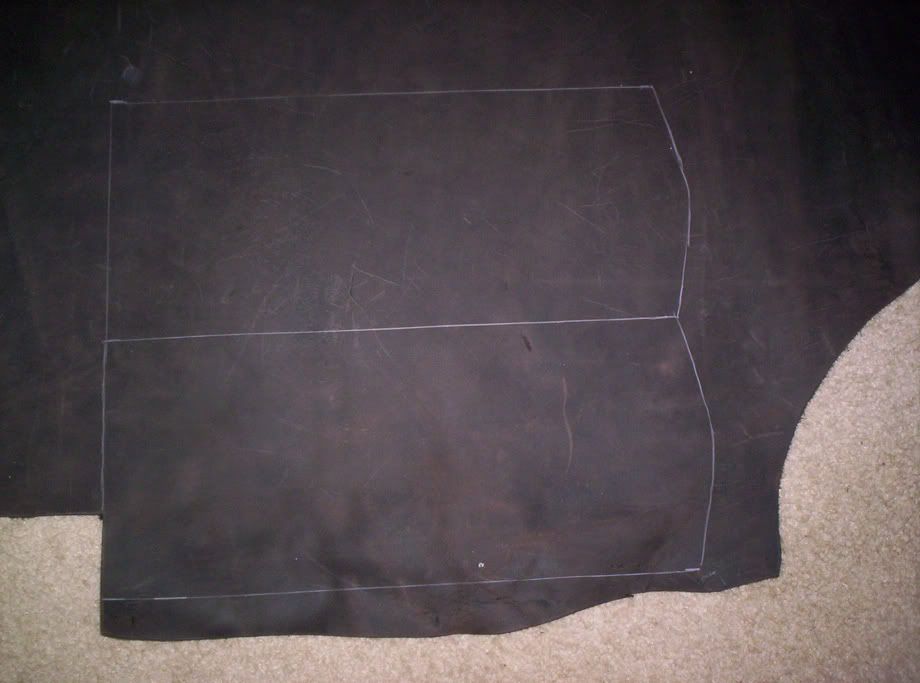

Trace out your pattern onto the leather. Notice there is a square side and a rounded side.
Cut it out. I had the paper for two so I cut two out. You?ll only need one. Since this is thinner leather I?m able to use scissors to cut it. You?ll also need a strap roughly 3/8? wide and roughly 3 feet long. You?ll need it long enough to wrap around the finished journal about 3 times. I highly recommend a strap cutter but you can use the scissors or a really sharp knife with a straight edge if you don?t have one.

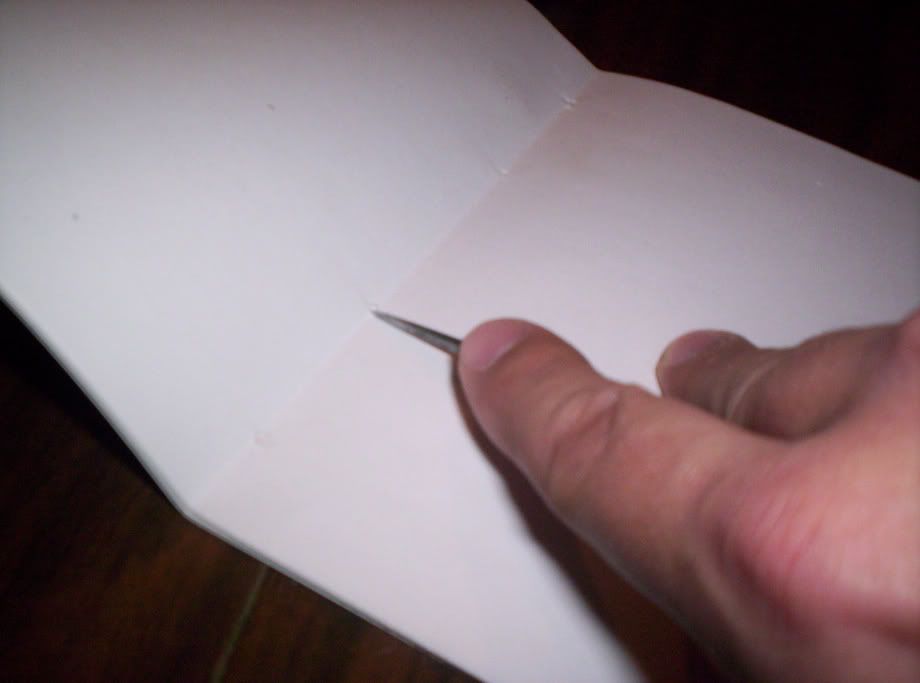

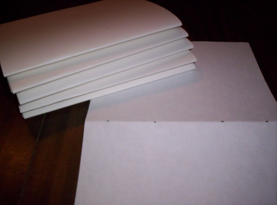

For these journals I?ve used five sections of ten sheets folded in half. I used an extra sheet and marked the four holes I need to punch in my paper. You can measure these but I usually just eyeball them.

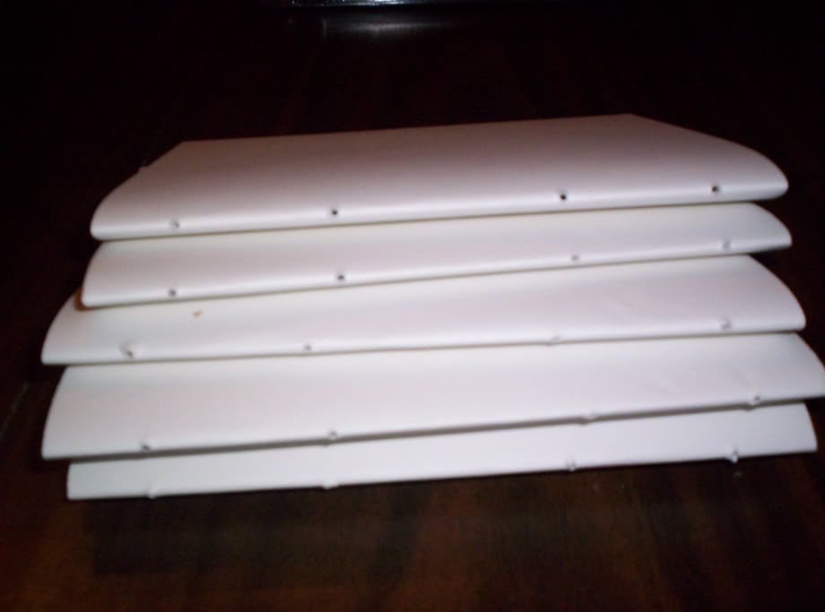

I set the extra paper in the middle fold of each section and punch the holes through.
All five sections. Note: If you decide to add more sections to your project, make sure they are an odd number. 5 sections, 7 sections etc. I?ll explain this later.

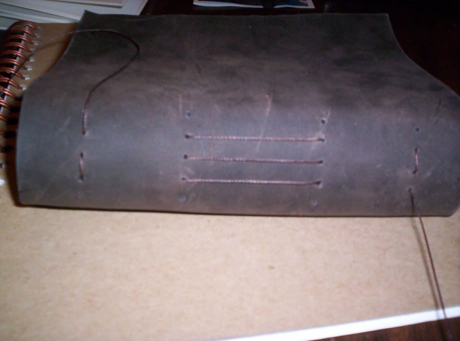

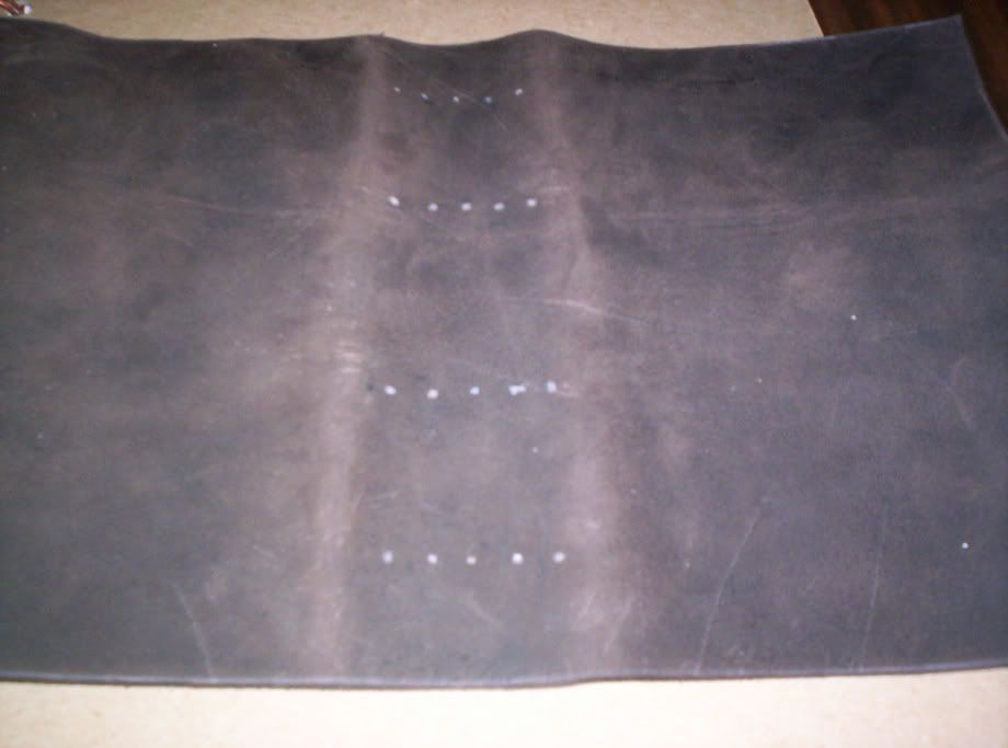

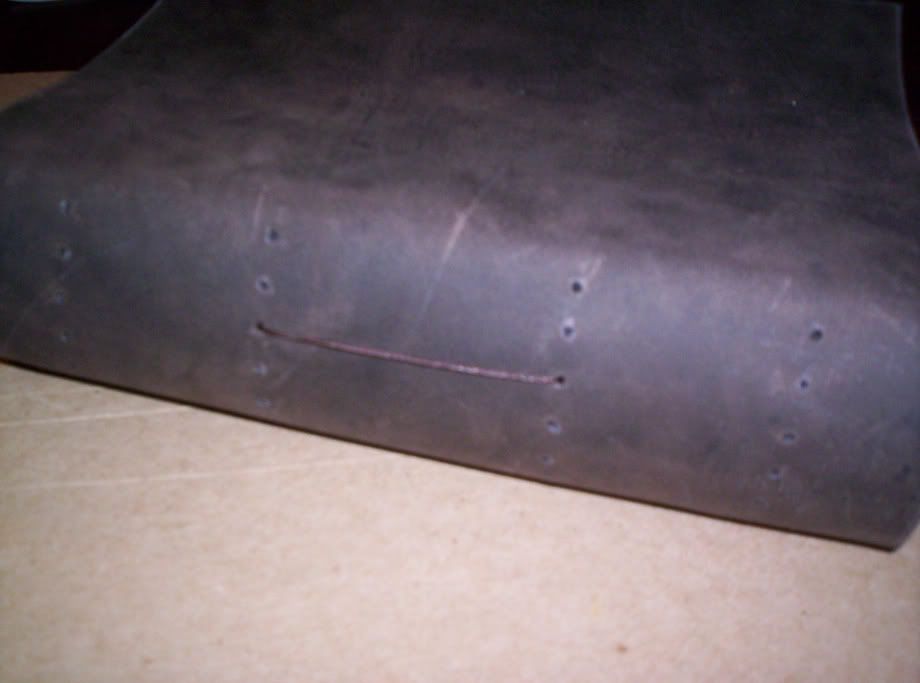

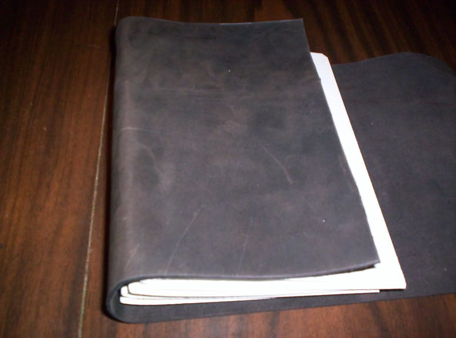

Once the sections have their holes punched stack them on the leather and wrap the square end over them with the finished side outward. The edge of the squared side should come over the top but not completely. Make sure the rounded edge can wrap around over the squared end. This would be a good time to make a template from scratch. Use a large sheet of paper before you start chopping up good leather. I like to kinda fold the leather here so it slightly takes the form of the spine.
Next I like to mark the holes to stitch the pages onto the leather. Use your template from earlier as a guide. I again, kinda eyeball this too. I also like to punch all the holes after I?ve marked them. You might have to open them back up with the awl as you go but it makes it easier to I think.

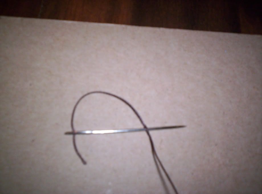

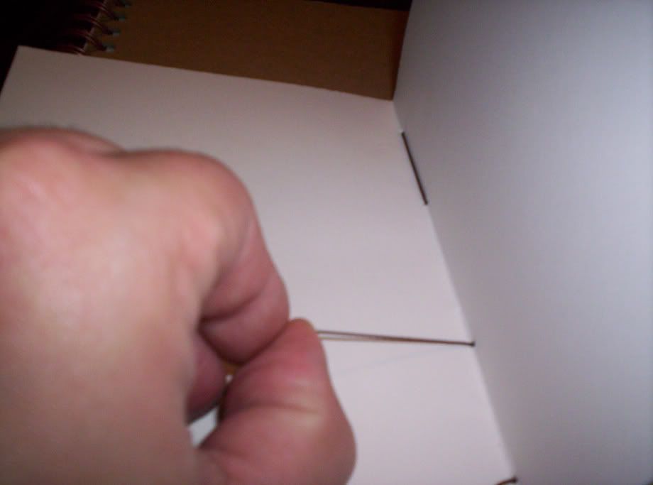

Grab your thread and needles. You?ll need about 6 lengths of the spine. I usually ad an extra as I find it?s a huge PIA to splice thread. Thread each end of the thread with a needle. First run it thru the eye and then pierce the thread with the tip. Pull through to lock the thread.

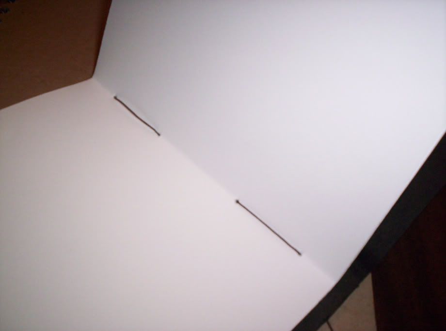

From the outside, run the needles into the two middle holes of the middle section. The need for a ?middle section? is why you need odd numbers of sections.
Run the two needles through the middle holes and out the outer holes.
Now run one needle to through the outer hole in the next section and the other needle through the previous section. Don?t worry about tightening this too much right now. I always have to tighten mine when they are all in.
Attached the pages in these sections by going through the outer holes and back out the middle hole then back through the other middle hole and out the other outer hole.

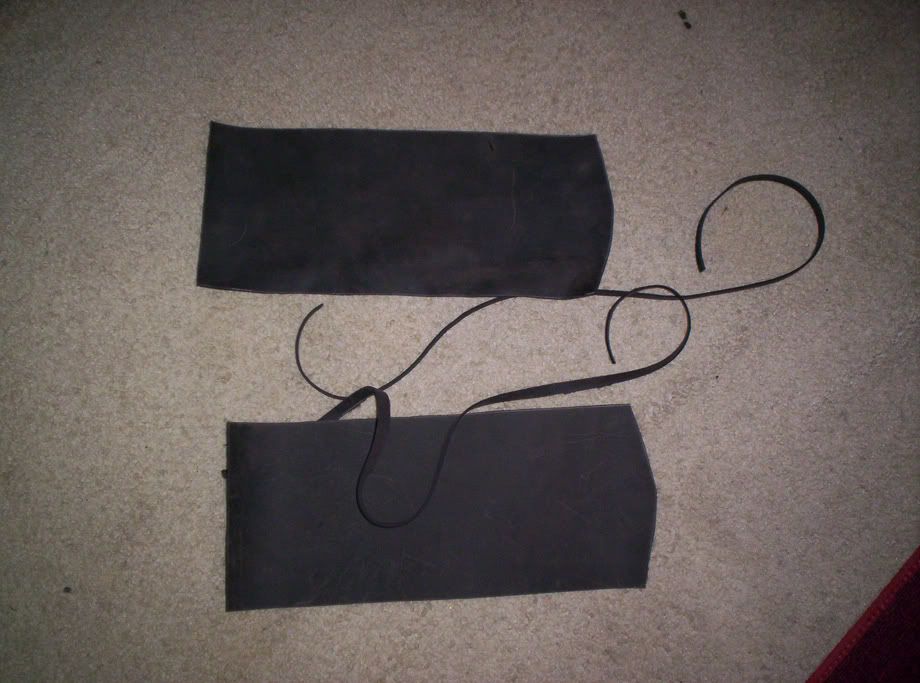

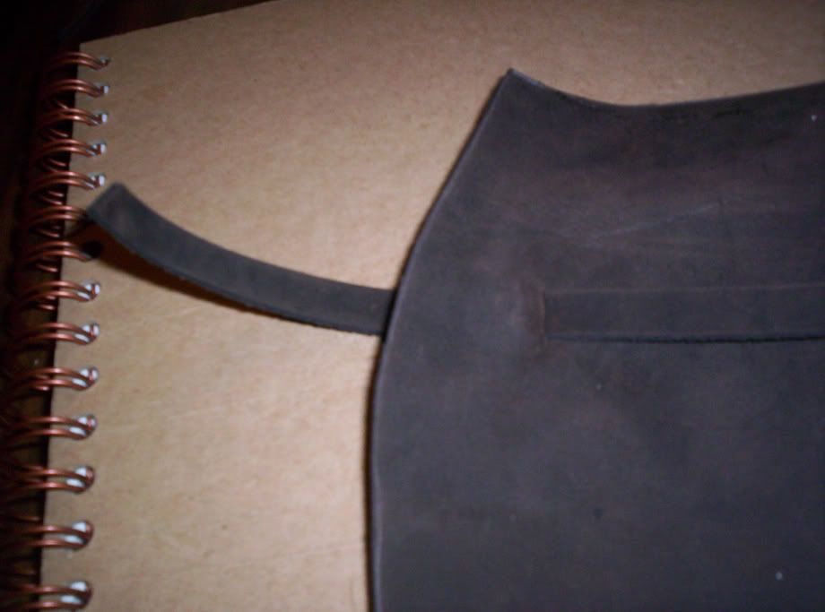

Now cut a slit in the rounded end big enough to run the strap through.
Make a loop that the other end can slide through snugly. I used a rivet for this one but you can stitch it as well.
That?s it!
