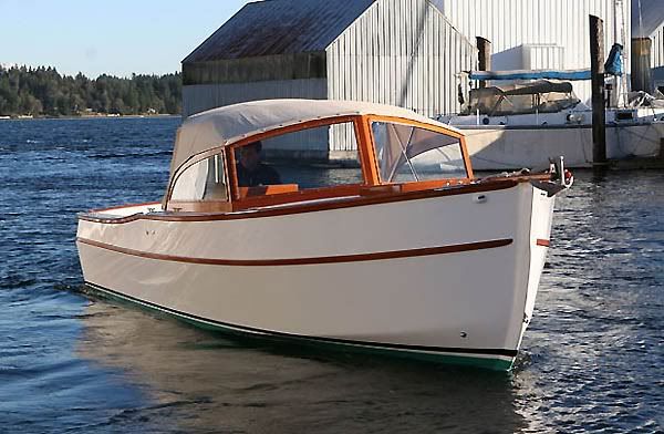

SwampHanger, I surely understand that way of thinking. Actually I admire it. The only thing I'd ever heard derogatory about standard US Plywood for boat building is voids ( those football shaped plugs ) are only filled on surface laminations, those on the interior are not. Doesn't mean you won't get plenty of years of use out of it. I read too much.
Sam Devlin does nice work with plywood and swears by wood in boat building, what your doing is making a full sized model that is practical and fully functional and if you ever decide to do another, like you said, you'll know what to look for and have some material and technical knowledge. Very cool.
One of Devlin's little stitch and glue boats.
