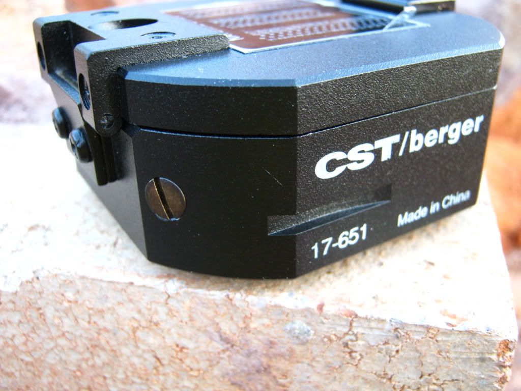

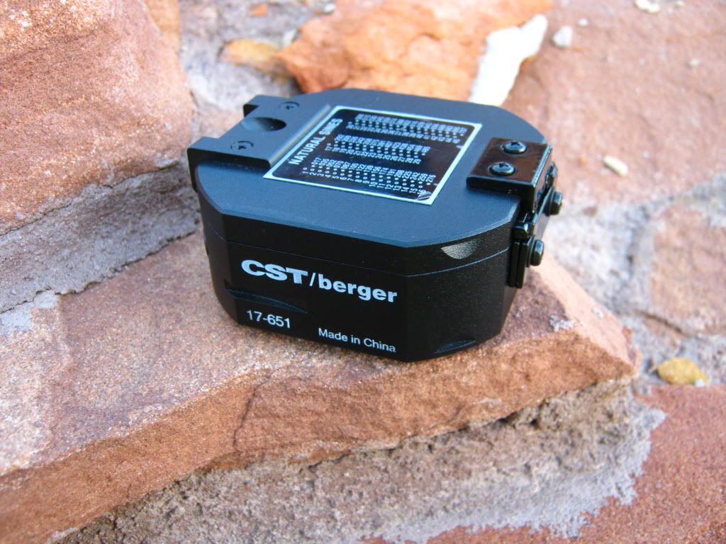

Well as those of you who have been following the TOKT news thread know, I have been trying to locate some property corners at the new house. Anyhow, I decided a pocket transit would be a big help in finding them since I can get reasonably accurate bearings using one.
Anyhow, I decided to try a couple of different lower priced options than the $300 + Brunton pocket transit models. This CST Berger transit came in at $116 shipped from Amazon with my Prime membership.
CST Berger Pocket Transit
I also ordered a Brunton ball and socket tripod mount to allow the transit to mount to a tripod.

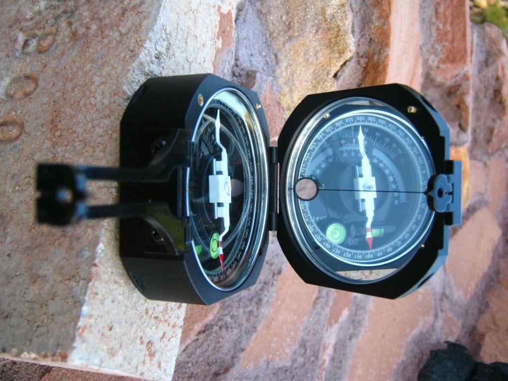

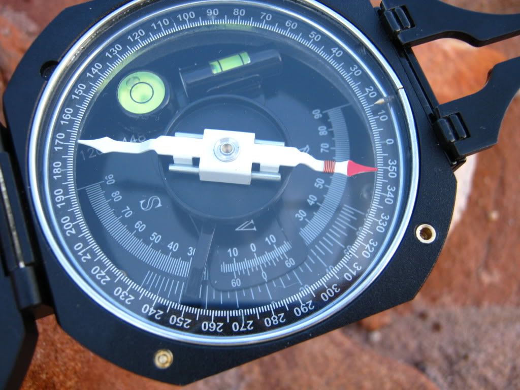

Anyhow, the transit arrived and was plagued with problems from the beginning. First and most obvious, the south end of the needle was painted red rather than the north end. This is presumably because the manufacturer assumes it will be used as a prismatic compass more than a transit. When using a pocket transit like this as a prismatic compass, you read the azimuth from the south end of the needle, which could be why they chose to paint it red. However for other modes of use you read the azimuth from the north end of the needle. In any case it's an easy fix with nail polish if you decide to do so.
the other problems with the compass were the bullseye level bubble was not installed properly. When the compass was resting on a level surface, the bubble was not centered. And finally the needle, graduated ring, or pivot were misaligned. This caused a situation where the South end of the needle would point to 180 when the North end was at 0, but when you turn the compass around so that the south end was pointing to 0, the north end was a few degrees off of 180.
Anyhow after messing with it for a couple of days I decided to return it and see if a replacement would be any better. The replacement came quickly (Yay Amazon!) and it is apparently much better. The needle reversal error the first one had is no worse than 1/2 of a degree (30 minutes of angle). This is satisfactory for my purposes. Neither compass came with a good instruction manual. Manuals for the Bruntons can be downloaded and since this is a copy, most of the operations will be identical.

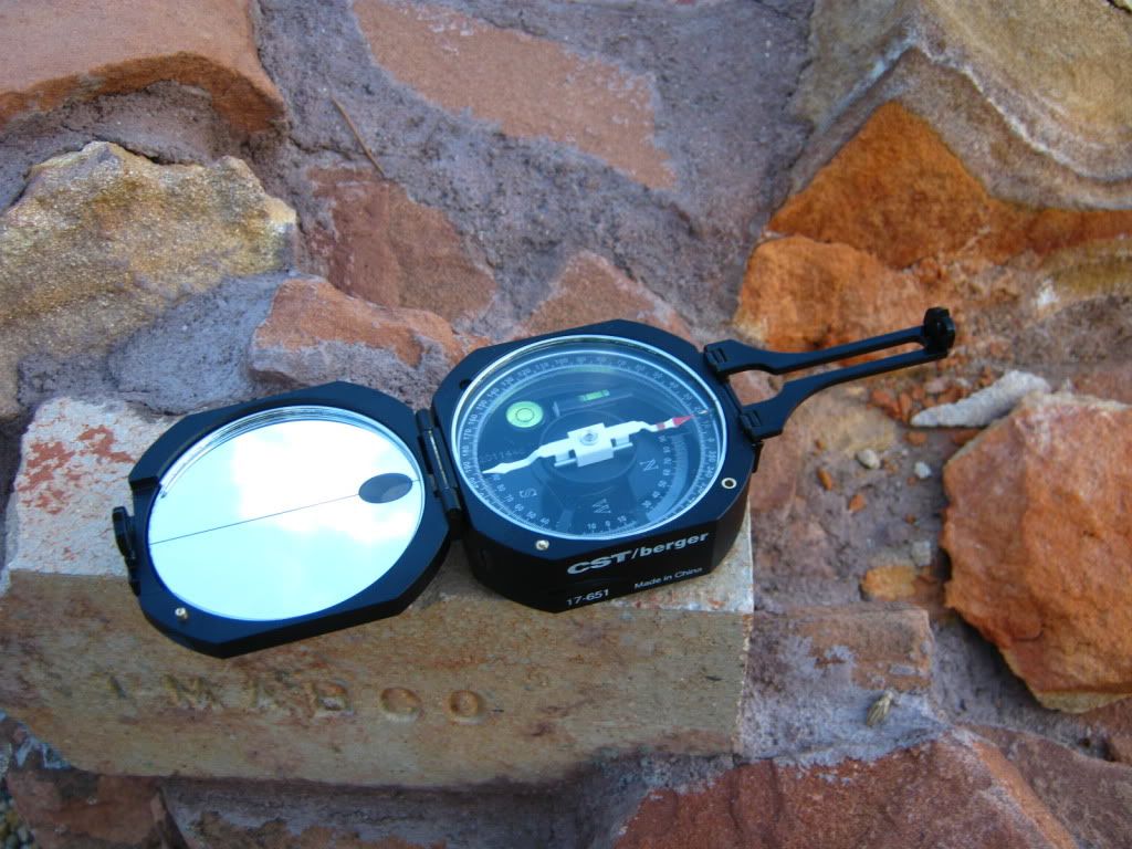

The Brunton ball and socket mount is a bit loose on both the first one and the replacement. The slots on the sides of the body for the mount are not cut to the same dimensions as a Brunton so you need to shim them with a couple of pieces of thin cardboard to get a firm mounting.
The needles are balanced for the northern hemisphere and are induction damped. It appears to have two AlNiCo magnets glued into clips on either side of the needle.
In short, the new compass is probably a good deal for someone who wants an affordable option at about 1/3 to 1/4 the price of the real thing. But it's anyone's guess as to whether they will get a good one or a lemon. My suggestion is to buy from a place like Amazon that makes returns easy so that you can send it back for replacement in case it doesn't work right, and make sure to check it out thoroughly when you get it.
