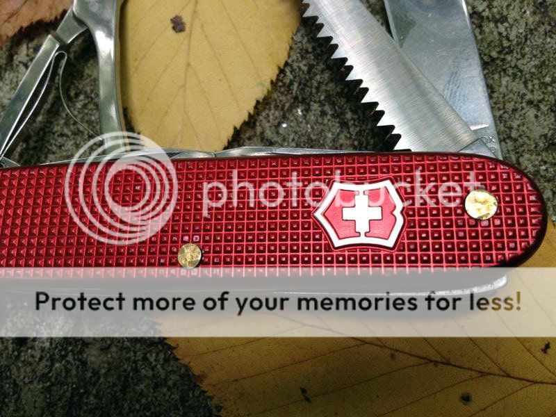

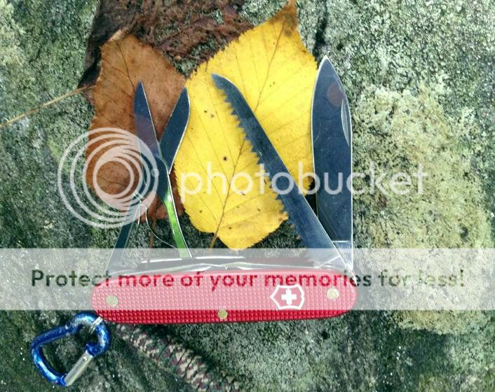

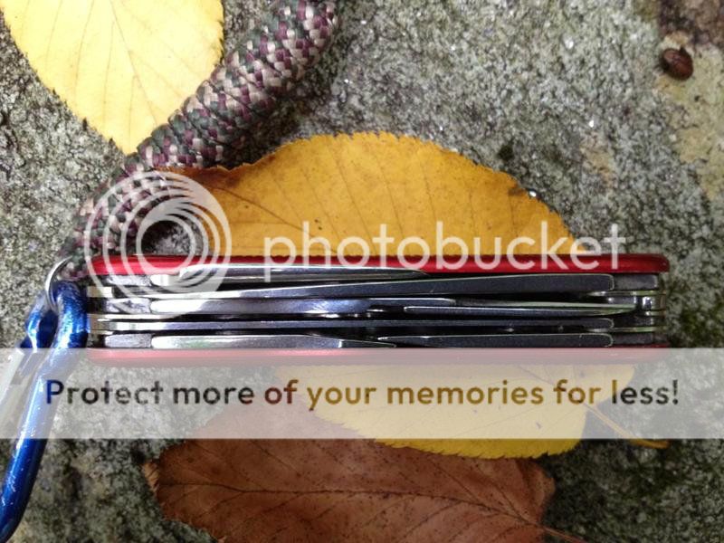

I picked this baby up used on the forums last week and, man, it's soowheat!
I don't know who did the work, but it walks and talks like it was new.
Everything lines up just fine:
Unfortunately the package hook, which is in the same row as the scissors, was not reinstalled:
Nice work peening the pins:
Compared to my trusty Huntsman it's a bit heavier, but it's about the same length and slightly narrower. Also, the Farmer has a more usable position for the awl, and has no unnecessary items.
I'm really liking this knife a lot.  For the foreseeable future, I just don't see my regular Farmer (no scissors) or Huntsman getting out much.
It's my dream SAK. :)

Nice score!  I would never have been able to tell the mod was there unless you told me!

« Reply #4 on: October 08, 2012, 11:41:57 PM »
Good peening job, but I can still see where the hammer missed.  I have the same problem, so I always finish with the side opposite the shield.
I'm gonna try moleskin around the brass, next time.
Looks good, love the red scales!
Warning:  Sometimes it looks like I'm dancing, but it's just that I walked into a spiderweb. - Demetri Martin
  • Posts: 11397
Re: Modified SAK Farmer
« Reply #5 on: October 09, 2012, 12:32:22 AM »
I think you can get cup shaped punches for peening the pins that prevent that kind of damage and leave a smooth domed head on the pins.
