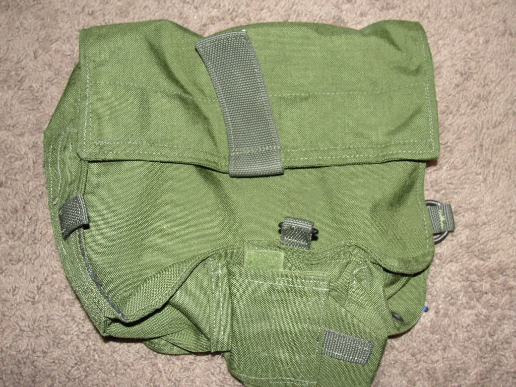

As many of you know, Wilderbeast sells a great Gas Mask Bag.  PW, has made an over the shoulder carry mod: PW's Mod.  I've use this mod and it is great.  But I decided to try a new mod on the gas mask bag.
I cut off all the straps on the pack.

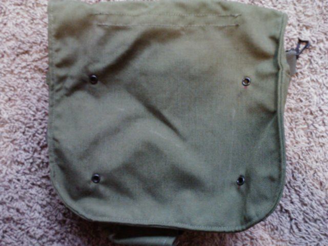

I then punch 4 wholes in the rear side of the bag in the corners.  I then placed a Eyelet Rivet in the holes that I just punched.

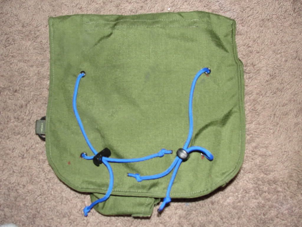

I then inserted para-cord through the top hole and down through the bottom hole.  I did this on each side.  And attached a cord lock to the ends.

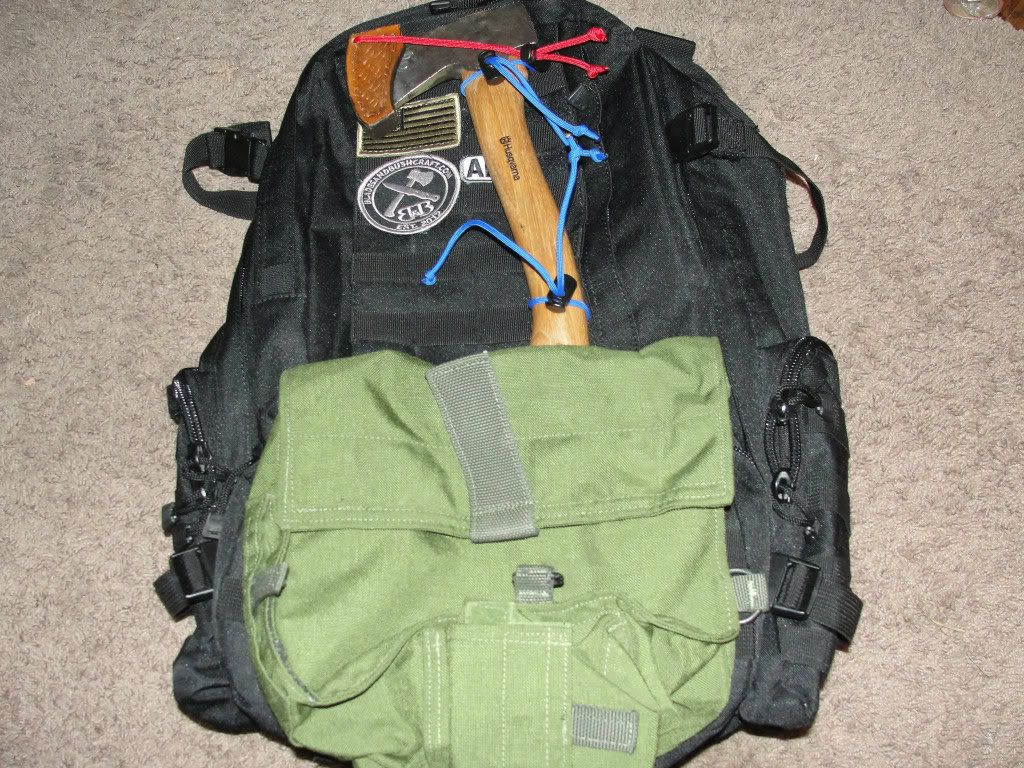

I then was able to use this improvised "MOLLE" through the female "MOLLE" straps on my pack.

cool, can you show us how it is threaded through the MOLLE? you're not removing the cord locks right?
Re: Mod Done to Beast's Gas Mask Bag.
« Reply #3 on: December 10, 2012, 06:36:47 PM »
No, I did remove the cord locks and the knot on the end of the para-cord.  I thread it through and then put the cordlock back on and tied a knot in the end of the cord again.  The knot at the end makes sure that if your cordlock loosens it won't loosen past the knot and fall off.

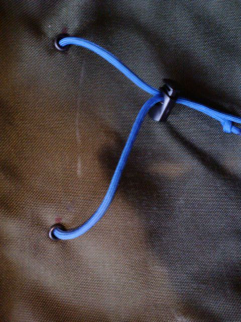

I will post a picture shortly.
« Reply #4 on: December 10, 2012, 06:46:28 PM »
Here is a close up of the pack's para-cord connecting through the MOLLE.
