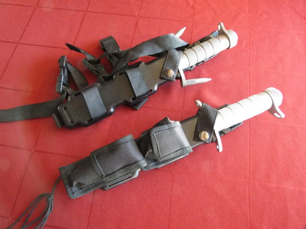

First, here are the two knives in their sheaths. The Buck sheath has "Buck" molded into the bottom.

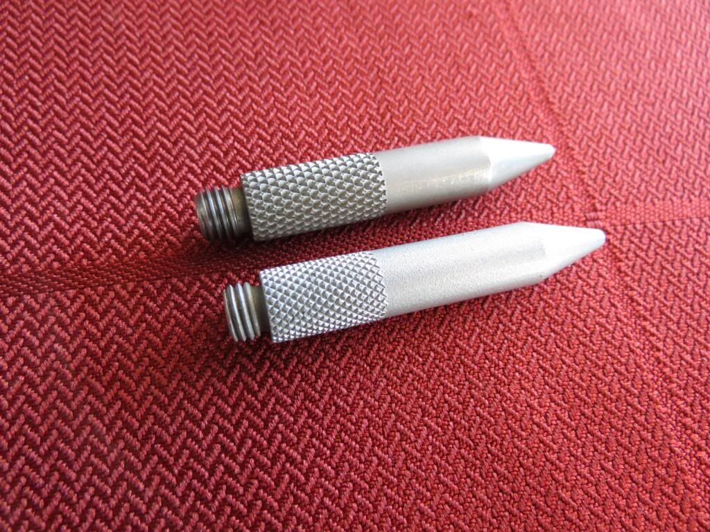

Next, here are the anchor spikes side by side. The real Buck Spike is on top, with the Ramster spike below. The threaded portion of the Ramster spike is shorter, because the hand guard is thinner than the Buck (pic to follow). Also, the Buck is stainless steel with a bead blast finish. The Ramster spike appears to be powder coated "steel" of unknown composition.

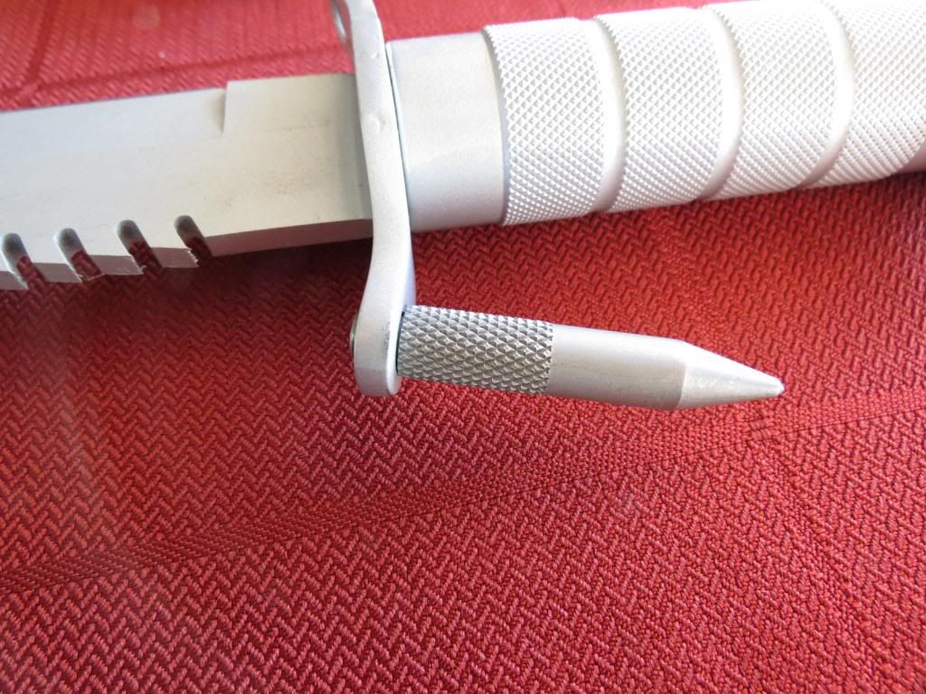

In this picture, I installed the Buck spike in the Ramster knife's guard. You can see some of the threads protruding through the thinner guard. The threads are compatible on the spikes between the two knives. However, the handle end caps are not threaded the same and are not compatible.

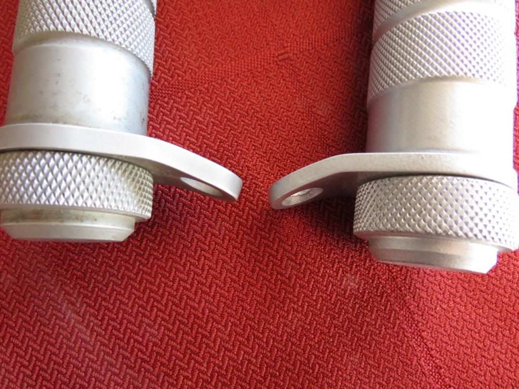

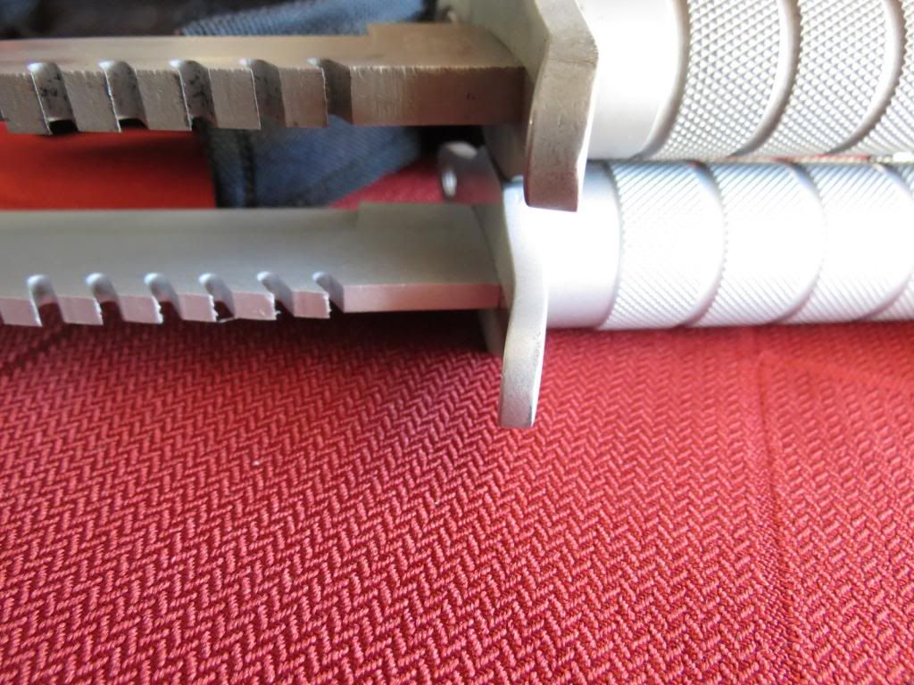

In this picture, with the Buck 184 on top, you can see the difference in thickness of the blade, and the hand guard. The Buck is 1/4", and the Ramster appears to be about 5/32"-3/16" or thereabouts. Still pretty stout, and a reasonable thickness for a blade this size, but not as sturdy as the real deal.

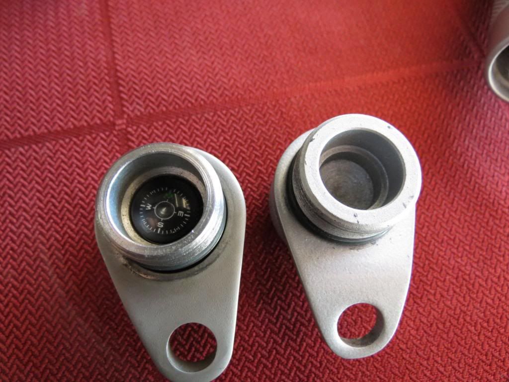

The two end caps, side by side - Buck left, Ramster right. Again the Ramster cuts corners a little with thinner material on the lanyard loop. The handle and end cap on the Buck are bead blasted Stainless steel. The Ramster's handle components are powder coated "steel".

End caps - Buck left, Ramster right. This is an earlier model Buckmaster. Later models stopped using compasses in the end caps and started including a liquid filled Silva compass if my research is correct.

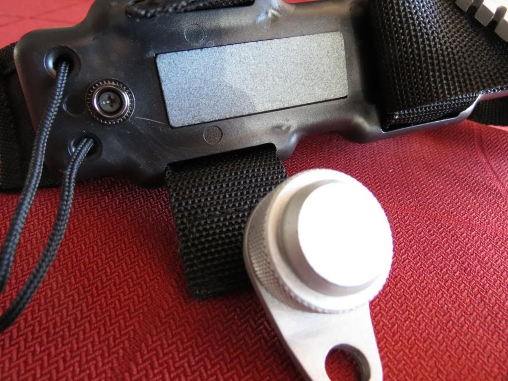

Like the Buck sheath, the Ramster sheath has an included aluminum oxide sharpening stone. Both of them are pretty coarse and not really the best thing for all but the roughest edge reshaping. A better modern improvement would be using a diamond stone here instead.

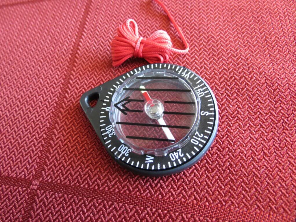

The Ramster compass. This is also a copy of the real Silva compass Buck included with their later model Buckmasters. The real compass would have been liquid filled. This one is not liquid filled. But it does point to magnetic north, so it is a step above a button compass. It would be fine for determining a rough bearing in a pinch, though not ideal as a compass.

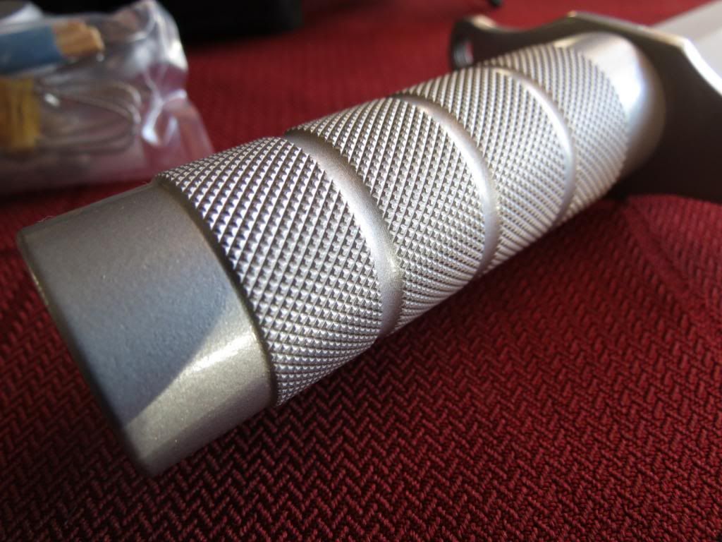

Here is a close up of the powder coat finish on the Ramster handle.

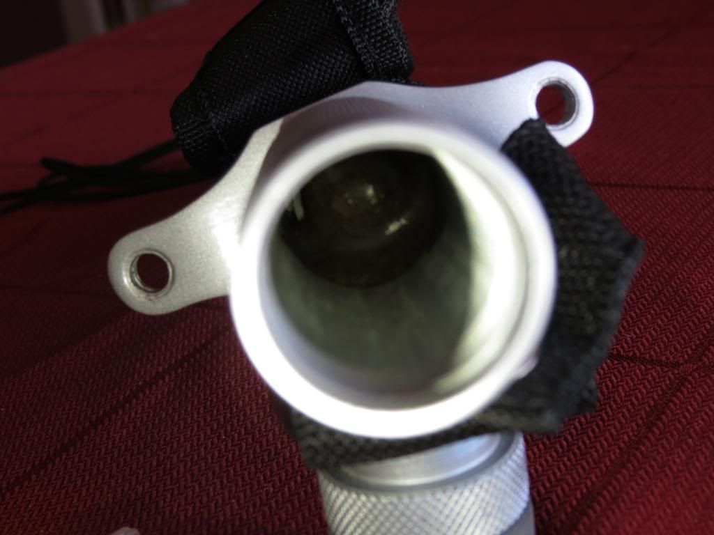

And a look inside. The Buck also has the same epoxy coating on the tang nut, but as you can see in the pic, the Ramster epoxy is not a complete even coat. The Buck version fills the entire front end of the handle, sealing it off and locking the tang nut in place. This knife's tang nut isn't likely going anywhere, but the incomplete coverage also is another reason why it was only $39.04 shipped.

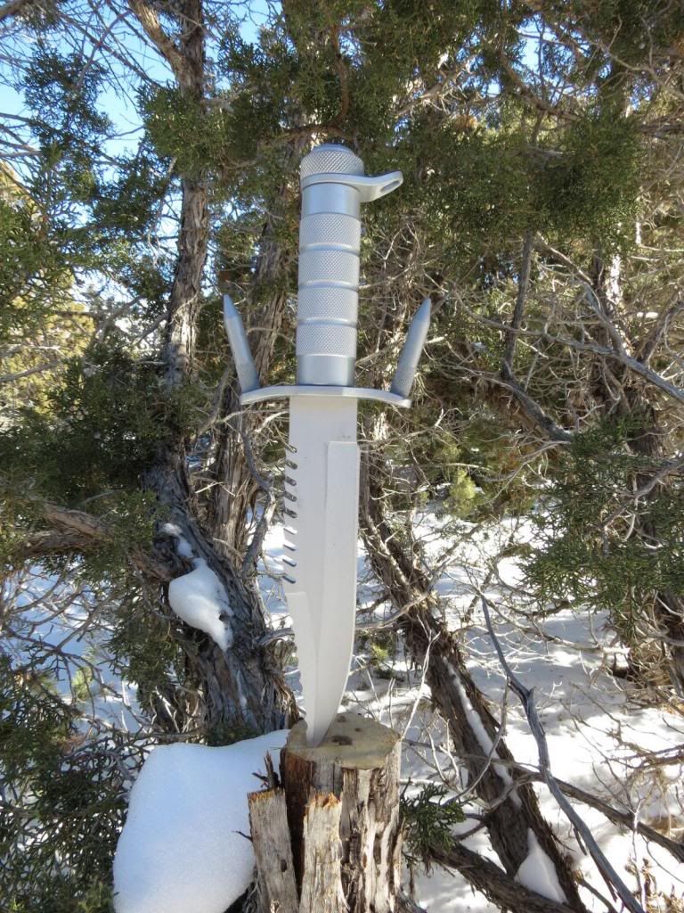

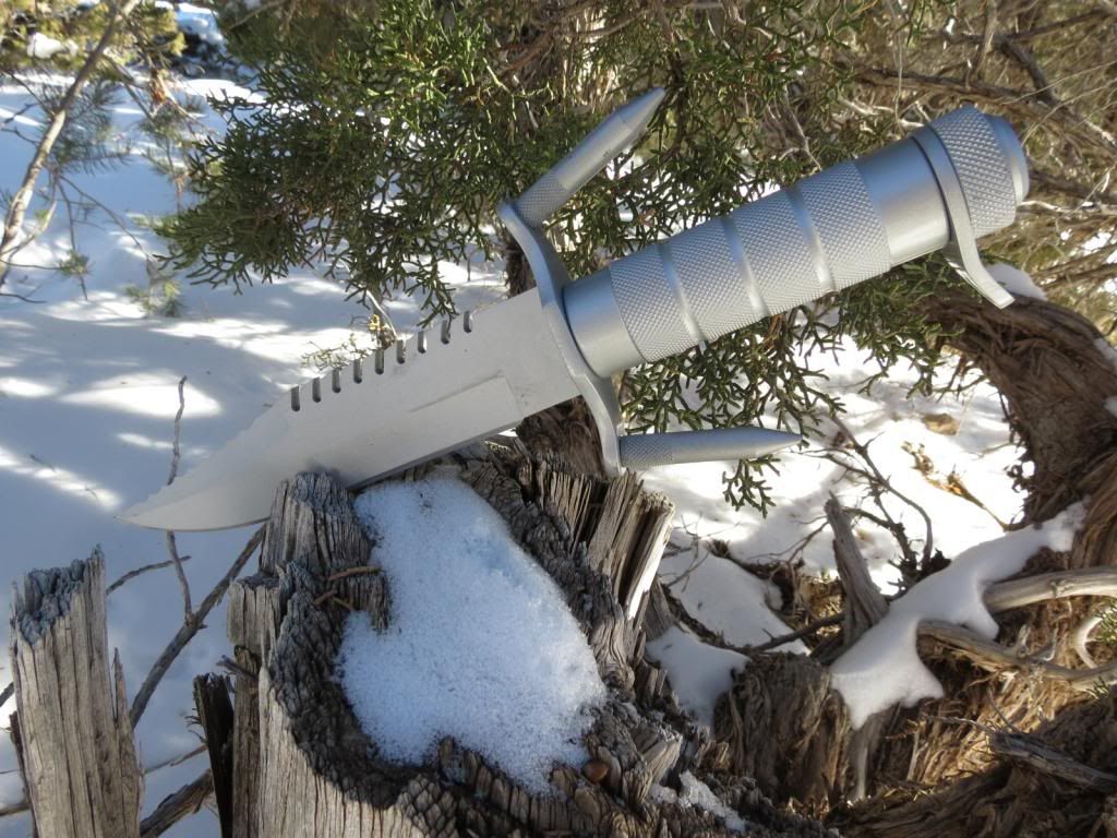

Here are some parting shots...
