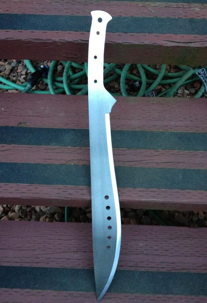

When I saw this machete in the movie (Book of Eli) I just loved it. I never wanted to make bigger "things" than 10" - 12" max., but I had to change my mind.
I made some little changes for my liking, but the basic shape....I had to use. It has a shorter blade. From the beginning of the grind to the tip it is about 17.5".
The first 5-6 inches of the grind is more "flatter" than the original and the drop of the tip is almost half an inch instead of the 1/4". Overall length is 25" with
a 6" handle to accommodate my "giant" hands. Will be comfortable to use it with heavy gloves on. The front of the big pointy "thing" will be more hollow for the pointing finger to put in...like a trigger,
so kind of like choking down a little if needed. I tried that hold...feels good. Also...that point will be great to break things..just a thought.
The blade will be hand rubbed...going to take it as high as I can (grits).
Now  ... what kind of sheath/scabbard you guys would recommend for this "baby" ?
Also .... any comment .. bad or good will be appreciated !

Ironwood is one of my favorites. It will look great on that blade. You are shooting for a spring temper I assume? Anyhow, looks awesome so far, looking forward to seeing the finished machete.

Very cool.  I really liked that movie  lol.  Is that sharp looking point right before your plunge line will you round that a bit more or leave it that pointed/sharp looking?

I think I will leave it sharp looking/pointy and hollow out the front of it a little more, so you can kind of choke it down..placing your pointing finger there. I tried it..it feels good holding it that way.
Also with the point I will be able to break things if necessary LOL

Very, very nice so far!!  I think I'd go with standard Ironwood and a dangler sheath-maybe add 4 square rings so you could lash it to a pack if needed...  Do you plan on using it much or is it more of a wall hanger?  You could add a small stone pouch on the sheath for field maintenance too....
Would Micarta or G10 be a better choice from a flex standpoint?  Just curious.

That thing looks awesome, bendobebaby! I don't know that I've seen a scandi grind on a machete before. What is the usual machete grind?

I made one of these! Mine was WAY too thick though, and as a consequence, the grind wasn't high/thin enough to cut well.
Thankfully the person who bought it from me was a chick who wanted it as a prop for her costume for ComicCon or something like that, lol.
