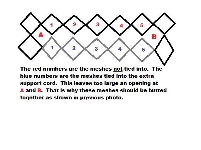

First you must create the slit.  You must te into a substitute for the loops you would regularly tie into as shown below.
The slit you just created has too large a gap so that the first and last loops in each row must be butted together (#s 1 & 10 and 5 & 6).  Go around the opening with a sligltly smaller mesh as shown below.  Tony

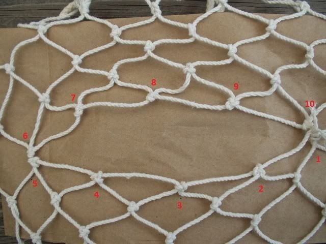

In this picture of the slit the numbered meshes 6-10 are the ones not tied into.  Meshes 5-1 are the meshes tied into the extra pink loop as shown in the drawing above (only 3 loops, sorry).
  The gap between 5 & 6 is extra wide, likewise 5 & 10.  When you go around the opening use a smaller gauge.  When you tie between these end meshes eliminate the gauge and tie the netting knot so that these meshes but together.
