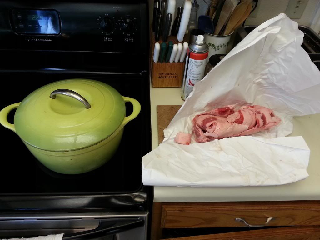

I started doing this when I was getting beef chuck rolls by the case.  Now I have a good local butcher who saves his fat trimmings for me when I need more.
Way easy to do, rendering tallow makes a easy to store and use fat for cooking or whatever.

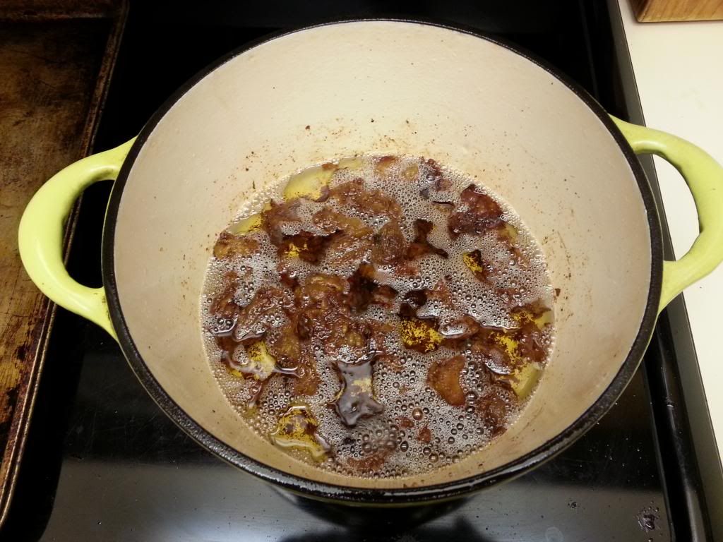

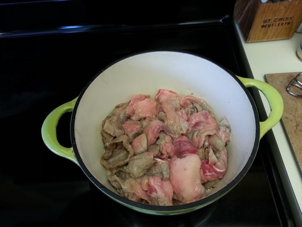

I start with the trimmings and trim out any remaining meat.  Then into an iron pot on medium to medium low for a few hours.  Kinda depends upon your stove.  You dont want it to fry, just start to melt out and bubble off the water.
As it cooks down, I fish out the bigger meat chunks I may have missed.

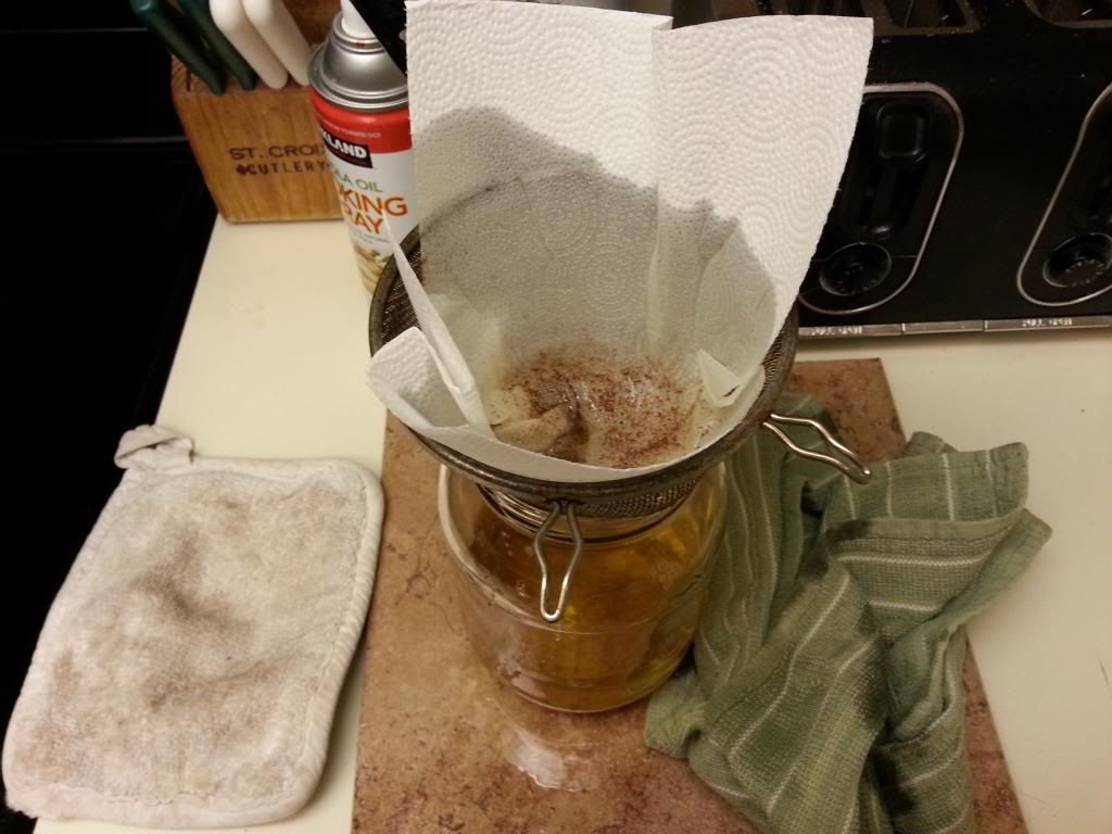

I use a spider strainer to fish out the big chunks once its down to just chunks left.  Then I strain and filter it.

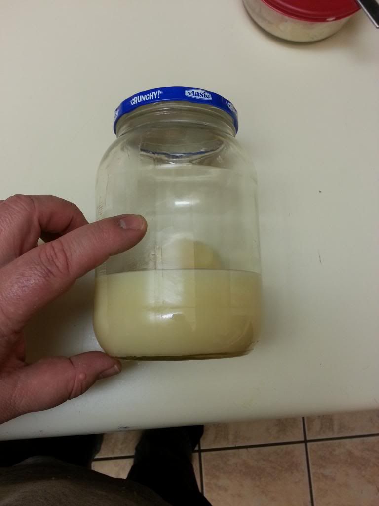

The finished tallow will range in color from yellow to gray or white depending on the breed of cow and diet.  This batch came out yellow and cooled grayish white.  It's pretty shelf stable.  I sterilize my jar first anyway and keep it in the fridge, but I've gotten two years out of one big batch with no problems.
