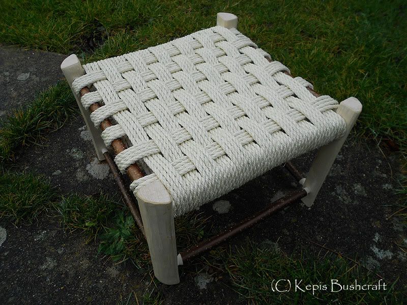

Ive always had a hankering to make a  decent foot stool for the lounge, i don't like these mass produced,  plastic chip filled things you get at "chavmart" and the like, so i made  my own.
The legs are from one piece of  Ash that i cleaved into quarters and then cleaned up on the shave horse  with my small draw knife, the stretchers are Hazel and i thought id  leave the deep bronze bark on as it contrasted so well with the white  Ash wood.

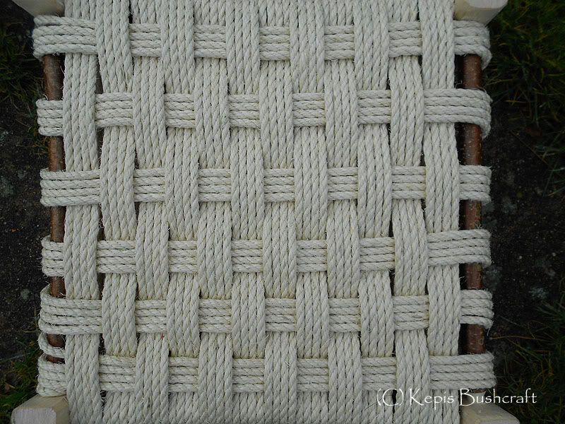

The  seat covering is 6mm sisal rope and I've woven it in a four under, four  over pattern which i think has worked really well, what is deceiving  though is the amount of rope in this, in all there is approx 150ft of  rope in that seat, I'm just glad i bought 300ft of it to begin with.
The  frame is made using tenons and whilst the stretchers are made from  dried wood, the legs are from fresh cut timber, meaning that as the Ash  slowly dries it will grip the hazel stretchers and form superbly tight  joints that wont need glue,

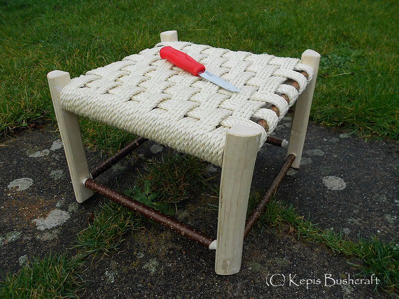

With a Mora 511 for scale
I've made a few mistakes along the way, but  now I've made them i can learn from that and (hopefully) not make them  next time, it's been a pleasurable experience making this all i  need to do is just clean up the legs a bit as the are a bit grubby from the building process, but that wont take long to do.
